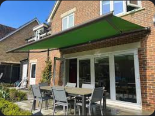

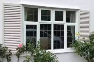

It seems to be don't let the home heat up, rather than cool it down, and French type shutters on windows will likely work, but want them to look aesthetically pleasing, with LED lighting and solar panels one can light the room with lights designed for night use, however it is how to have shutters in UPVC windows which don't look hideous.

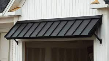

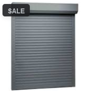

It seems quite clear these 1716892556039.png will never cover the windows, and likely are not even designed to move. And these 1716892690876.pngmay be practical and lend themselves to being motorised, but stop all light and do not really enhance the look of the house. And these 1716892864251.png can hardly be fitted to UPVC.
So this 1716893085280.png seems a little more practical, or a more permanent type like this 1716893218926.png
however they are expensive, so before getting one the first stage is to see what others say about them.

I've said before in previous posts, brise soleil look good and can work well - we had a five floor building equipped with them on the south side and it made a huge difference to the comfort of the rooms during the summer.
I would have loved to install them, but there don't seem to be any DIY solutions on the market.
That seems to leaves the expensive corporate solutions for large buildings, or architect designed houses (...and to work properly, there does need to be some design considerations).
So in the end, I went with a slightly less elegant awning.
Awnings can look good, depending on the style of the house. I had one that lasted over a hundred years (recanvassed once that I know of)
