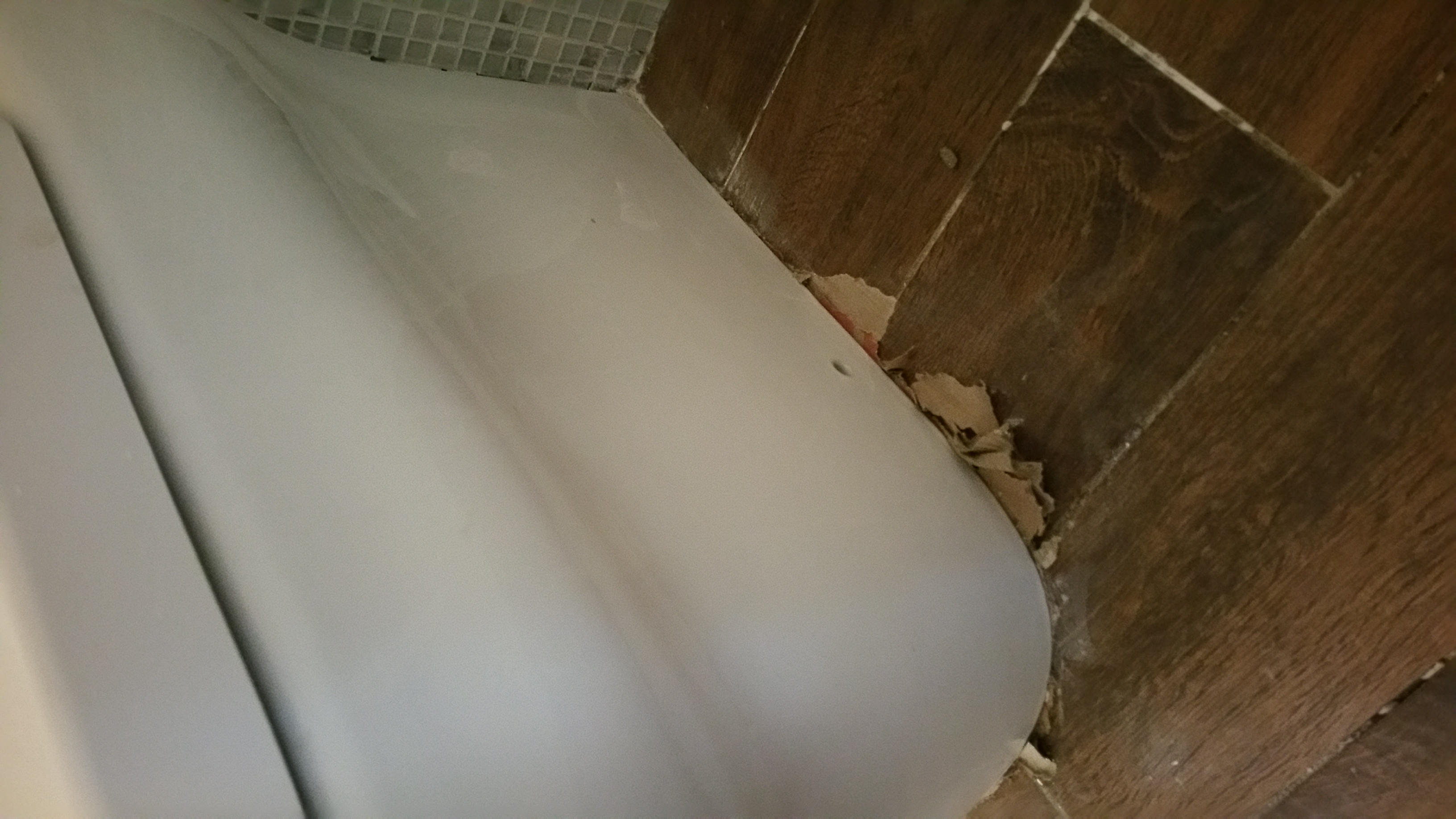

Kichen and Bathroom DISASTER
All the Mitre joints are bad.

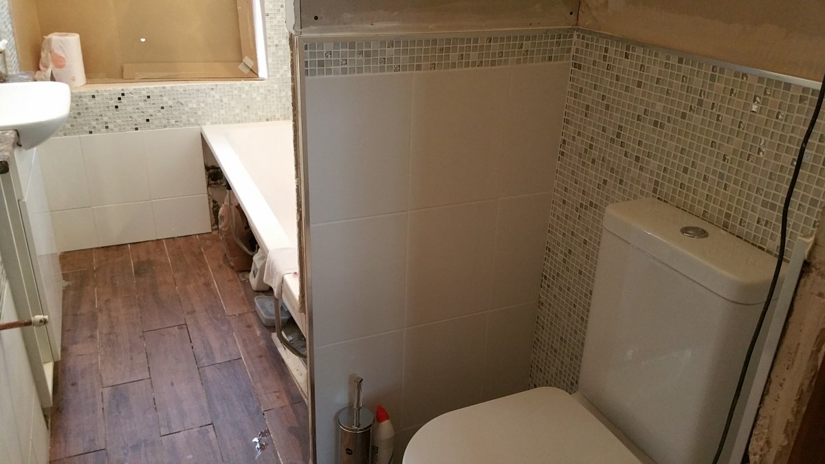

The tiling is not right. It should be half white at bottom with blue masaic on top after row 2.
Note the tiling to side of toilet doesnt match.
The builder has asked for nearly 3k to install the suite ( labour). It was a straight swop.
This didnt include the labour for laying the floor tiles or the tiles on the walls.
Thats another 1200 for the wall tiling and another 500 for the floor tiles.
Thats nearly 5k labour plus I supply the suite and all the tiles.
As you can see its not a huge bathroom.

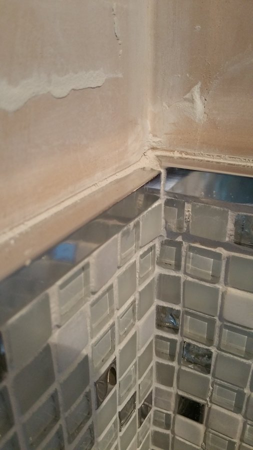

I clearly stated to him i wanted Aqua board for the shower area simply because i had to replace a whole shower cubicle in my last home due to water rotting the plasterboard under the tiles. The tiler who did that job for me said being a new house it should of had Aquaboard anyway and that he was constantly retiling bathrooms and showers where plasterboard had been used.
The builder ignored my request and put up plasterboard and sealed with pva. This seems acceptable in the trade but i specifically asked for Aquaboard.
The toilet has been seated on cardboard.
The shower attachment has already come away from the stud wall.
I think the whole job has been carried out by someone with very poor workmanship and Ive seen better DIY jobs.
I dont mind paying the money if i get a professional job!
