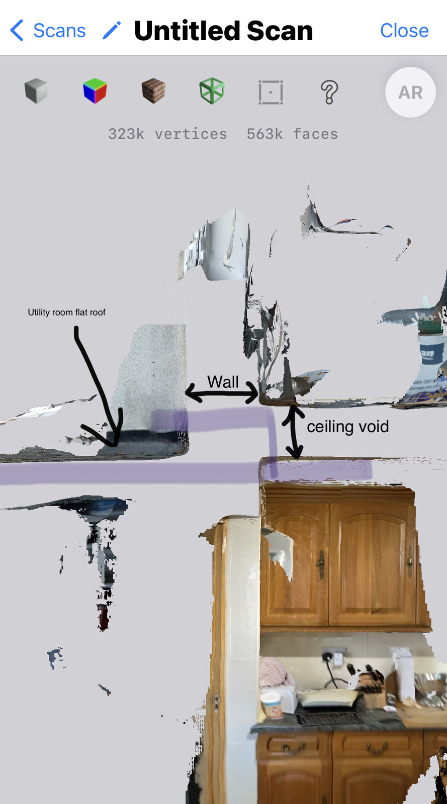

I was looking at PVC ducting, rectangular in the kitchen (as with the current kitchen design I only have 7 cm between top of cabinets and ceiling), possibly rectangular in the utility room and then convert to circular before meeting the external wall, or convert to circular as soon as it enters the utility room
Another route I am considering now is going up into the ceiling void in the kitchen and then straight out horizontally (the ceiling void is higher than the external flat roof); that will dramatically reduce the run length
I have a scheme here, hopefully it’s clear (thanks to my phone’s LiDaR scanner)
I have not been able to make much sense of the scan, but might you be able to mix and match between the two routes? Up into void, then bring it down gradually through the utility room ceiling, then through the wall?
Basically if I go up into the ceiling void above the kitchen and then horizontally through the wall I'm already outside, just above the flat roof of the utility room
(In the picture I've drawn also the other route)
So, is there space to install an out on that wall, without disturbing the flashing of the flat roof - if so, that seems like your best plan.

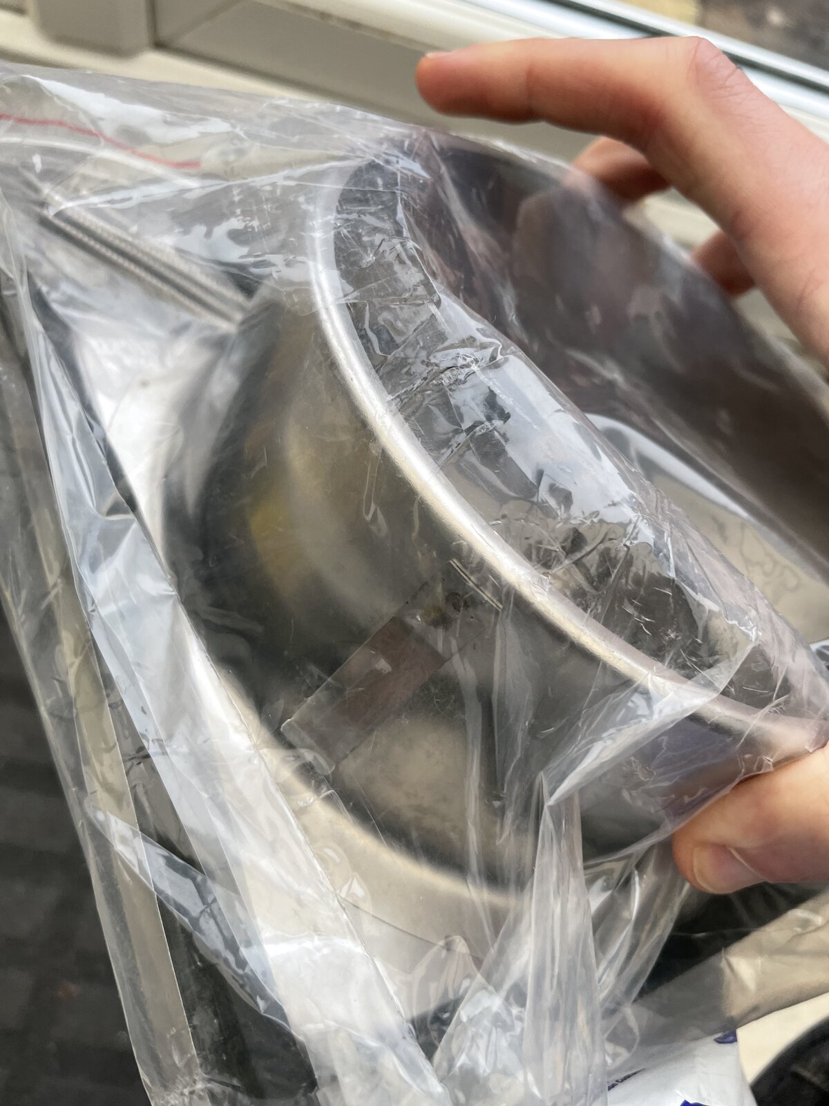

Adding the second picture

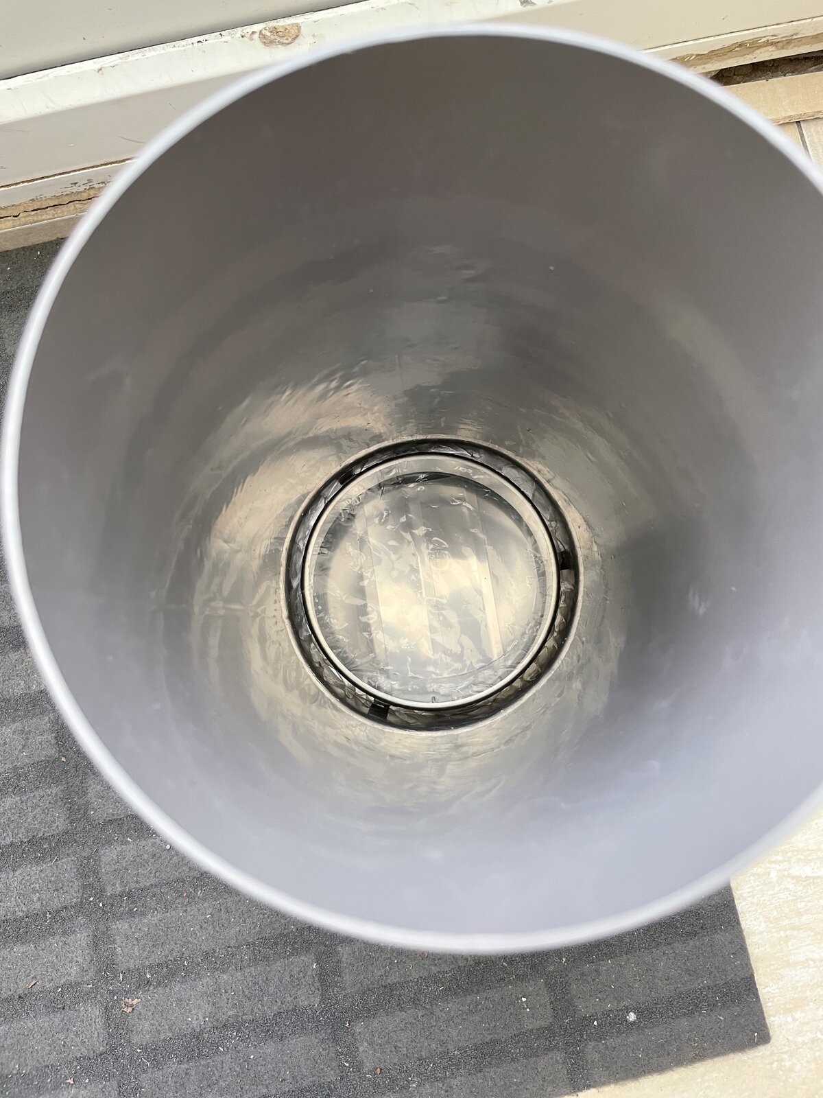

You can get wall outlets to directly fit onto flat rectangular ducting - just not from TS (I thought you were using flat rectangulat ducting). Always best to get the ductwork and the vent from the same manufacturer
I am converting from rectangular to round ducting in the ceiling void as it’s easier to drill a round hole than a rectangular one (the external walls are render on blocks)
You could always just make a collar from closed cell foam, like a Fossa Caulk Saver or similar, then silicone it in place. Even expanding foam (ideally the low expansion stuff) would work. Comprand would also do the job but is a bit pricy for a one off job like this
I guess if I just seal the round section of pipe to the wall with expanding foam, then it doesn’t matter if the pipe and the outlet plate aren’t sealed between them
