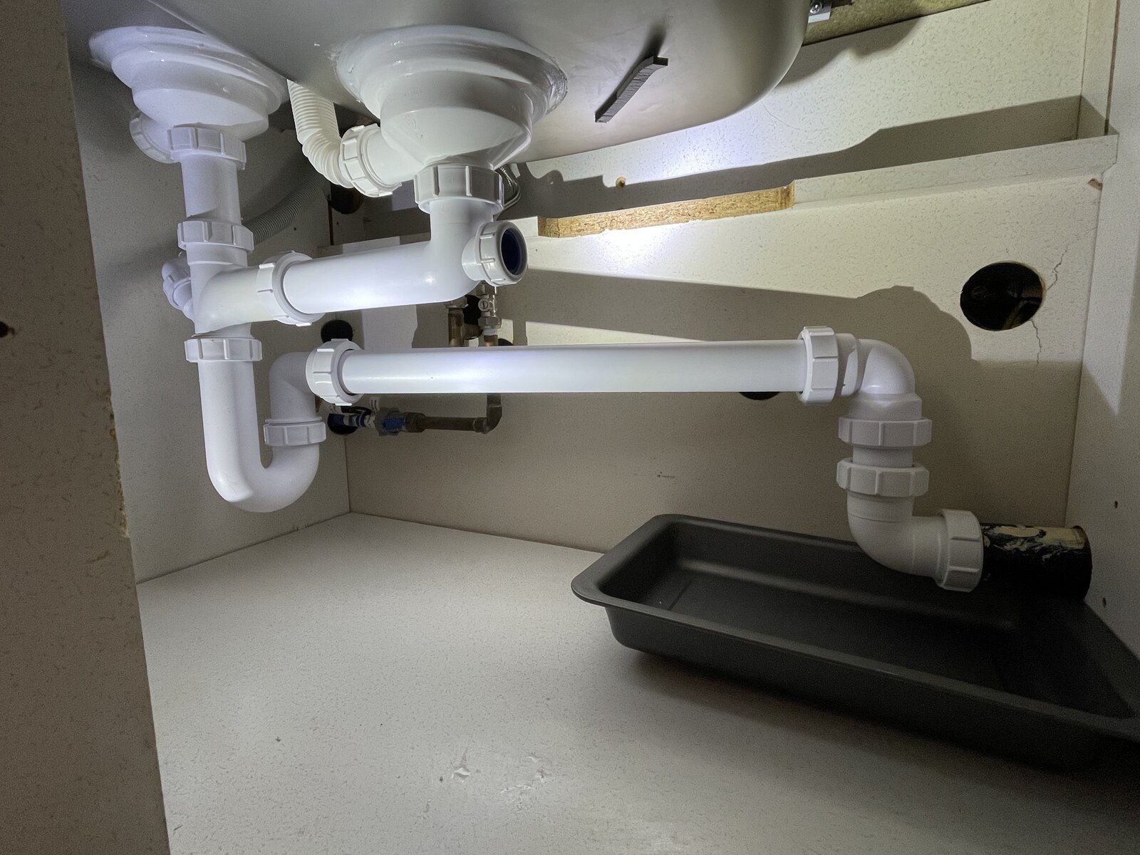

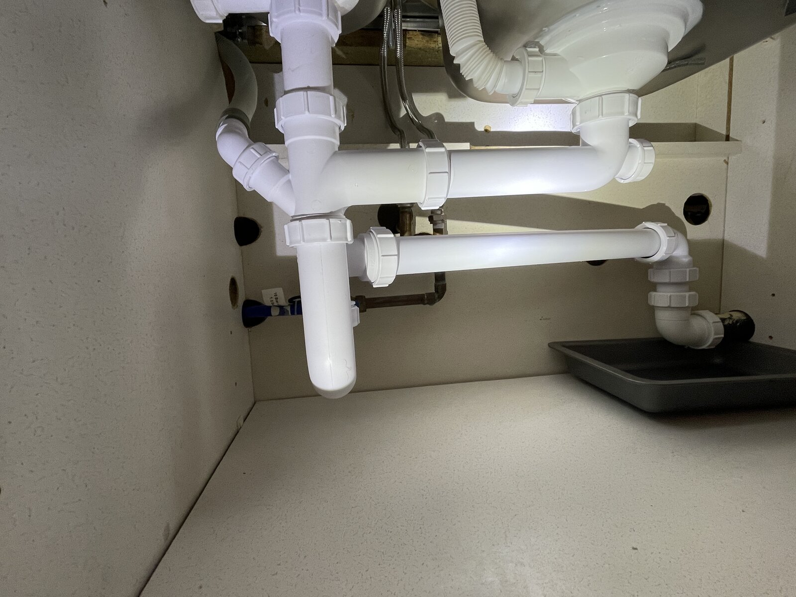

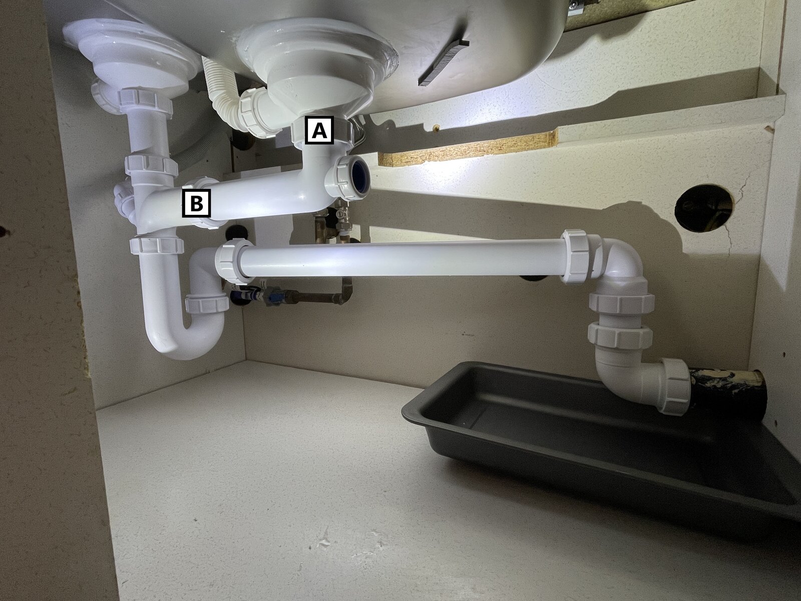

Managed to get around to doing the waste today.
Due to the undersink geography, this is as good as I can get.
and
The metal tray was a "just in case" for potential leaks at the lowest point.
Or, do I need an additional P-trap between A & B in the picture below??
I have a couple of 'bottle traps' that could also potentually be used.
Thoughts folks?
XRD
No need for any more traps. Looks good. Not too clear from the pics, just make sure the long horizontal pipe has a slight fall towards the outlet.
Yep -
Yep - it does. That's why the connecting pipe on the right is soooo short!
Dave
Cracking job @XrayDave ! You'll be giving lessons to plumbers before you know it.
Well done, congratulations and thanks once again for the update/feedback.
Now your cookin !!
Tidy work, seen worse jobs from supposed 'professionals'. Top Marks for that.

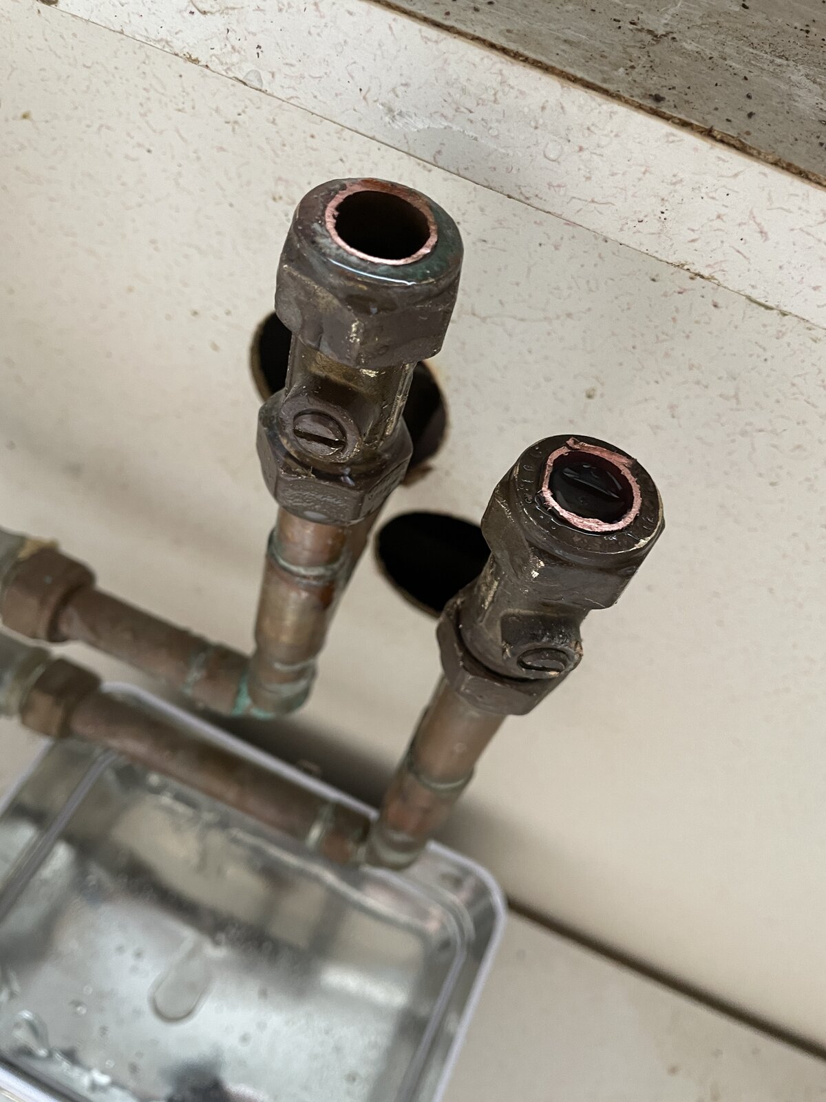

I'm happy to have saved my daughter some $$$ as well - did I say that the plumbers who took the sink out wanted c. £170-180 to fit & plumb the new one in??
Due to the botched job the original "plumbers" did at removing the old sink - sawing the hot & cold pipes off with NO pipework left to re-connect anything (see below) and leaving the waste (bottom right of pictures (see post #1), they have refunded half of the cost - or at least promised to do so (they hadn't managed to do that 24hrs after the conversation), so that's a result.

Oh dear, your daughter was unfortunate in getting workers that obviously didn't give a $hit. happens all the time, they think they are a dark art but a lot more people are better armed to expose these idiots for the horse riders they are.
Great to see you got it sorted and as the others have said, you would put a load of trades that profess to professional to shame with that outcome.
In all honesty, I wouldn't call anyone cutting a pipe off like that a 'Plumber', even in the loosest sense of the word. Butcher and Cowboy are words that do spring to mind though!

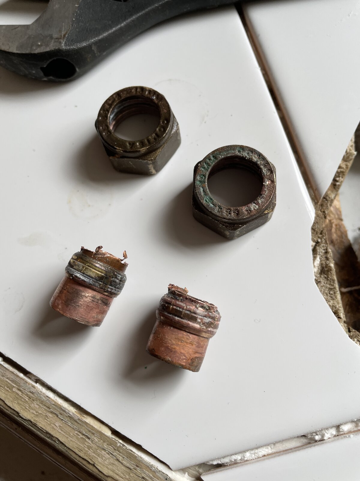

Pointless struggling to hacksaw through 2 pipes, no doubt in an awkward spot, when much easier and simpler to just undo the two compression nuts on the outlet side of the valves, and remove the pipes from there, replacing nuts when finished. Leaves an easy connection for your new pipework, just need a couple of olives to make the joints. :rolleyes:

Well, yes, you'd think wouldn't you?
When I came to loosen the nuts, they were on extremely tight - I said in an earlier post that the guys that fitted them must have had at least 3 Weetabix for breakfast. This would explain why the "Plumbers" went for the easier option of sawing them off I think - too much "bother" otherwise.
I couldn't move either by myself but my daughter (holding some slip-joint pliers over the valve) and me (using a Bahco ajustable spanner) managed to loosen them both between us.
Given that TWO "plumbers" turned up you'd have tought that they'd have managed, but obviously too easy to get a metal-bladed multi-tool and saw them off.
Luckily, I was fitting some flexible pipes to the monobloc tap (as can be seen in the first picture in my original post) - however, when I came to open the cold water valve, we only got a trickle of water so the valve had to be replaced. I managed to shut both the hot and cold water feeds off upstream with some further isolation valves (the access to these is visible on the right of the first picture in post #14 this thread), luckily the nuts on the feed side were a little bit easier to loosen.
So, given that the cold water isolation valve had failed, I replaced both hot & cold with new.

Overtightened compression joints on sinks, I was always told were the work of Kitchen Fitters.
Having seen a lot of their 'Plumbing' since, I can now see why....
With the right tools (for the worst a pair of vice grips and a large adjustable) then there isn't a compression joint that shouldn't be able to be moved. If the guys that arrived don't have the right tools then they'll never be up to the task and by the sounds of it, then the closest the guys that arrived have been to a plumber, is slept with one.
