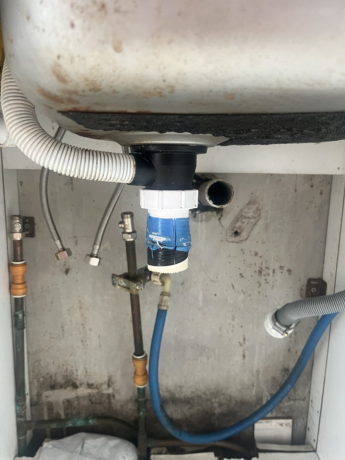

Hi all, I got around to trying to replace a family members sink/waste/trap setup today. Only to realise it seems a much bigger job than I'd originally imagined. I don't think leaking can be stopped (over time) with the waste being so high?
It's been like this for 10 years. I imagine they've added the tape thinking it's old fatigued plastic pipe joins, not realising it's leaking because the water level will be constantly above the waste pipe level within the trap setup, and over time that'll inevitably start leaking?
I don't want to re-do what's there at present at it all start leaking not long down the line, am I correct in thinking that?
Here's an image of where the waste exits outside:
What would be the best approach to take it this situation? I told them I'd have it sorted today, but didn't know what I was getting myself into :D
If I needed to drop the waste, how big of a job is doing something like that?
Fit a decent 1 1/2 Bowl waste Kit, i.e. McAlpine, and see where the outlet of that comes in relation to the existing waste pipe. If it's still too low to couple onto it, bite the bullet and core another hole through the wall, I cant see as changing the sink is going to alter much.

Core drill lower down on the wall. Do it once do it properly...

The half sink pipe can be reduced to nearly nothing, so the whole lot would be a reasonable amount higher.
What’s under the black tape - is that an adjustable section? If so, just move the lot upwards. Better still, buy a new 1.5 sink adjustable fitting kit.
Difficult to see by pic1 but if the wall outflow is lower than the horizontal run of any of the sink waste kits then regardless of how high you can take the kit then the trap outflow will always be lower, therefore the run out through the wall will have to be lowered.

You will need this trap to sort the ugly mess and core the wall with 40mm core too at a lower point.

Also, can I ask, in your earlier comment, did you mean if the wall outflow is higher than any horizontal run of the sink waste, then the outflow needs lowering? I think that's what you meant. Here's another picture taken at level height, think it shows it's going to be very difficult to get the horizontal runs of the sink waste higher than the current waste outflow.

That waste outlet is much too high....do the job right now while you can. You will save money and headache in the future..

In terms of drilling the core, should I fit the new sink and trap first, find out where the hole needs to be and then drill it. I don't need to take into consideration any fall angle for the waste outflow?
Yes - as you can see from the pic the waste outflow is almost at the same height as the bottom of the sink waste - no way any correct waste trap set up would reach that if it is to work correctly. That was the failing of the last one - the homemade u bend and then a pipe that travelled up too high, which meant that the whole sink waste pipework would have been full of water all the time, right up to the level of that wall outflow and probably why it leaked everywhere, by the looks of it and the tape etc.
