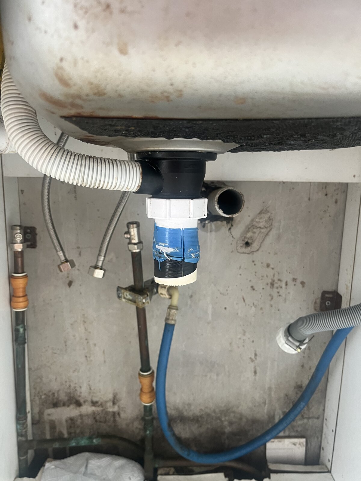

In terms of drilling the core, should I fit the new sink and trap first, find out where the hole needs to be and then drill it. I don't need to take into consideration any fall angle for the waste outflow?
Doesn't matter if you go a bit lower down, a couple of bends will soon drop the waste pipe from the trap outlet to the right level for going through the wall. I personally prefer to come through the wall lower down, it helps hide some of the pipework in the back of the cupboard, and means less visible outside.
There are ways but it would make a better sound job just to lower it.

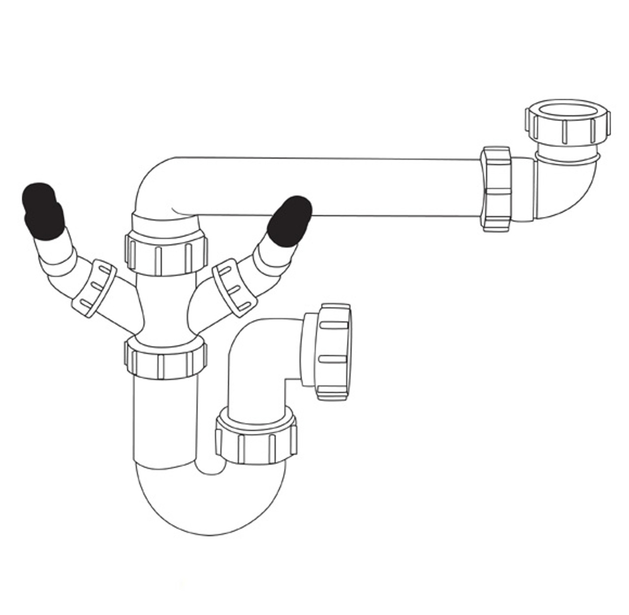

We went with a cheap single bowl replacement sink (https://www.tapsuk.com/caple-crane-965-1-0-bowl-satin-stainless-steel-kitchen-sink-cr101ss-p28342), it needed to be 965mm x 510mm. It comes with it's own trap kit:
But if this isn't suitable I'll use the McAlpine 1.5 trap kit (that's already arrived) and blank off the .5 feed

Is it really too high? Looks to me like someone's just made a "homemade" trap from some random fittings. Looks plenty of room below the wastes to fit a proper trap higher up rather than bashing holes through the wall.
In the image I took above, the waste pipe is as high as the first part of the trap. It was my understanding that if this is the case, the trap would be constantly full for the water to reach the waste outlet?
The waste is undoubtably too high to be effective. The sink will drain slowly, any additional wastes entering the system, will also cause the sink to backfill.
