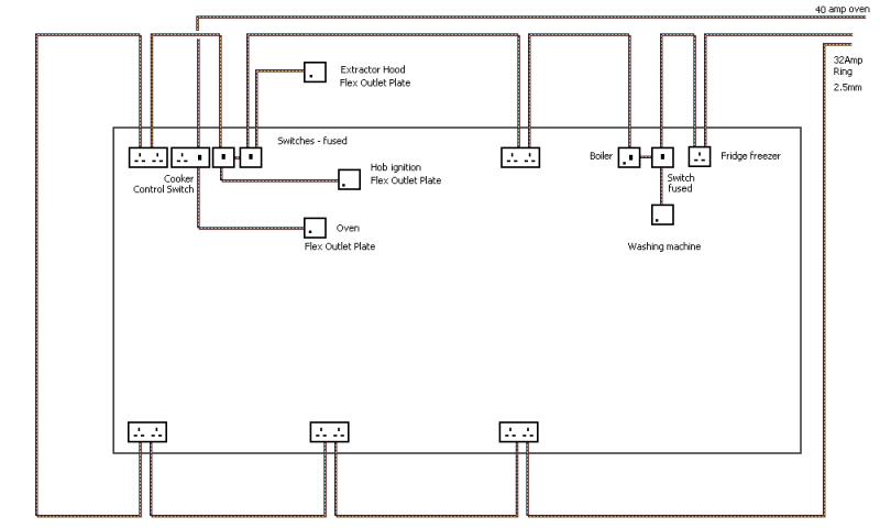

This is my first post, the existing wiring to my kitchen is a disaster and possibly dangerous, as i am fitting a new kitchen soon anyway I intend to upgrade/replace the wiring.
I am hoping that you would have a look at my wiring plan and come up with suggestions/ideas about it, so I don't look a complete idiot in front of the BCO!
Any help is appreciated.
I have called building control and intend to start work proper in may.

Hmm, I'd say you have not got enough sockets there.
Its a kitchen, you'll need all the sockets you can muster.
The blender, the electric can opener, the microwave, the kettle, the fridge/freezer, the ...so on :D
if at all possible put the fridge/freezer on it own MCB. if something trips the power in the kitchen then your fridge/freezer wont be affected.
I was fitting more sockets than that back in the 70s as well as on its own ring.
i might be inclined to take the boiler onto its own rcbo (maybe just an mcb if the wiring method would permit it)
this would prevent any appliance tripping during the night and the first you knew about it would (possibly) be a cold house with no hot water. Unpleasant on a cold winter morning
As mentioned above, i would opt for more sockets then you think is really necessary. We also charge our phones in the kitchen, so theres another double outlet in daily use.
Are you aware of the requirements regarding RCD protection for buried cables and socket outlets? Is your bonding up to scratch?
Apologies in advance if you are aware but these are things that are often overlooked by DIYers.
