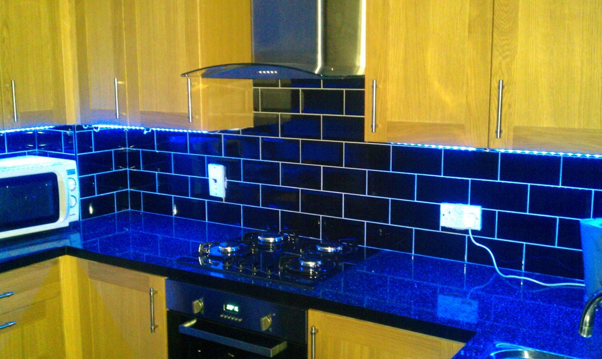

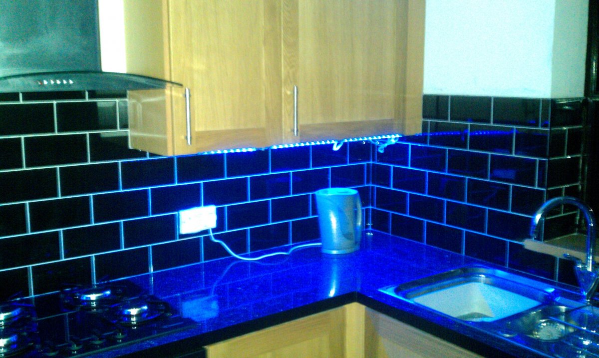

Not a kitchen fitter by any means but bought mine from magnet, fitted it myself and had no problems or anything missing, bonus was they're local just in case
