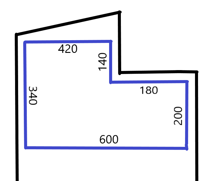

Hi folks,
I'm just about to build my first very own shed. First I wanted to buy something already built, sit it on top of paving slabs and call it a day. However I live in a very windy part of Scotland at the top of a hill which doesn't help the matter. I would like to build a shed that will last at least 20 years. The plan is to use either 2x3's or 2x4's and 11mm osb on both sides with waterproof membrane on the outside and some 100mm insulation between the boards. There are 2 parts of the idea I struggle with and that is roof and the base. I have already acquired roughly 25 sqm worth of paving slabs which are around 3cm thick free of charge. The problem with soil is that it tends to soak up water and get very soggy - sometimes to the point where your feet leave an imprint in the sod. Furthermore, this is Scotland - it rains all year round. How do i avoid moisture entering my shed? Also the ground is a bit slanted, from one edge to the other there is about 15cm difference in height.
I have made a rough sketch that is attached to this post outlining shape of my plot (marked in black) and shape of my planned shed (marked in blue).
That's where the second problems presents itself - in order not to lose 6sqm worth of a shed I need to build it in a L shape. Walls seem pretty straightforward however I have no idea how to make a pitched roof shaped like that. Any guidance would be amazing.
I would like Eaves to be at around 2 metres and no part of the shed can be higher than 2.5 metres within a metre from the property boundary.
In total, I'm planning to store around 2 tonnes worth of items within that shed so it should really be quite solid.
If it comes to my skills - I feel quite competent in DIY within the house - I laid tiles, remodeled bathroom and the kitchen, laid carpets. I didn't do much work on the outside though. I have a decent set of tools but I'm no builder - my daily occupation is being a nurse :D
Any comments, ideas, anything - greatly appreciated.

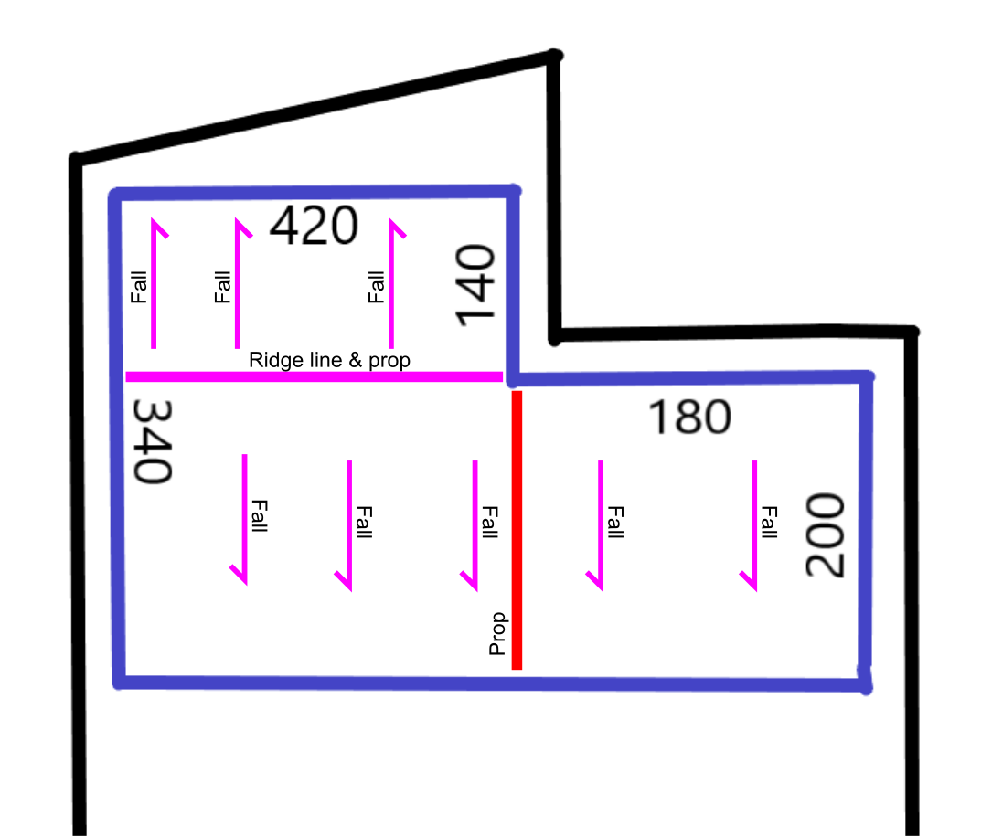

So with respect - competent DIYing isn't going to help. Your problem isn't the roof question, which is only symbolic of your true problem.
Your true problem is the 6m length of wall. The 3.4m length too probably. The shed is going up a hill in Scotland. Has it ever gusted to 100mph? You can look that up. Probably has. An un-braced DIY OSB wall is simply going to be blown over or sucked off (wind sucks as well as blows). The obvious solution is to make the 1.4m wall structural, either cross braced or utilising diaphragm action of the OSB sheets. Then prop from it to the (approx) 6m mid point. Similarly prop from a structural 1.8m wall. Note: diaphragm action is cleverer and more efficient, but still not a common form as it's harder to design/build. It means there's no frame (no chassis) and if you then mess with the OSB you'll weaken the structural integrity. Like cutting holes in a monocoque. As in windows and doors especially.
The 2T of 'stuff' doesn't really help unless you can design/guarantee it's contribution to the sideways stability. And keeping the roof on. Further, the 2T is actually categorised as live load, which means it can be removed and thus contributes nothing to the shed's stability. You mustn't design this on that basis unless the 2T is absolutely un-removable - as in a huge pile of solid concrete. The shed must be safe (to others) as well as funky looking. Err, if the ground is so wet, what's to stop the 2T going through the floor?
Then there's snow loading. Does it snow on hills in Scotland? Snow's heavy, and it can simultaneously gust real hard whilst there's an existing snow load on the roof. That's makes the loads combine, but translates to even more wood for the build.
It's all tricky and I'm overly conservative, but. I would view it as quite ambitious to DIY a 6m x 3.4m open space made of wood on a Scottish hillside and expect a 20 year service life. Sorry. But see my sketch of your sketch... shed.png

I only suggested that ridge arrangement as it keeps the roof spans the shortest. If height is a problem, you could rotate the ridge through 90 degrees so that the falls went at right angles to how I drew them. That means though that the roof structure would have to be 4.4 times as strong, or 2.2 times deeper.

Could you tell me whether I understand that correctly, If we were to turn the ridge by 90 degrees, roof ridge would sit at three meter point on a 6m wall and 1.2 meter from the wall you were thinking of bracing? Also, could you provide some more details about the membrane action?
