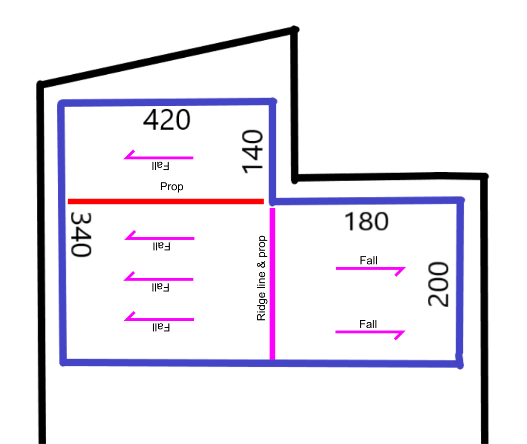

L-shaped shed - is it possible?
It's a shed and you can make your own decisions, but the standard safety factor for live (removable) load is 1.6. So you actually have to cater for at least 3200 kg. That's one and a half Defender 90s. Plus you'll probably use engine hoists, trolleys or jacks? Those things create punching shear that would just pop straight through a suspended ply sheet. It would be dangerous. The freezer sounds heavy too, especially it's (4?) feet.
Wind aside, I think that you're looking at a substantial concrete floor. Probably >= 100 mm thick with mesh reinforcement and a DPC. Perhaps float finished /screeded if you want it smooth. Any chance it could be ready mixed off a truck? Otherwise that's ~1 m^3 of concrete to mix and it's nice to have it all poured in one go, but not absolutely necessary.
The ground slopes and is soft. That'll have to go (offsite?) and be replaced with compacted Type 1 fill, digging down till you hit firm ground. Dig a test hole outside of the shed's footprint and investigate the ground. This is one of the most important aspects of successful outside construction.
You're really talking about a garage floor.

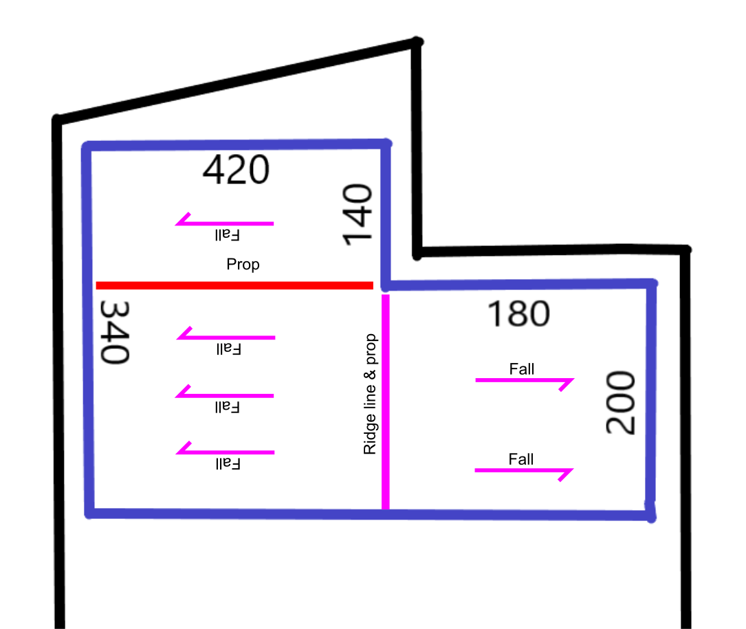

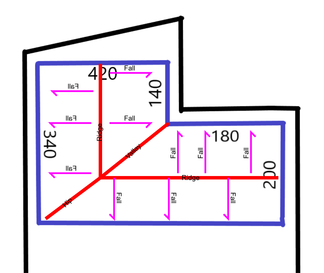

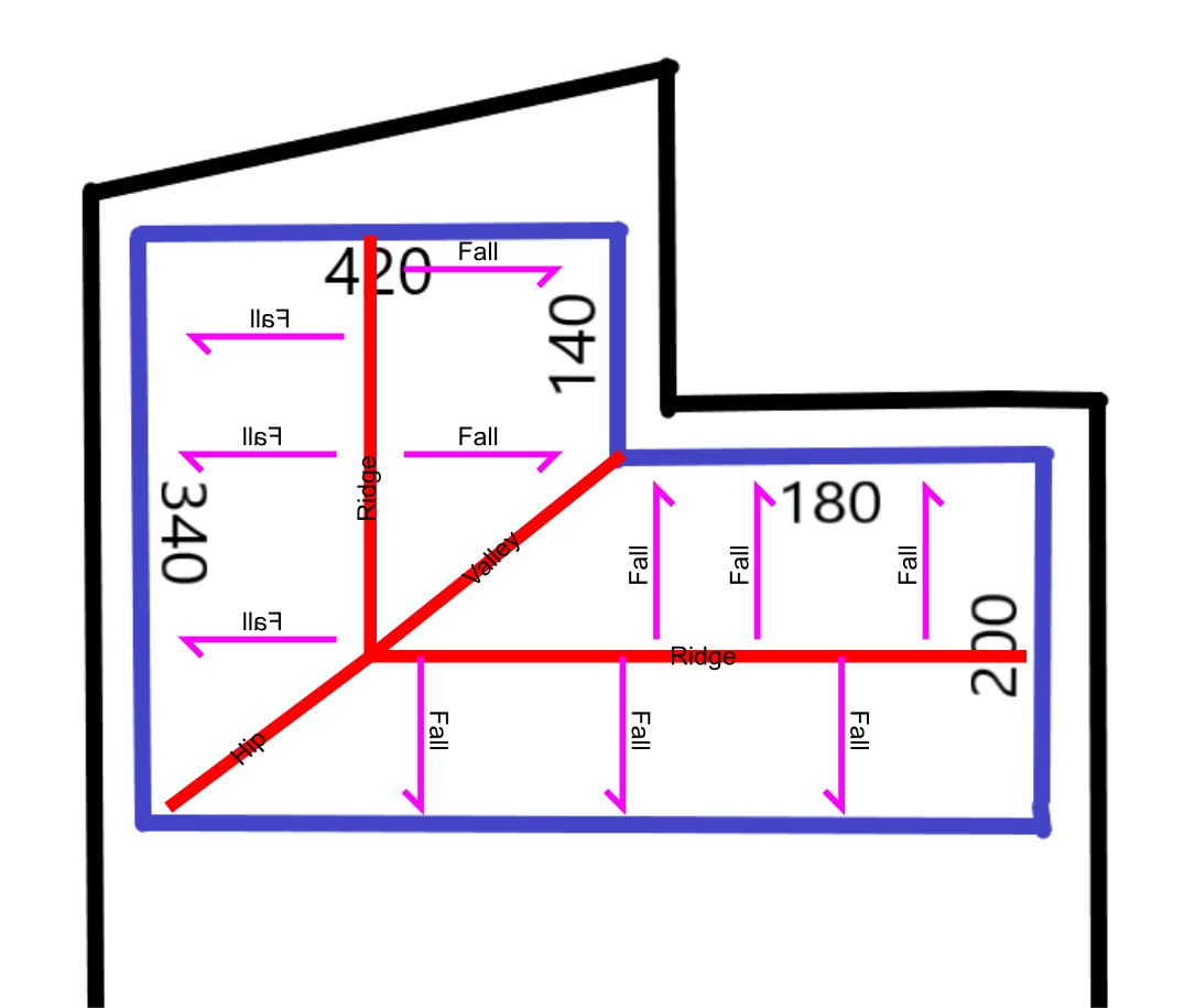

Rotated roofline - shed.png but now with a much longer pitch hence more wood. Small 2000 long steel beam possibility?
Or, getting a little elaborate in trying to lower the roofline - shed2.png . Not recommended if at all possible.
But now a tip. Redraw your sketch to scale. It's quite confusing to have walls 420 and 200 almost the same length :confused:

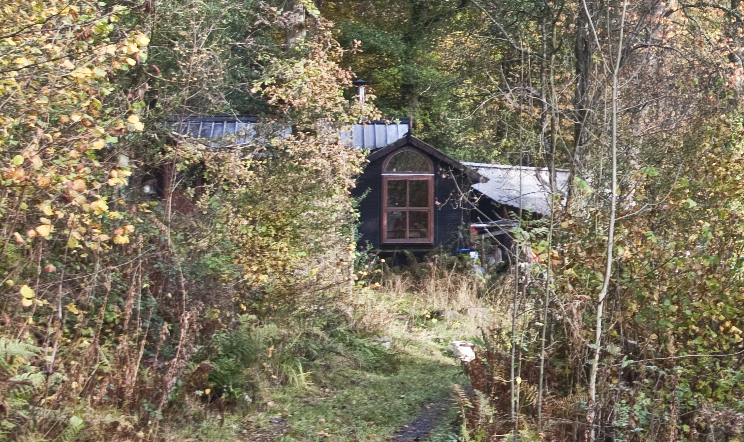

I have sat in this "Shed" IMGP8349.jpg drinking coffee and watching the rabbit go by in the foxes mouth, it was on about 4 levels and was a really odd shape, and the woodland owner lived in it full time. The wood burning stove keep it really warm and the trees may have protected it from wind, but one did fall on the structure and squashed one of the bedrooms, which had a tarp on it for years after.
It seems the council wanted to charge the guy for every "shed" he had, so he moved them all and joined them together, so then he only had one charge, oddly the stone build cottage in the 20 acres of woodland had no council tax, how I don't know.
What you can and can't do it seems is down to who knows what you have done. There are so many rules and regulations no one can keep up, in the end he had to move out, as home help could not really look after him there.
The track was not too steep, but would not stand the weight of an ambulance, and a SSSI woodland so could not enlarge the track.

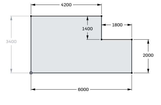

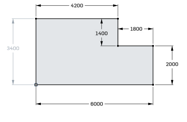

Your current footprint actually looks like this:
Given the irregularity of the ground, there's a fair chance that the 1800 x 2000 section will crack off, especially with such a thin slab. You might want to consider a movement joint along the line extending wall 1400. No biggie and it helps to reduce the pour.
