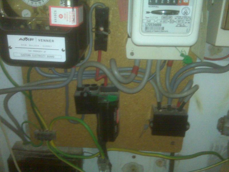

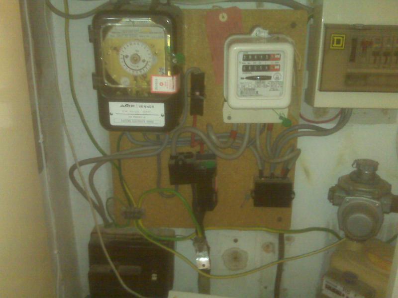

called supplier, they said they dont do it have to call an electrician.
ok here it is.. i am quite happy to pull fuse myself... assume there is not much to it.. break seal and pull.. surely it cannot be that simple??
what would a qualified spark do differently?
again thanks for support..

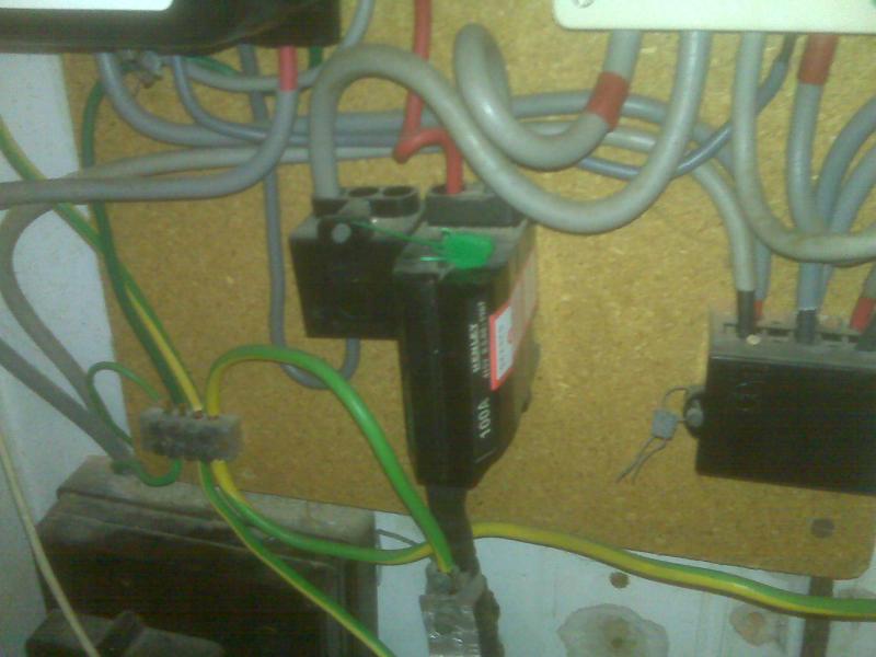

Officially only the DNO / supplier is supposed to pull the fuse. Ultimately it is just a matter of switching off the load, then cutting the seal and pulling it, and if it's in good condition, that will be fine (the guy who fitted my isolator just did that, no special precautions taken or whatever).
The tricky bit is being able to recognise when one is in good condition, or when one is likely to disintegrate in your hands - if you post a pic of your service head, people here are likely to be able to tell you what sort of condition it's in...
If it's got a risk of disintegrating, then don't touch it yourself. Someone from the DNO might do it wearing a pair of insulated gauntlets or similar, but they have training (and insurance!) to be able to do it.
Good question - I don't really know. You can get ones with quite extreme ratings in terms of voltage, and obviously you get welding gauntlets that are designed to stop people getting zapped by arc welders, so I'd assume as long as you get one appropriately rated it will do the job...
ok so arcing is a problem aswell.. what do all you sparks do then carry gaunlets and face shields when you whip out a fuse?
heres my pics.
I think that for a LV cutout I'd be happier with kneeling/standing on an insulator and wearing dry welding gauntlets....
Fortunately my meter now has a built-in isolator, so I don't have to face that problem....
thanks BAS. what about the possibility or arcing when the fuse is removed. Someone mentioned that its possible another fuse could be furher up the line?
