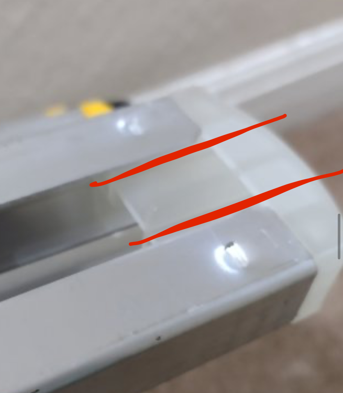

You see those two dents in the aluminium? A machine in the factory has pressed those in to the extent that it has created metal "fingers" that hold the white plastic bung in via a ridge in the plastic. The other (yellow and black) feet are retained in the same way, I.e. it's a bit more of a permanent attachment
Before I recommend breaking, bending or drilling anything, please show a picture of the stabiliser foot with a good close up of where it attaches, from several angles, in order that an assessment as to how it is to be fixed can be made...
ps; your phone seems to do a good job of focusing on the wrong thing; the relevant parts of the picture are always blurry and something else further away is in focus. For subsequent pictures please hold the phone a little further away and (probably) tap on the part of the screen you want it to focus on
It would be better to get a clear photo for further away and zoom it after, than hold the phone so close it can't focus and blurs out the helpful detail

Indeed, it looks like a slight manufacturing oversight; the pressed metal fingers do too good of a job of retaining the plastic bungs
Several options though given that it looks like they aren't part of the subsequent retaining mechanism for the stay-bar
Probably the simplest and least alarming for you would be to get a wood saw out and cut the bung down the channel along these two lines:
The middle bit of big will drop out and the sides can be pried, twisted, levered, broken or even just cut off at the curved end and left in place
Or, you can use a drill in the indentation clear away the aluminium and form a hole that removes the retaining finger
Or you can look to bend the aluminium up a bit moving the metal finger away from the bung
changes to the metal of the ladder in this location will have no effect on its overall structural integrity because the point where the weight of the ladder and user bears onto the stay bar is above these points

I decided to get my soldering iron and burn through the plastic like a hot knife through butter. I then hammered away at the plastic until it came off. Thank you for your advice.
