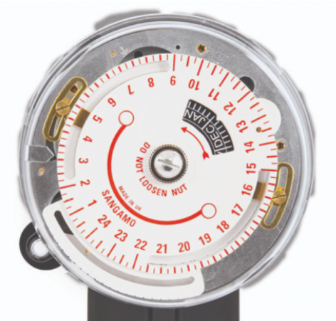

I'm sure they used to have timers, similar to the old Sangamo ones like this

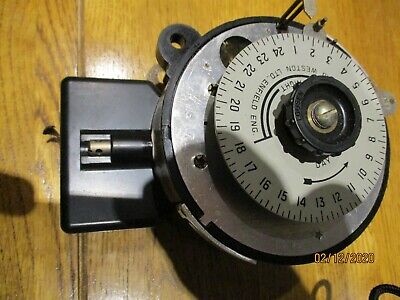

The first electric streetlights were switched by hand - the former gaslighters did it.
Next came the solar dial time clock
These are quite clever mechanical time switches which had the ability to automatically change the switch ON & switch OFF times to match the changing times of sunrise & sunset. Some of these also had a spring reserve that would carry the timer through power cuts.

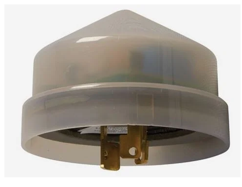

Around the late 1970s came the first photo-electric switches - these would turn the lamp on & off automatically depending upon the daylight level. Various generations of these existed, some of which included a midnight off option - the device would, over a period of a few nights after power on, deduce when the middle of the night was & turn off for a preset number of hours.
