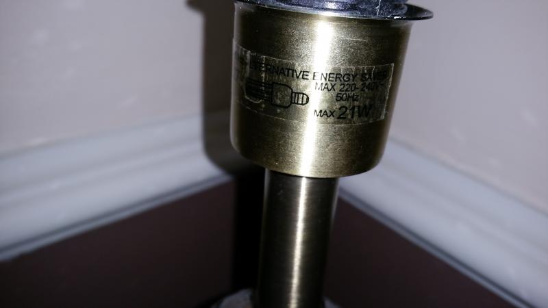

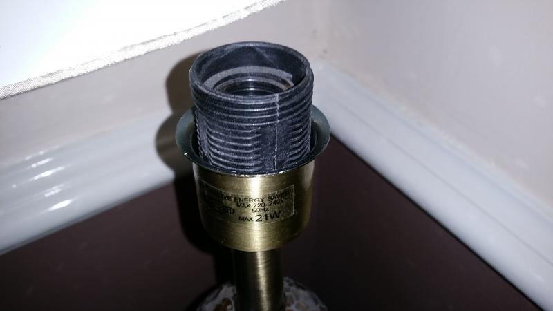

Hello,
I'm looking for some advice regarding a standing lamp. My wife and I purchased a standing lamp from JTF, and have only just opened it after storing it for our new house. The lamp is missing a part - it is a screw on piece that the bulb would sit on. I've included pictures of the lamp housing below - can anybody tell me what this piece is called so i can try and find one or where i could buy one? To describe the top of the lamp has lines for something to screw round, there is a hole int he middle for the screw bulb, so it must be whatever the bulb sits on. Apologies I am a complete novice to electrics so have no idea. Also roughly i measured the diameter circle and its about 3.5 cm
Thanks for any help.
Maybe a slandered bayonet light fitting screw bit would fit that thread.
This diameter is 3.5cm?
More likely to be 4cm - that's the standard "continental" size.
Just buy another lampholder and take the ring off it.
I don't think that damaging its reputation would be necessary. :LOL:
And it probably wouldn't - don't think anybody makes 40mm BC lampholders.
Its an Edison Screw fitting, not a Bayonet fitting.
As stated, its a shading ring that's required.
