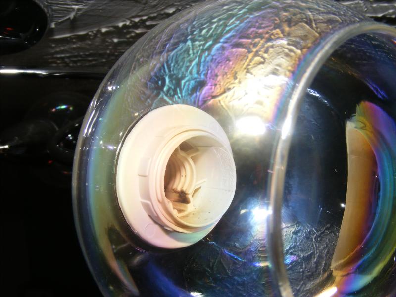

That looks like pitting caused by arcing caused by a bad connection between the lamp and the lampholder.

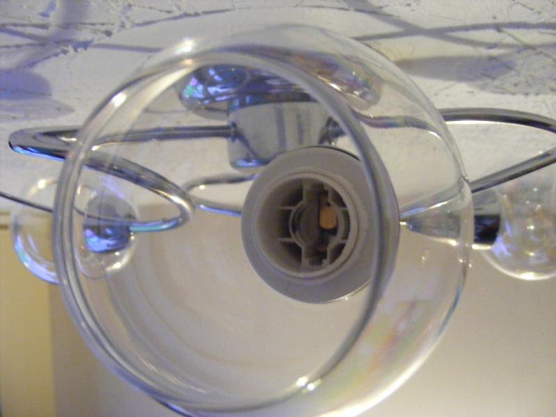

Did you screw the lamps in nice and tight? Can you take a photo of the inside of the lampholder? You might need to shine a torch in there if your camera doesn't have a flash.
They look ok. Just try the new bulbs and see how it goes. Osram and philips are good makes.

Actually, thinking about it, maybe I have nailed it. The light is positioned directly under my youngest son's bedroom. He often moves around (jumps, generally bounces around - he is:cool: and the light fitting does vibrate when he does this. Our old one did it too, but it had the small halogen capsule bulbs, whereas this has larger globe bulbs. Is it possible he could be inadvertantly causing bulb failure by vibration?
If this is likely, then replacing bulbs will be a continual process. Would LED bulbs be an option in this case? And if so, any suggestions for good sources (ie cheap!) of bulbs?
Over to you guys...
you can get LED or CFL type lamps in ses fitting
Is the light on a dimmer as the switch and lamps need to be compatible
