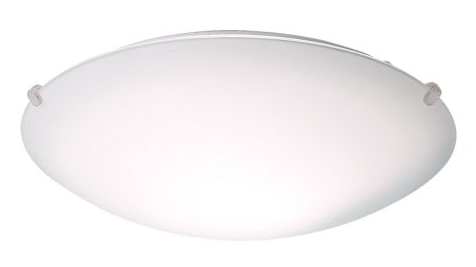

I had a ceiling light like this:
(Not that actual one, but a similar basic design) and the cover was plastic.
CFLs turned it into a brittle, crumbling ruin.
I would advise anybody who wants to use CFLs or LEDs inside a low-profile flush light to find one with metal lampholders and a glass cover.
