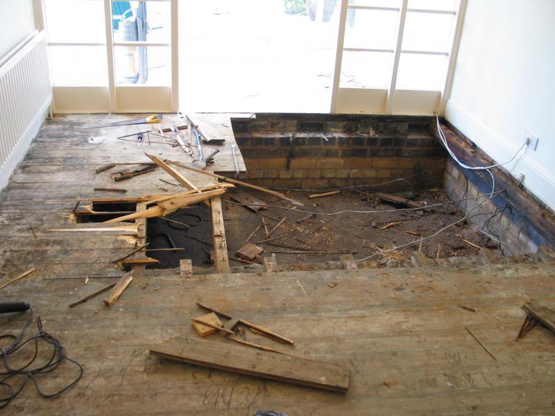

In short the water table rises to the point where it flows into my conservatory and lounge sub floor - (the result of this plus no ventilation was a rotten floor which I've since rectified and replaced).

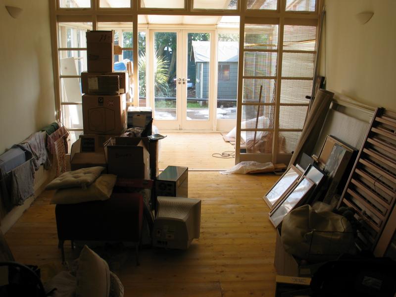

New floor. Ignore the moving-in clutter!

Before we bought the house!

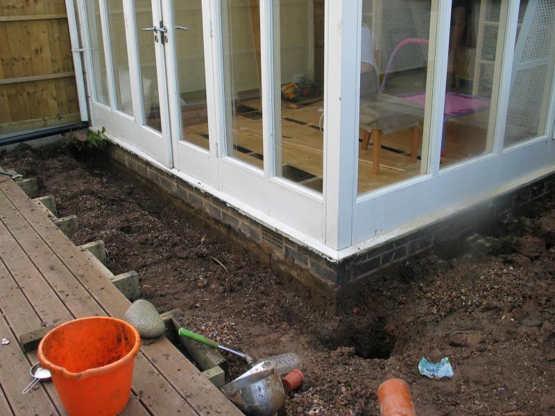

Investigating and digging

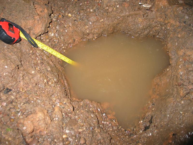

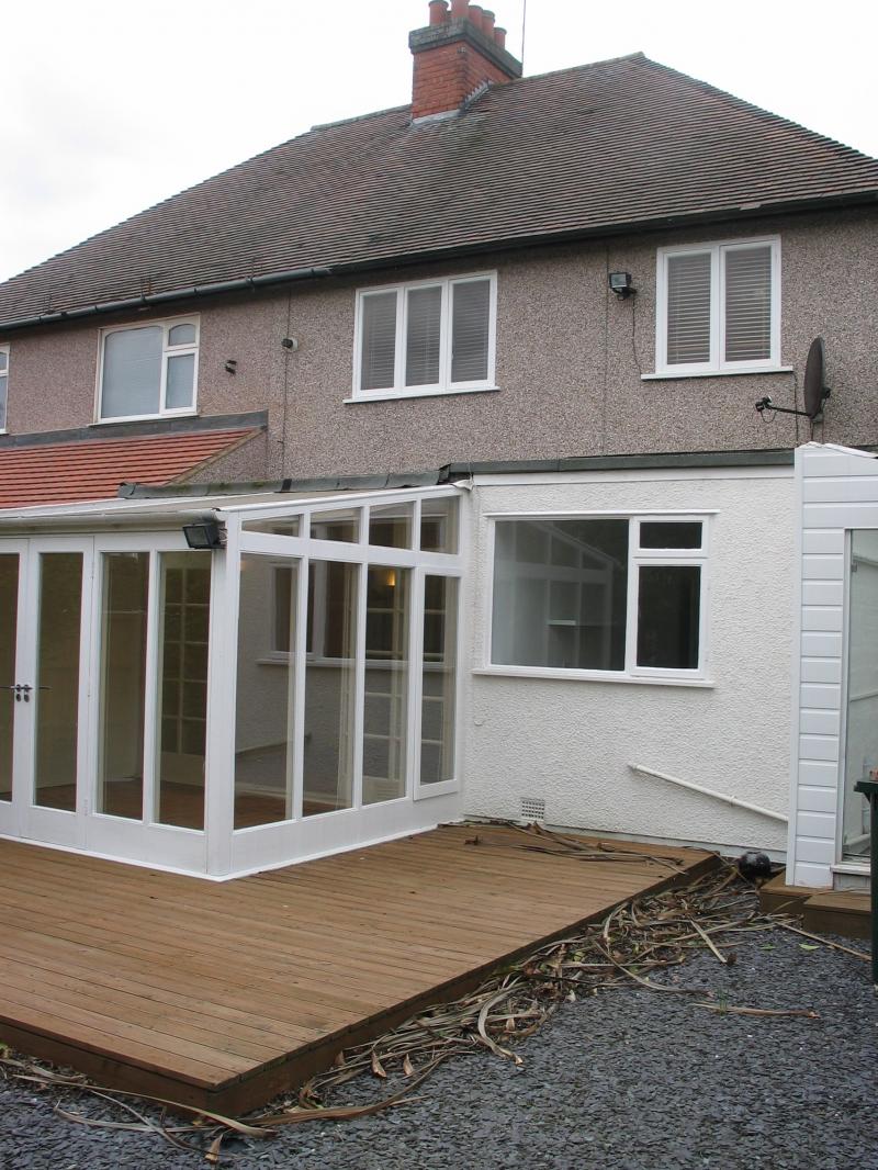

Found the conservatory down pipe led to this poor excuse for a soak away at the corner of the conservatory! Must've been cowboys. This pit, and others I've dug, fills up from underground after heavy rain.

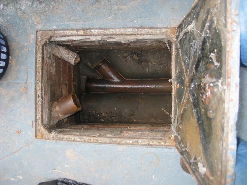

The good news is that I've an existing man-holed drain in the garage (the lean-to with patio doors far right of the image above) which can take the water away. I'll need to break into this somehow.
