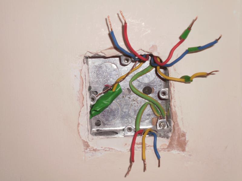

Landing and bathroom light switch
REMOVE THE LINK.
by lectricians diagram I have had the common linked wrong? I had them common to common

Sorted!
The diagram from Lectrician does it, I had the mains live in the common.
I'll try and understand were I was going wrong now.
Lectrician many thanks, Securespark and the others too.
Massively appreciated
Right, I've got it now.
I believe the blue was a neutral from the bathroom to feed the landing light, possibly to avoid a borrowed neutral.
Again- much appreciated for the help lectrician and all others.
The photo with the wires in, were installed as per instructions from 'ban all sheds'. Absolutely nothing happened with this set up.
I did not tell you to link the 2 COMs.
I asked you if you'd verified that the red & blue are permanent and switched live and if you'd connected them and the 3C+E strapper in the correct way.
When you said you'd linked the 2 COMs, I pointed out to you that permanent live does not go in the COM with 2-way switching.
AND THAT WAS AFTER I HAD GIVEN YOU A LINK TO INFORMATION ON THIS SITE WHERE YOU COULD HAVE FOUND OUT HOW 2-WAY SWITCHES ARE WIRED.
