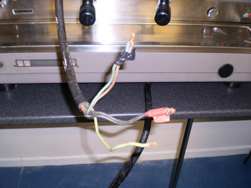

I received a telephone call from an Indian chap yesterday asking me if I could connect up his copy machine for him. No prob thought I, it probably just needs a plug connecting and plugging in. Should earn me a quick £36.00. I explained that I charge £12.00 an hour for a minimum of three hours. The conversation was a bit difficult as English was not his native language.
When I turn up, this is what he wanted connecting...
A coffee (not copy) machine - Industrial - and I had to decline the work as I would not have known where to start.
I did look for a plate on the machine just to show him that it was not something that could be connected to a 13 amp plug.
I don't even know why it had a blue and red twisted together and two blacks twisted together.
My electrical knowledge is limited and I suspect this would have required a dedicated line back to the CU.
So, next time I deal with a language barrier, I will make sure I really know what the person wants done. :LOL:
Did you find one?
Is that actually red, or is it brown?
My first thought on seeing the 5-core cord is that it's just a common Continental flex for a 3-phase appliance: Brown for L1, two blacks for L2 & L3, blue neutral, green/yellow earth.
Maybe the twisting of the wires together was the owner's original (failed) attempt at getting it working here?
or it could be a three phase appliance that has been converted to single phase and some of the cores in the flex doubled up to increase the flexes current carrying capaicty.
Either way it needs someone who understands such applicances to take a look.
