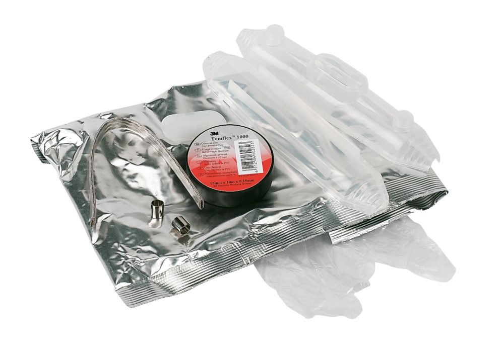

Thanks for the links guys. The issue is that the three different cables have so many cores that it is diffcult to fit them all into the connector blocks & I assume it is not good practice to remove some of the ends of individual cores to free space???

do you mean they are stranded? Unlikely to be 2.5mm then. How did you measure or identify it?

If it really is the (stranded) old imperial equivalent of 2.5mm² T+R, you really should not have difficulty getting three into one terminal.

how many strands are there, and how did you decide it was 2.5mm?
This is called a double cooker connection unit it may be what you need, but you have not said where and why you want to tap into a cable.
In this case it is designed to be in the wall using a back box and only two cables have clamps. All electrical work is designed, installed then inspected and tested, the design may be for a protective device at destination rather than origin although then normally limited to 3 meter, but to just break into a cable without knowing what the designer intended could be dangerous, it also could be very straight forward, so some more information as to what you are trying to do would help.
I am sure you don't need one of these

We never established if your cables are actually only 2.5mm2.
If your cables are 6mm2 or 10mm2, a 60amp junction box is available.
