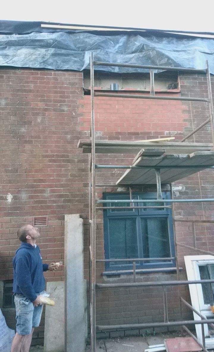

Large perps?
Why are the bricks completely different?
I'm guessing that because he's having it rendered and because the existing bricks are 73mm, these were the cheapest most available option?
I would have banged two wall starters on each jamb and used blocks. Ho hum.
That's right. They are 73mm, I matched them up with the bricks on the main house:
But just wanted to try laying bricks rather than blocks so had a go on that window. I raised the room on the inside with blocks.
You can see how rough the whole wall is here:
And how big my bread roll is ;):LOL:
One thing I found hard was getting the mortar ontop of the brick which ties in with the old ones.
Is there a trick to doing that or do you just press it in with the trowel?
Wet everything first. We butter the recipient bricks as well as the one being laid. The mortar bonds better and there is less pointing (filling) to do afterwards.

If the bricks are different, and the wall is to be rendered, then why worry about the size of the joints?
For the strength. I thought a larger joint may be more likely to crack.
