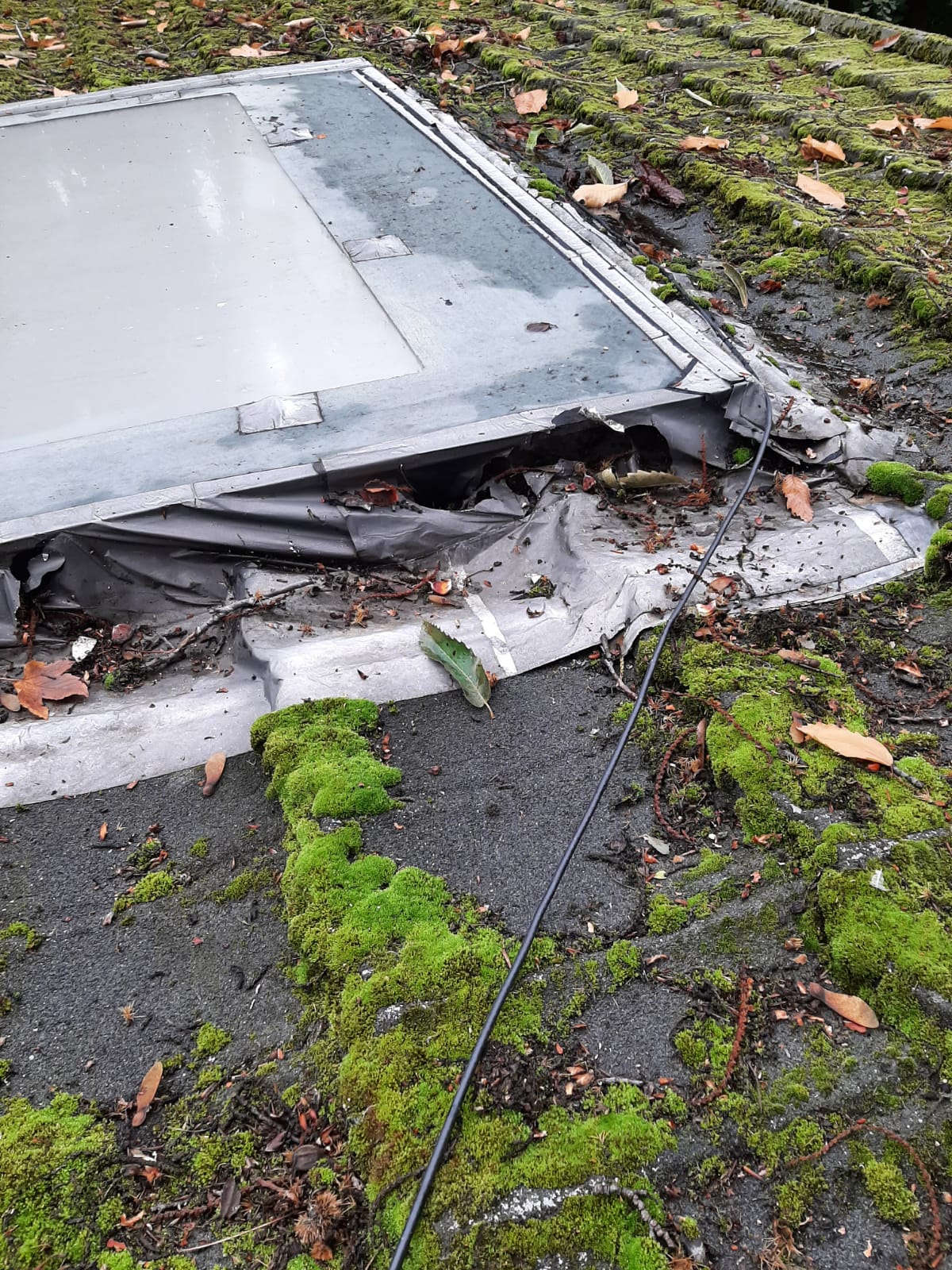

Large skylight repair - flashbanding?

I'm struggling to find anyone willing to take this on, so to the extent anyone's able to either recommend someone or provide some Noddy level steers (so I can DIY), that'd be hugely appreciated.

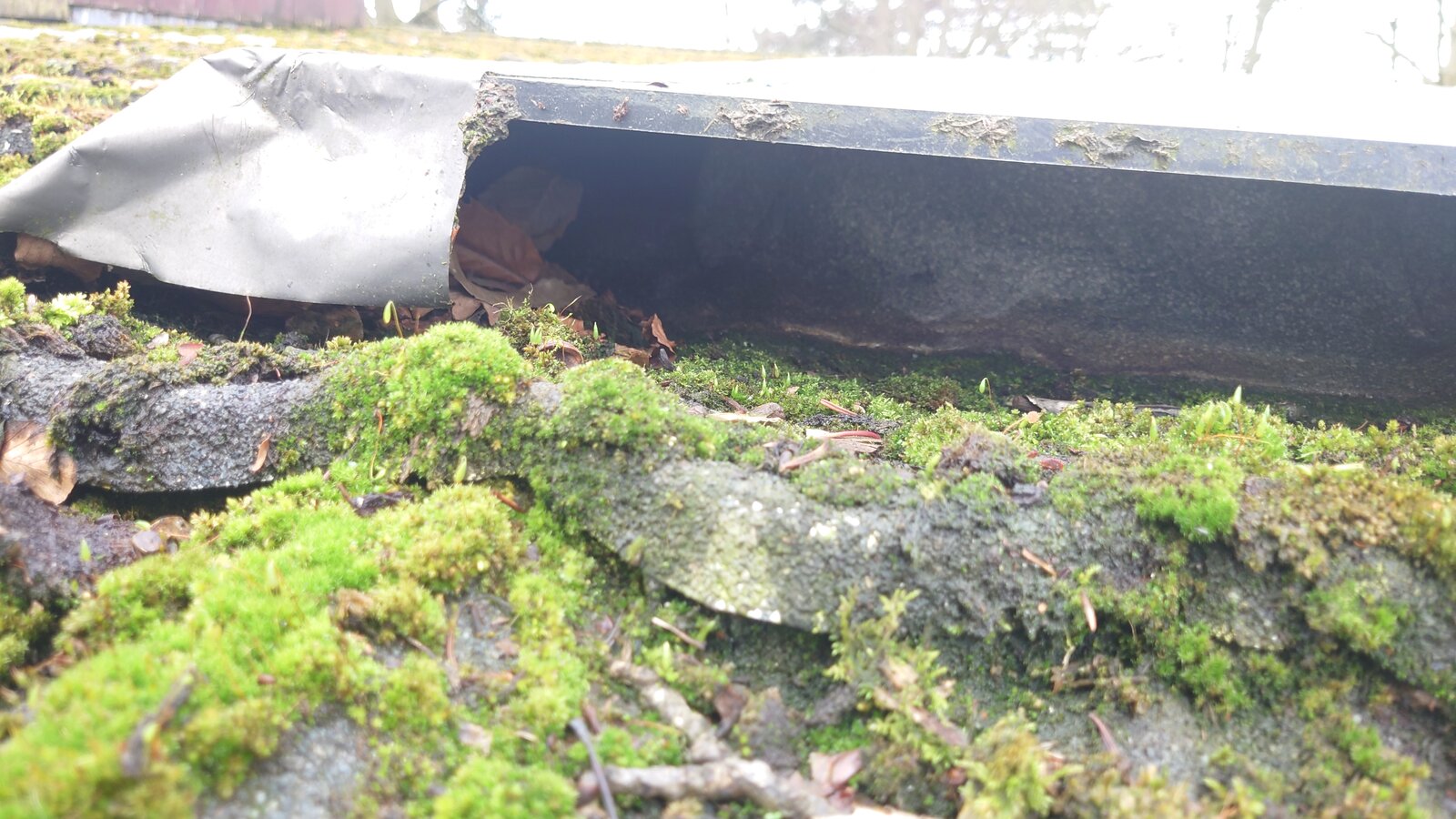

There is an upstand underneath, which the polycarbonate overhangs. See below.

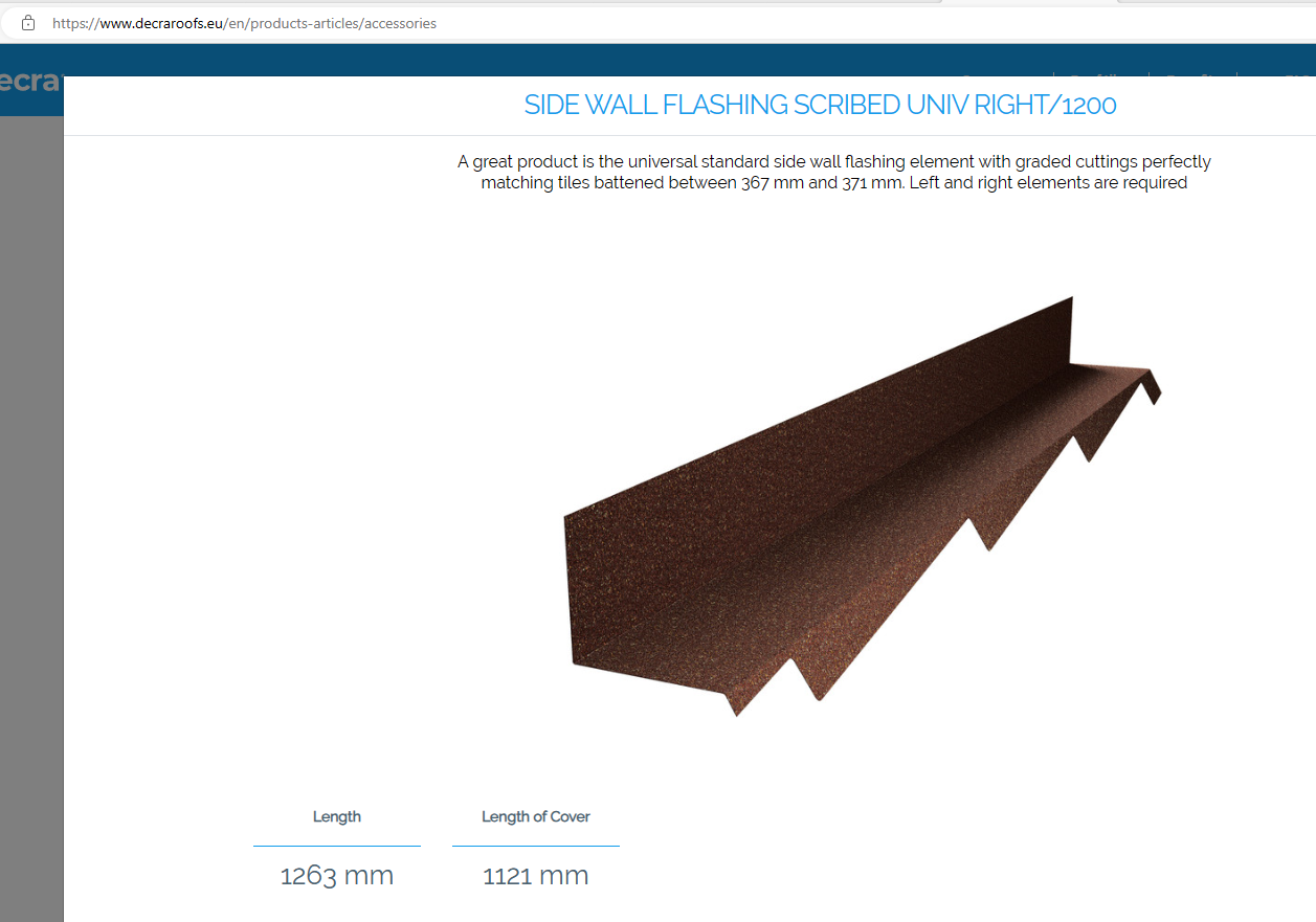

It also seems Decra do a flashing product which might help - see also below. Though finding a supplier is proving challenging!
