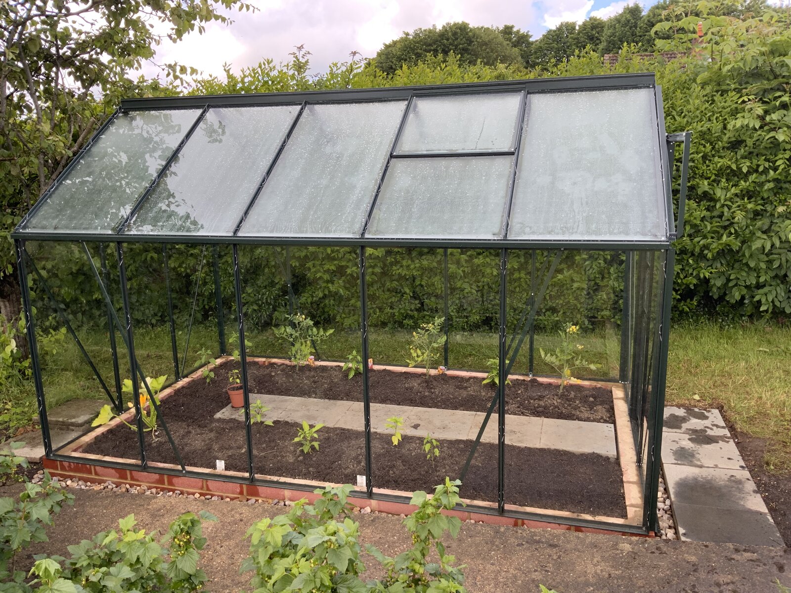

Thanks. Well today I marked out two adjacent sides, using homemade profile boards, bricklines and a large square from Toolstation. I measured the diagonal, and it differed from the calculated value by 8 mm, 3770 mm calculated and 3778 mm measured, so I count that a success. Measuring lengths with a tape measure is a right pain. The large square I bought is a really nice tool.
I could have made a large square from planed timber, but it would have cost ~£20, so I thought I might as well buy an aluminium one. And the wood one would warp over time when stored in the garage.
I’d never earn a living doing this at the slow pace I work !
Thanks for the suggestions. In the end I used a long spirit level and a metal square. It wasn’t hard to do, it just required a bit of care. The outside edge of the finished wall is accurate to +/- 1 mm, and the greenhouse frame fitted perfectly.
