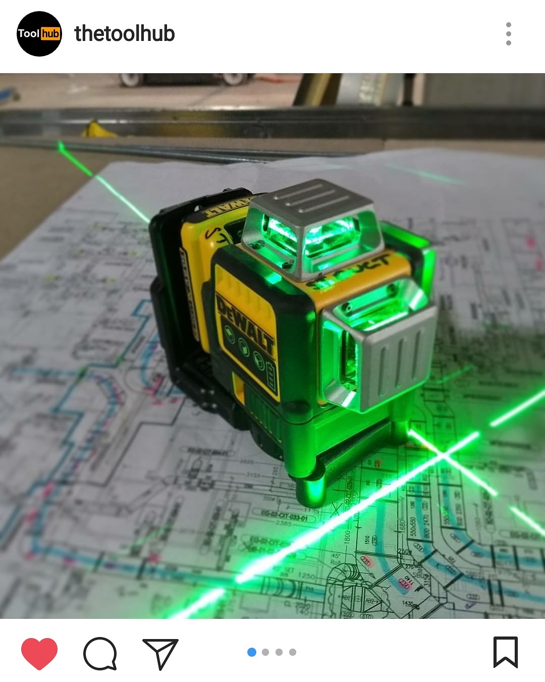

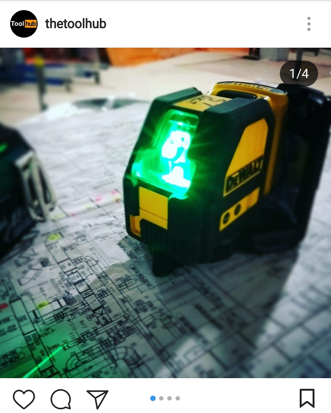

Used dewalt and Hilti lasers for the last 10 years. This year I bought two dewalt green lasers. They're not cheap but if you use them a lot they're worth the money.
It comes down to what your budget is and what you're doing. Where you're working, indoors or outdoors?
I've attached pictures of the two green lasers I have and they're excellent. I've still got a couple of the older DeWalt red line that run off AAs and I've got a 5 spot plumb laser.
If you let me know where you're using them and budget I can give more info.

Well I have the DCE089 and love it for how quick and easy it is to set up a pair of lines at right angles but I wouldn't say it's going to be amazing outdoors without the detector.
The DCE088 is definitely the brighter of the two flagship models offered by DeWalt.
I did see the Bosch green lasers at the DM tool show earlier this year and while the app features to control them from your phone are nice, at the price they fall well short of the dewalt for me.
Truth be told though, for grading and a lot of outdoor use you may want to consider a proper rotary spot laser.
