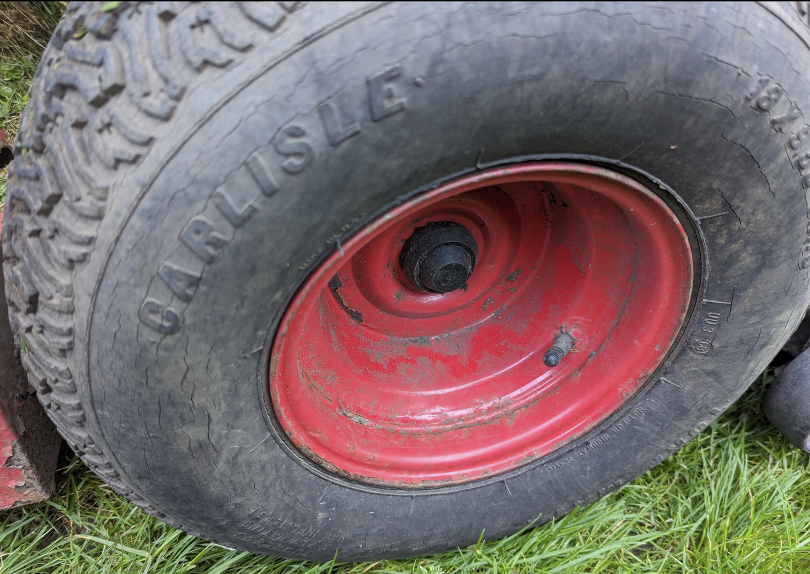

Lawnmower tyre keeps deflating even after replacing

Show us a picture of the rim and tyre, so that we can give you targeted, relevant advice

The old wheel might be rusty or corroded. This prevents the tyre sealing. It will be difficult to smooth it off without removing the tyre.
Is it possible to get a spare wheel?
Old ones can be painted, but you would have to bake it or leave it for a very long time to harden and gas off solvents.
Tubeless tyres usually have it marked “tubeless” on the side
So I found the tyre flat again when I came to do a cut after all the rain (and rain, and rain). This time I noticed that as I unscrewed the type cap, I heard a quiet hiss of escaping air. After pumping the tyre up and removing the pump, it was much louder. It stopped when I put the cap back on.
So I'm guessing this is saying the valve itself is the culprit... it really shouldn't be the valve cap that's keeping the air in!
I also think I got mixed up last time when I said it's the new tyre which is leaking, because only one was flat this time and it's clearly not a new one :)
Is it able to tell from this photo if there's an inner tube on this one?
I thought you could tell by the valve. Tubeless have a big rubber seal, and tubed a screw down metal collar
But yours seems to have neither
I think you need to wire brush, derust and repaint the wheel over winter.
Theres a tube in the tyre, quite a few tubeless tyres I come across on ride on mowers have had tubes fitted when the rim rusts preventing an airtight seal. I would try fitting some new valve cores
