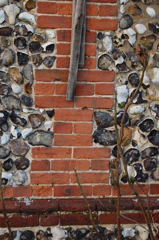

Here's an original non-hydraulic lime mortar, with Norfolk Reds:

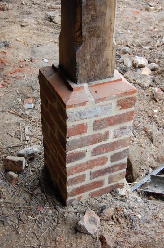

And here's a plinth built in Norfolk Red reclaims using white cement and sand 1:5 mix:
I know which type I prefer (clue: it's not the bottom one... :))
OPC will give you a grey colour, white cement a yellowy-white colour; the mix ratio will result in some variation to these.
Yes, the first one is so much better. Will look for some non-hydraulic lime at Travis etc.
