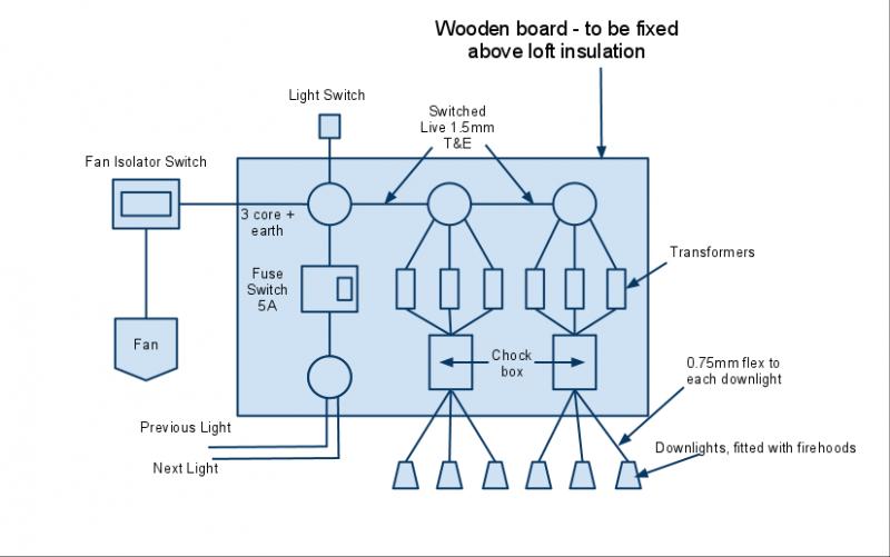

I am installing extra low voltage (12v) halogen down-lighting in my bathroom please can you advise if the following setup is ok. Essentially, is it safe to use the switched 1.5mm T+E live to supply 6 transformers as shown in the following diagram:
would I be right in thinking that if 50W bulbs were used (I intend to use 35W bulbs) then the max load on the Switched live cable would be 300W/240V = 1.25A Max load?
Thanks holmslaw.
Taking the layout a bit further and including an extractor, does the following look sensible. I intend to mount all the transformers on a wooden board which I will fix above the loft insulation.
Does this look ok?
The downlighters are IP65 rated but I dont think they are fire rated: http://www.screwfix.com/p/fixed-white-12v-low-voltage-bathroom-downlights-pack-of-3/34883
I do want to insulate around the lamps so I was thinking of fitting a fire hood similar to http://www.screwfix.com/p/halolite-downlight-fire-hood-150mm/70589
If you can mount the board vertically so there can be air flow over the "transformers" to increase the cooling of them.
Use a fire resistant board as a failed transformer can get very hot and in worse case ignite.
Do not put them close to each other. space at least two inches apart to prevent over heating and (possible ) interaction between them.
You cannot parallel together the outputs of the "transformers" as shown.
Six separate pairs of terminals, one pair for each "transformer" ( 12 terminals in all )
Nothing to stop you using 1mm cable - it will save you a bit of money toward your electricity bill. The fact you are using six lamps @(210w or 300w) when one proper lamp at 60w would do, should tell you all you need to know - never mind about heat loss or fire hazards. Incidentally, I would use heat resistant cable for the link to the lamp.
You seem to have introduced chocboxes into the equation - not sure why?
You will need to check with the tranformer instructions - most set max limit on the length of cable between the transformer and the lamp.
You also need to check whether they can/should be fitted in a box - transformers, like downspots, do get hot and need to be able to disappate that heat.
Just to house the 2 strips of connecting blocks for connecting to the lights.
The back board is just chipboard but the cables to the lamps will be using heat resistant flex.
As I said, the manufacturers instructions need to be read to determine the min and max length of cable from the transformer to the lamp.
In your design 2 with the choc blocks you may not achieve this - better use design 1 for the lights - forget the chocboxes.
Your transformer needs a lot of ventilation - do not cover it in a box - see the attached instruction sheet for a 60v 20/60 electronic transformer.
http://greenbrook.co.uk/product-pdfs/ETR60_Ins.pdf
Don't forget if you fit it yourself and/or not in accordance with the manufacturers instructions its a good excuse for the manufacturers to refuse you guarantee.
