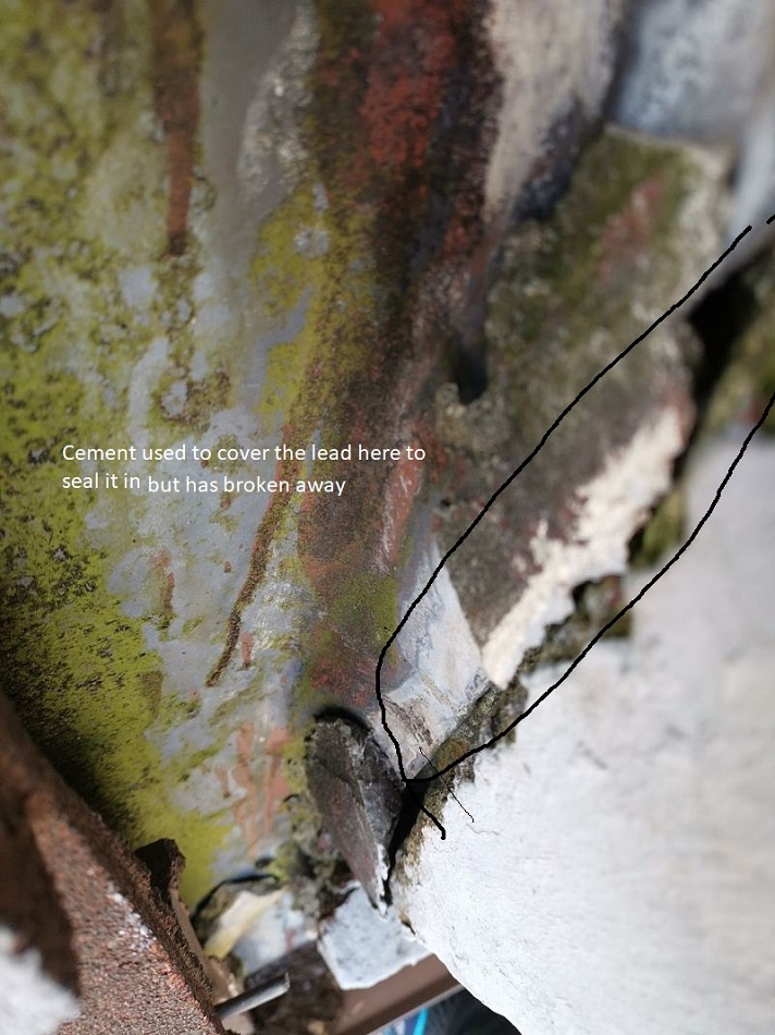

Hi,
I am looking for some advice on a lead flashing leak I have.
In the summer I hired a Roofer on MyBuilder who had 300 5* feedbacks
as one of my widows the cement had broken away and was open and letting water in. The roofer who came out resealed the lead using FlashBand, I am not convinced this was the correct way of resolving the issue and after looking at the job could have easily done it myself.
The lead on none of the windows has been installed into a groove, which in my opinion would have been the correct way.
Here is a picture of the work the roofer carried out in the summer, the roofer has just gone over the top of the old lead:

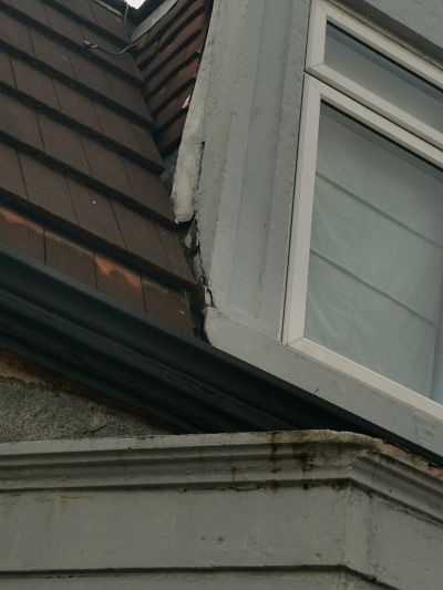

Now another one of my windows has gone the same was, can anybody please advise how best to reseal the lead?
Here is a pic of the window/lead causing the problem:
And a close up.
The only way of doing it properly is renewing the lead.
Thanks for your reply, yes I thought he should of cut a slot in the stone and secured and sealed the flashing properly and remove some tiles to ensure it is properly fitted.
What would be your view on the repair the roofer carried out on my roof in the summer is it a satisfactory repair?
Flashband is a temporary patch repair product.
What did he tell you when he did it, and were you charged for a temporary repair.
He never told me it was a temporary fix, he told me he uses it on all his jobs and has had no complaints.
He charged me £250 for the repair.
I could have done that fix myself.
With regards to the new leak, I am a bit concerned about calling another roofer out this time of the year, it is certainly the prime time to be ripped off with all the bad weather recently.
I take it the roofer should have cut a groove into the stone to secure the flashing and sealed it, whilst removing a row of tiles to ensure it is fitted properly?
As a temporary repair until the summer would you recommend trying to reseal the lead with cement or copying the roofer and using flashband.
Thanks again.
