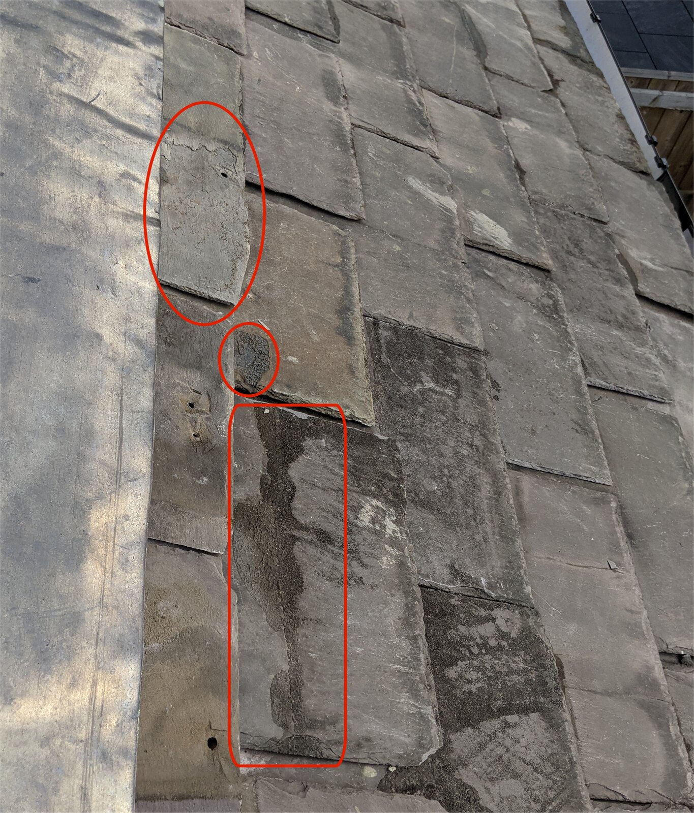

I've now got *another* problem with the same job! Several slate tiles were replaced on the same roof as they had cracked over the years (or maybe from windowcleaners walking on them etc!). But today, 2 days after installation, the new slates have started showing signs of damage on their surfaces - most are rough and flaky, with a thin top layer coming off on one slate. The older slates are fine. Is this a sign of poor quality slates, or second-hand rejects, or have the builders damaged them in some way? FFS it's a nightmare.
I'm guessing it's just the type of slate used.
Probably no big deal other than visual . The original slate appears Welsh.
A picture would be good
I can't imagine for one moment that any new slate would start to shale after two days!. Could it just be loose flakes/debris from the transport or storage?

Datarebal, see attached photo of some of the newly-installed slates.

I asked about the flaky tiles, they said that they were reclaimed Welsh tiles to match the colour of the existing old tiles, or else they would look odd, and that older tiles do have a level of flakiness but it was only minor and wouldn't affect the weatherproofing.
They said they'd cut the old lead out of the gap between the bricks (but left the rest of the sheet in place), and installed the new lead sheet into the gap to a 35mm depth using clips, and mortared it in place.
So I'm going to leave it, as it all seems "probably" OK - but chalk one up to knowledge and experience.
