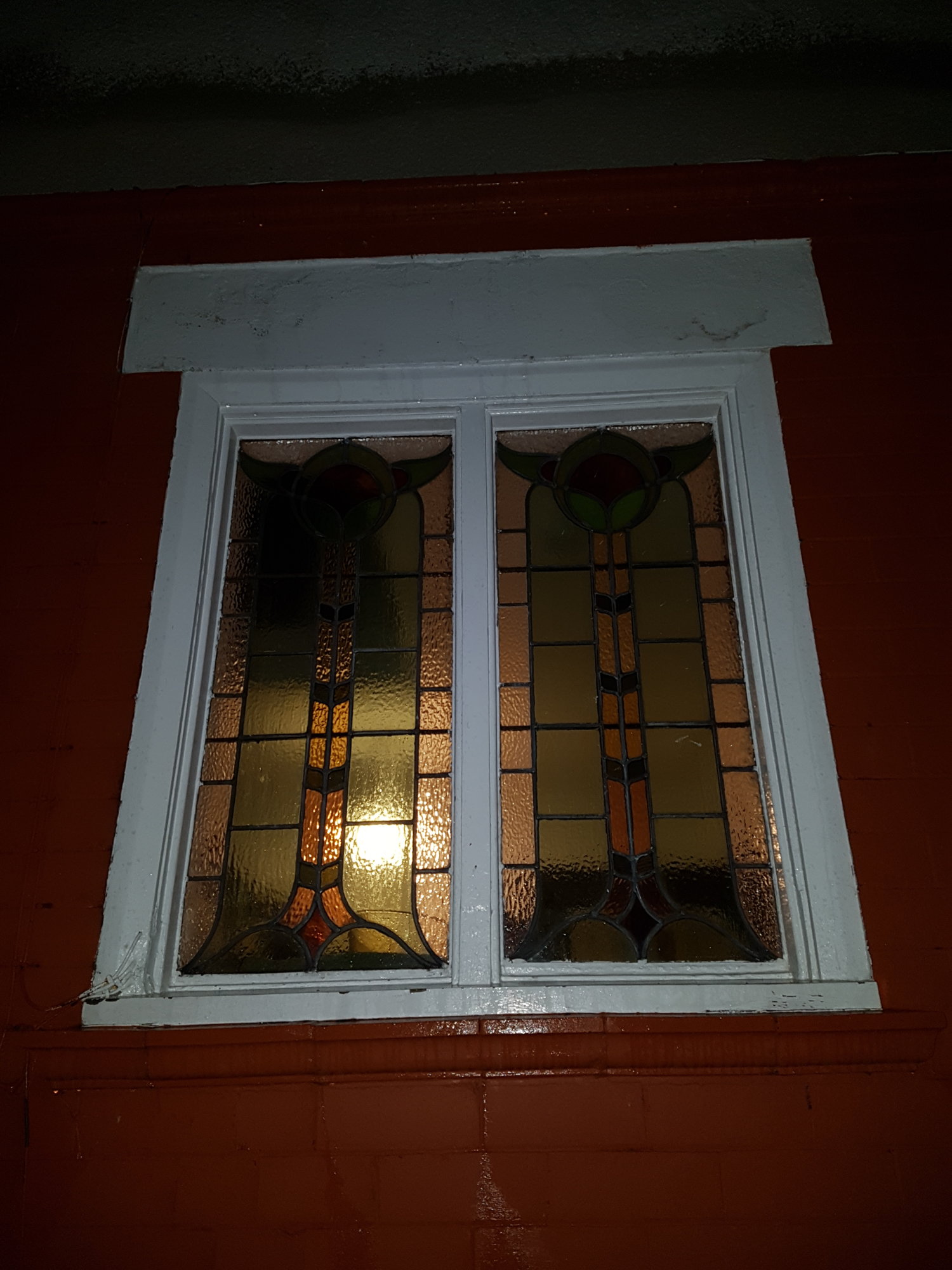

Hi - I have been battling with intermittent leak for almost 6 years now, due to the intermittent nature it is very hard to determine where the leak is coming from and also if any work done to fix the problem has had any effect.
The leak is above the frame of a ground floor window in a 1906 semi. The window is in the west facing gable wall which is extremely exposed to the weather. During winter the gable is frequently lashed with driving rain and it is only during winter weather that the leak occurs. The history of the issue and what we have done is as follows:
On the day we moved into the house in February 2014 during a period of very wet weather we first spotted the leak. It was emerging from the wooden internal architrave above the window opening which was flush with the internal wall. The leak went from a drip-drip to almost pouring in during a particularly heavy downpour. We looked outside and could see the stone lintel immediately above the window frame was poorly pointed, we got up on ladders and could actually push a screwdriver down the left hand side of the lintel. We therefore re pointed around the side of the lintel and we had no more leaks for the rest of 2014 - problem fixed?
During winter of 2014-2015 the leak returned, this time in a slightly different location and less severe, dripping water emerged across one side of the top of the window frame. Close to the first leak location but this time immediately above the face of the window.
I got a builder out who was not very keen but he went up a ladder and claimed to see some issue with the pointing above the top of the lintel, for free he applied some silicone sealant to the top of the lintel and said we needed to point it properly. This had no effect and I called the guy back but he had no interest.
I then spotted that the rendered 1st floor section was showing some defects immediately above the lintel. While the underlying render seemed solid the surface pebble dashing and many layers of point had blown with moss growing behind. Being immediately above the leak location and at the base of the first floor rendered section I considered if this might have been allowing water running down the wall to enter the render at this point and get in to the wall above the lintel. I did what I could to patch up the flaking pebble dash for the 2015-2016 winter but it leaked again during extended wet periods.
During 2017 we had the house repainted including the render, lintel and window frame. The painter scraped off the loose pebble dash layer immediately above the window and repainted directly onto the underlying render. A bit of a bodge but looked fine from ground level.
Success:)!! The winter of 2017-2018 passed with no visible leaks!
Winter 2018-2019 the leak returned:(. Up on a ladder I could see that the paint applied to the defective rendered sections had blown, I concluded it had lasted a year and water had penetrated again so I decided to do something more fundamental and had a series of rendering companies out to look, I could see that there appeared to be a repair line running along the base of the render approx 0.5 m above the ledge all along the gable.
I had this section of render cut out and replaced back to the brick hoping it would cure the issue for good. Sadly this week the leak returned absolutely no different to before the work was done. Im really pulling my hair out over this which has been going on for far too long now.
Ive attached pictures of the window and would appreciate any thoughts, the work down so far would indicate that defective render at the base of the 1st floor level was not a source of the leak at least, which leaves me with the following possibilities:
1) Water is entering the gable wall cavity somewhere above the repaired section and running down to the window opening. Would this not lead to damp problems in the wall above the window? The leak is confined to the window frame opening, even immediately above the window frame internally there is no evidence whatsover of damp or anywhere else in the wall. Fix - re render the whole gable end?
2) Water is being driven through the lintel and/or brickwork and ledge immediately above the lintel and entering the window frame. Fix - check all pointing, re paint lintel, yearly?
3) Water is penetrating the window frame directly. Fix - re seal around window frame.
I must admit we havent considered #3 before as other defects above the opening were more obvious, looking at the window it is fitted with external architraves very flush to the opening without any obvious sealant used. Its hard to know if water could penetrate but applying window frame sealant around the edge is something perhaps we should have done right at the start. I will get this done asap at least to rule out this possibility.

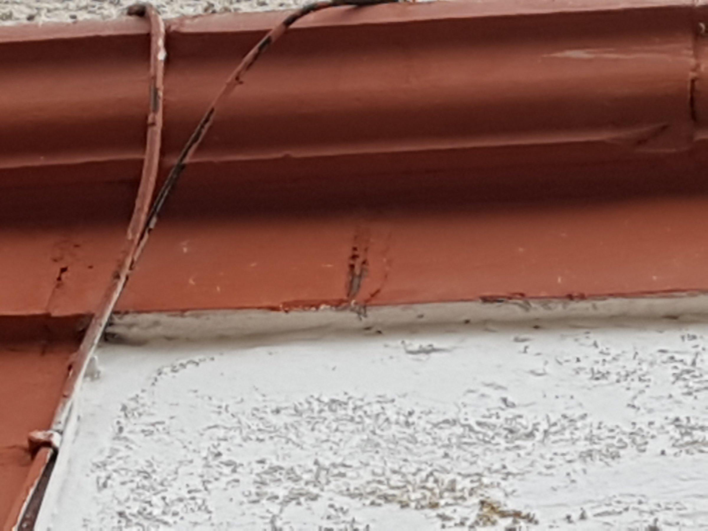

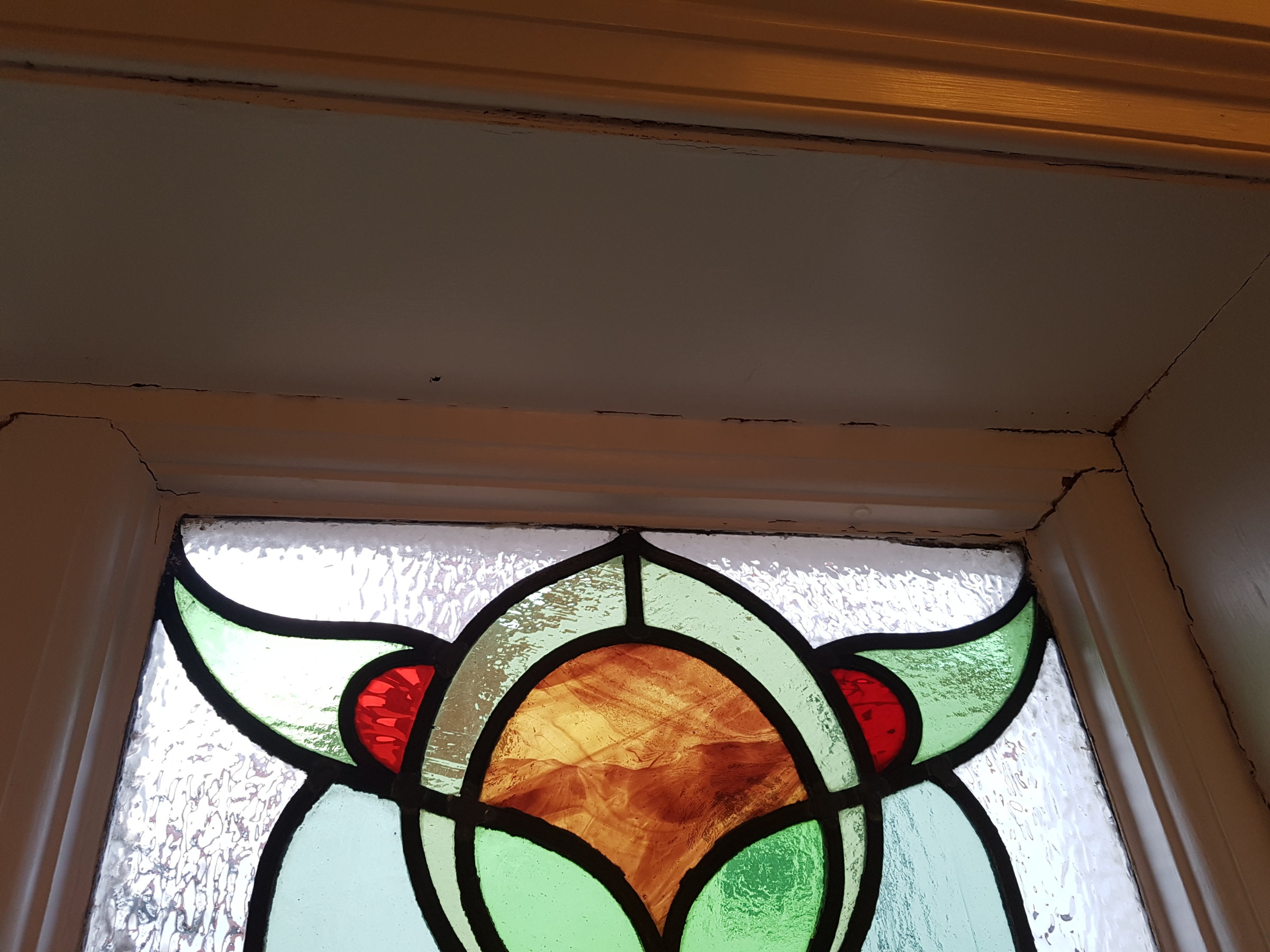

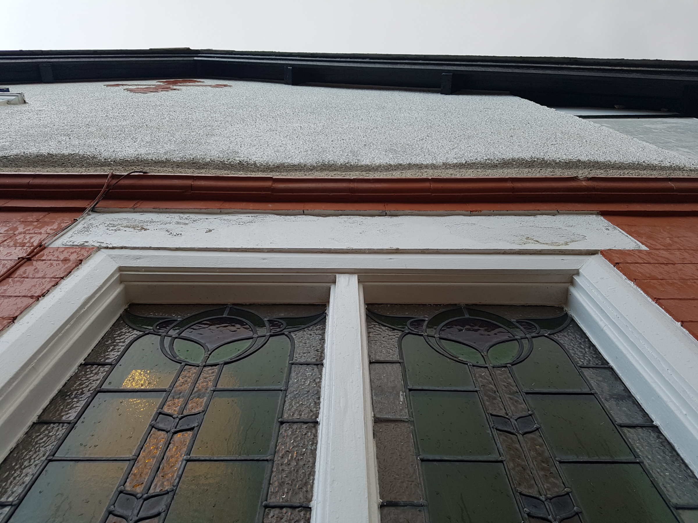

Ive attached numerous pictures:
- Showing rainwater dripping down exterior.
- Window, with lintel and brick ledge above. Render repair visible as unpainted section.
Closeup of top edge of external windowframe.
Closeup of top of lintel and ledge.
Internal leak location.
Looking up the wall.
Is the wall cavity or solid?
If cavity, do you know the depth of the lintel? -if there is a leak path across the cavity, its possible there needs to be a cavity tray,

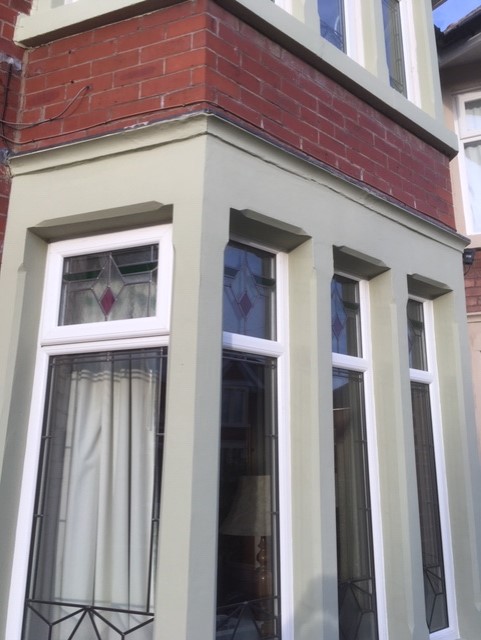

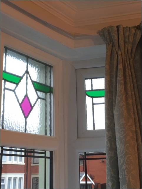

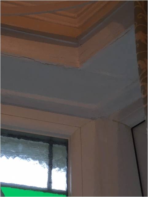

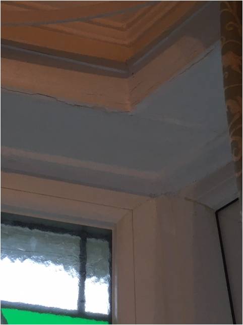

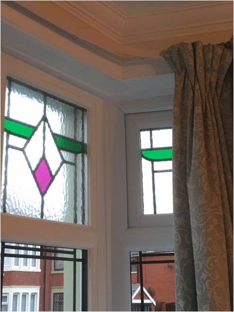

Hi Andy, I have been dealing with exactly the same problem for the last 3 years. We have had numerous builders out (federation of master builders, Trusted Trader etc, tried them all) and nobody has been able to stop our leak. We have also spent quite a bit of money to date trying to resolve this. Measures taken to date:
- A company checked and re sealed all possible areas on the external walls above the leak area
- Have replaced the guttering and checked the roof tiles which are all good
- Have had the stone mullions replaced in the entire bay window and resealed all joints around the window
- Have had a leak detection company out who could not find any damp within the walls anywhere on the front of the property (ground or 1st floor)
- Have had a cavity tray fitted (the builder removed 2 brick courses above the bay window to fit this)
All without success - The leak returned a few weeks ago. We get days where there is heavy rain and no leak appears, it generally comes back when there is heavy wind and rain combined. It has got to the stage where it has effected my health and sanity. There must be somebody somewhere out in the Blackpool area there who can fix this without trying to make a fast buck!
My next move is trying to find somebody who can replace the internal timber architrave (possibly with a plastic one). This is not a big job but it will also allow us to inspect the inside of the leak area.If you know anybody who could do this, please let me know as I am at my wits end. Attached are a few pictures. I can be contacted using PM
Cheers - Joe

I certainly understand how you feel. Builders are not keen on these jobs I guess because it is so difficult to know where the water is entering.
You didn't post external pictures, was the cavity tray installed directly over the lintel?
The first builder to suggest it for us wanted to put one several courses of brickwork above because of the decorative ledge. I don't see how a cavity tray would stop water penetrating below it in that case. The smart tray in the link above was fitted directly above the stone lintel.
It's early days but the leak did not return during the recent stormy weather and the window was being battered by driving rain. It was hitting so hard it was forcing water through the leaded joints in the stained glass which shows the pressure driving rain can exert as there are no visible defects in the leaded joints and no drafts can be felt. The leak from above didn't return though so fingers crossed it has worked for us.
The smart tray people are in bury so not so far from Blackpool.
Andy

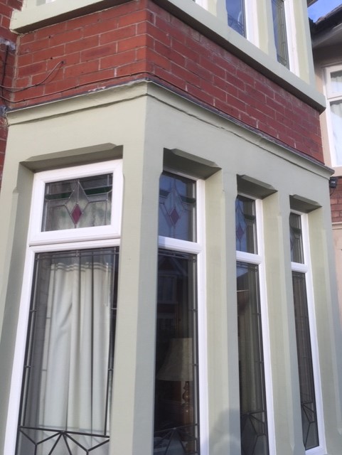

Hi Andy,
The cavity tray was installed where the brickwork meets the top of the bay window (the lowest possible position) as per the attached picture. When the leak returned, the builder came back and put in some "weep" holes. Despite this, the leak remains intermittently. Apart from replacing the internal architrave, I will have a look at the smart tray people - cheers/Joe
