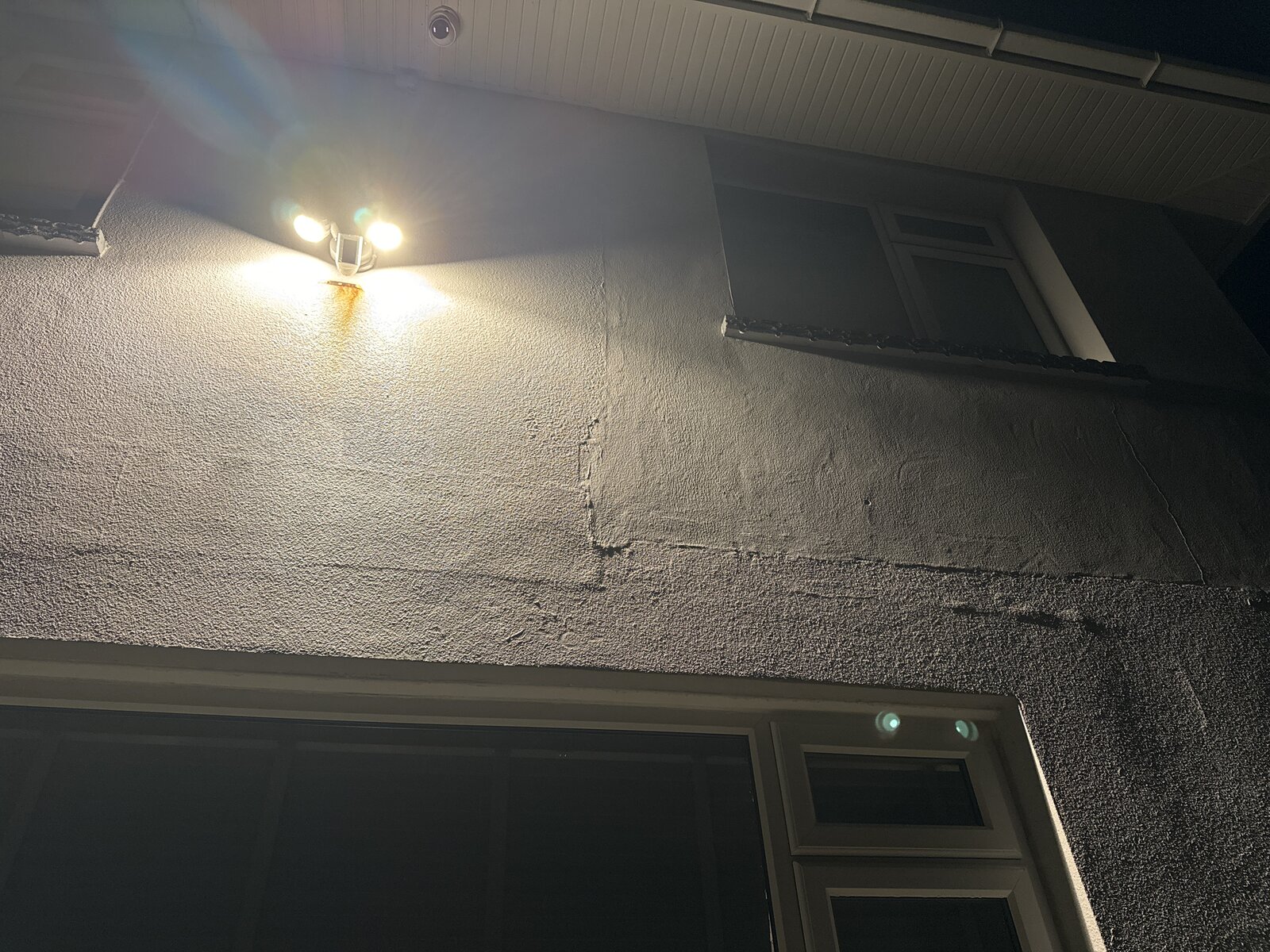

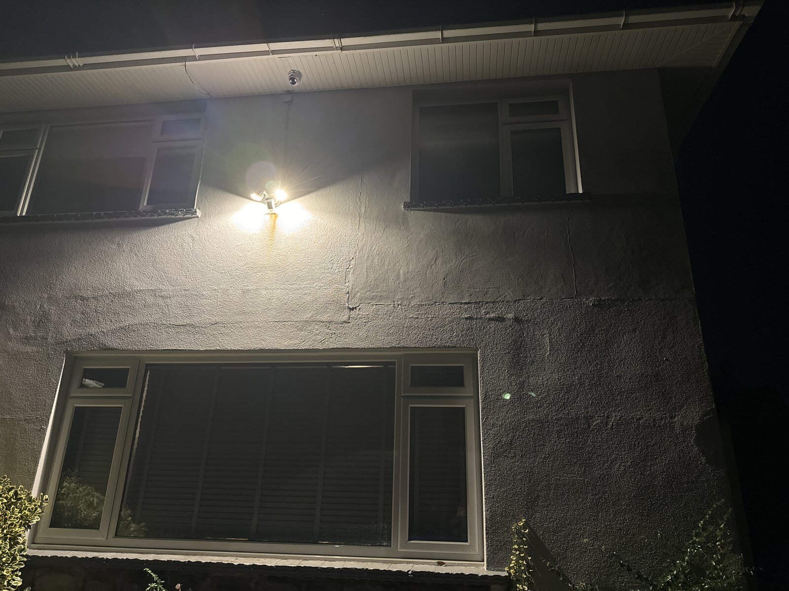

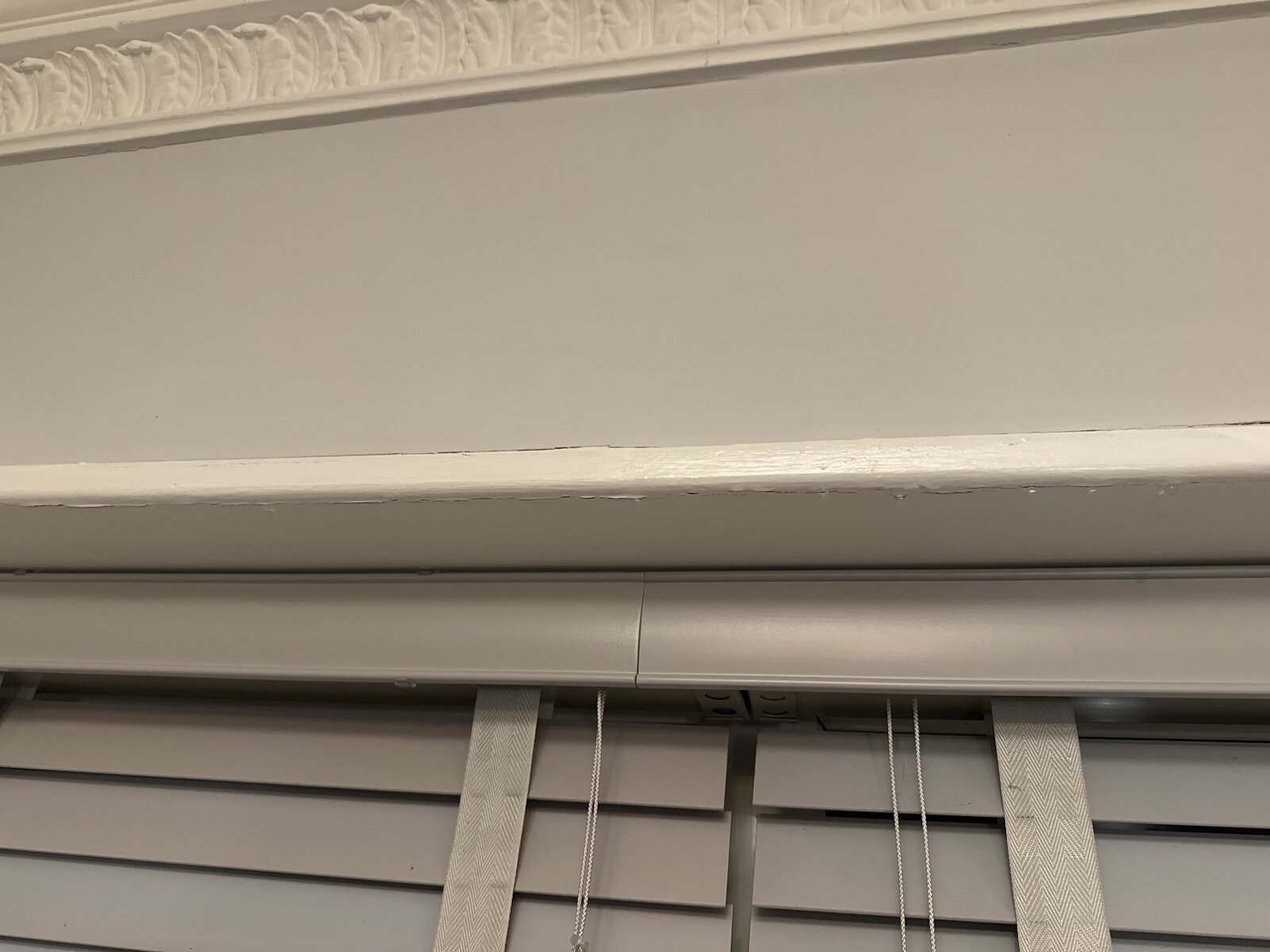

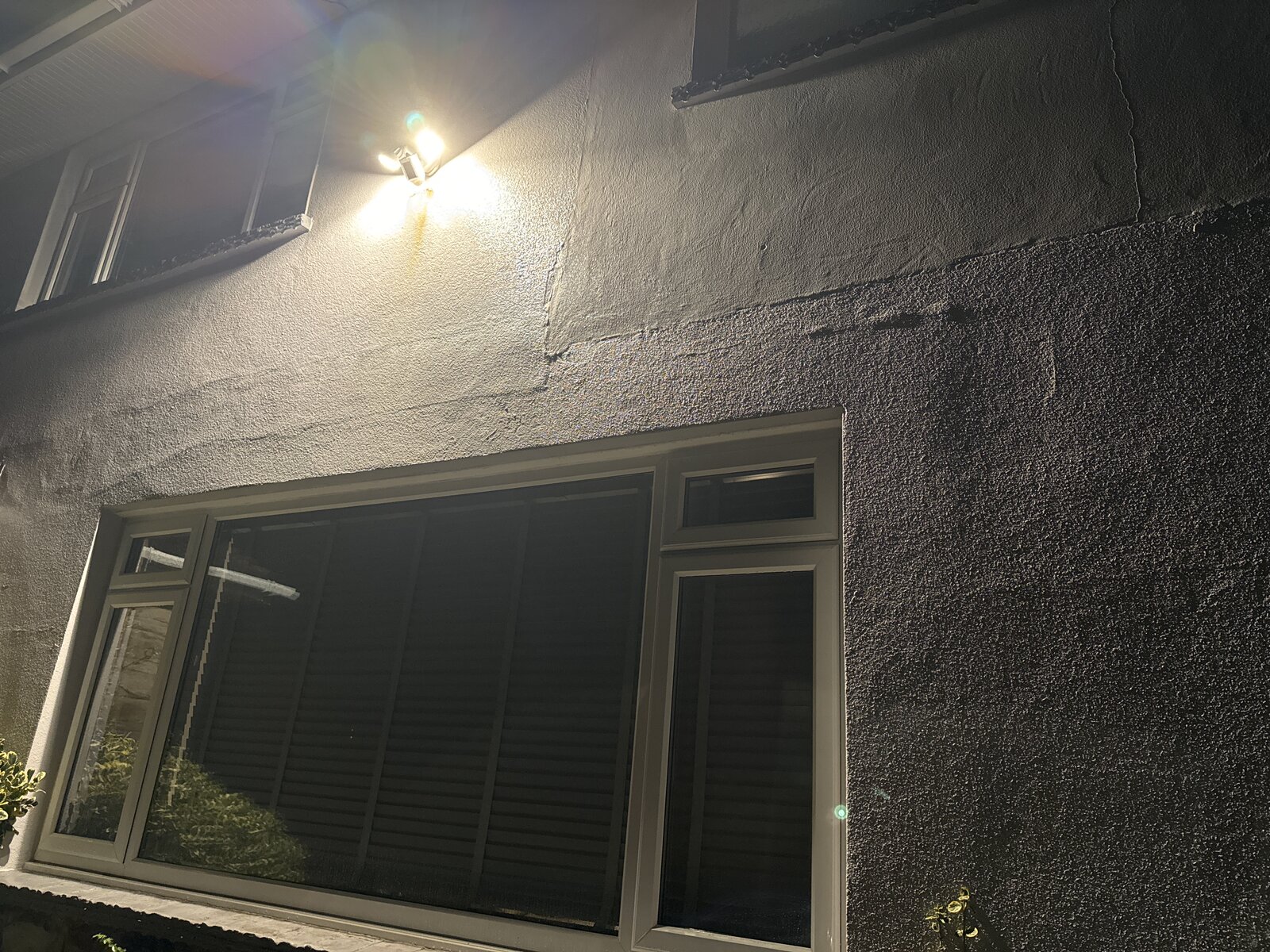

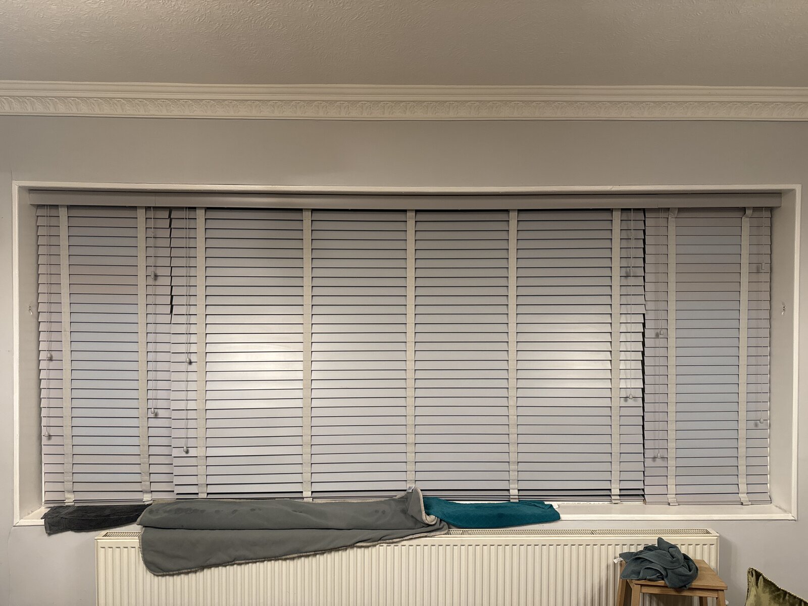

How’s everyone getting on in here? We moved into our 1950’s detached last November and when water started coming in through the uppermost wooden window frame in our downstairs living room I couldn’t believe it. As per nearly all the experiences here:
It’s only with driving rain.
No trade is interested in exploring / coming up with anything anywhere near as useful as this thread.
I siliconed around the window frame thinking that it may have been a breach with the seal….. only to find that now during this current driving rain in 2023, the leak is back. It only looks like drips but the towels we put down are saturated in no time.
I am convinced that it’s coming from above.
The render on the house is smooth but it’s not homogeneous in that there was an en-suite extension built where it was previously a balcony. Despite that, the render does look in good condition.
I am thinking of doing the following..:
1. Get a roofer to inspect the roof to ensure no slipped tiles.
2. Having the window removed, including the top window frame and looking from below. (Excuse my ignorance but is this realistic?)
3. The slim cavity tray sounds like it worked well but I don’t fully
understand what work is required to get it fitted (and where does the water actually go?)
Attached are some photos for perusal.
This is making me lose sleep so thanks in advance for any replies.
