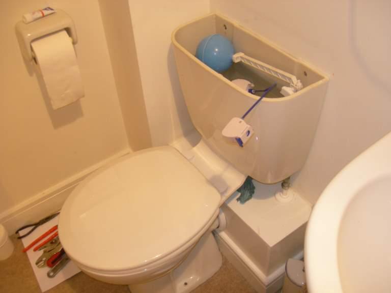

Well, thanks to you guys, I summoned up the courage to replace my dual flush valve, which has been dribbling into the bowl for a long time. Managed to get everything back together again… all OK till I flushed it, when water poured out all over the floor, from between the cistern and bowl.
I was careful to make sure the rubber ring between the cistern and bowl was in place, and tightened the wing nuts, but not too tight. So I took the cistern off, all seemed to be OK, so I turned the ring upside down and tried again – water everywhere when I flushed (OK up to that point, so it’s only when it flushes – I assume that means it has to be the big rubber ring).
What am I doing wrong? Or should the ring be replaced when you separate the cistern and bowl?
If I do need a new ring, what do I ask for at the plumber’s suppliers?
I’ll try and include a picture of the toilet…
Thanks :oops:
You also get a foam doughnut these days too but if your one is the one with the backplate etc then Denso's is the one you need.
If you are getting water ****ing out when you flush then the doughnut isn't sealing. They get ridges etc pressed into them when you fit them that are nigh on impossible to get exactly right when removed and put back together. You do need to make sure that it is well centered when you put the cistern back down otherwise it won't make the seal.

Usually the foam ones don't have a backplate
If yours has a plate then it should be a soft rubber with one flat side and a rounded side like the one from screwfix, flat side to the plate.

1st thing, get a bucket, that will allow you to use to toilet until you get this fixed :)
How was the plate attached when you took it apart? it should have been held to the bottom of the cistern by the big plastic centre nut of the flush valve, the bolts then hook into the slots on the end?
If so then as dhutch mentioned, time to silicone the lot.
1. Take the metal plate off, take the flush valve out and take the rubber seal off the end.
2. Clean and dry both sides of the washer, the valve and the bottom of the cistern.
3. Put a bead of silicone on one side of the washer and refit onto the flush valve. Another bead of silicone on the other side of the washer and refit valve into the cistern.
4. Put some silicone on the flush valve outlet where it sticks through the underside of the cistern and some on the side of the fixing plate that sits against the cistern and reattach it with the flush valve nut, nice and tight.
5. Put some silicone onto the flat part of the doughnut and use that to stick it, centralised with the flush valve opening, onto the metal plate.
6. Put some more silicone on the edge of the flush hole where the doughnut contacts the base and then place the cistern onto the base, then tighten the wingnuts to draw the cistern down nice and firmly and make sure it pulls down level.
Make sure all the surfaces that you will be putting silicone onto are clean and dry. Leave it for 15mins before turning the water on to fill it and then give it a try with your fingers crossed .
