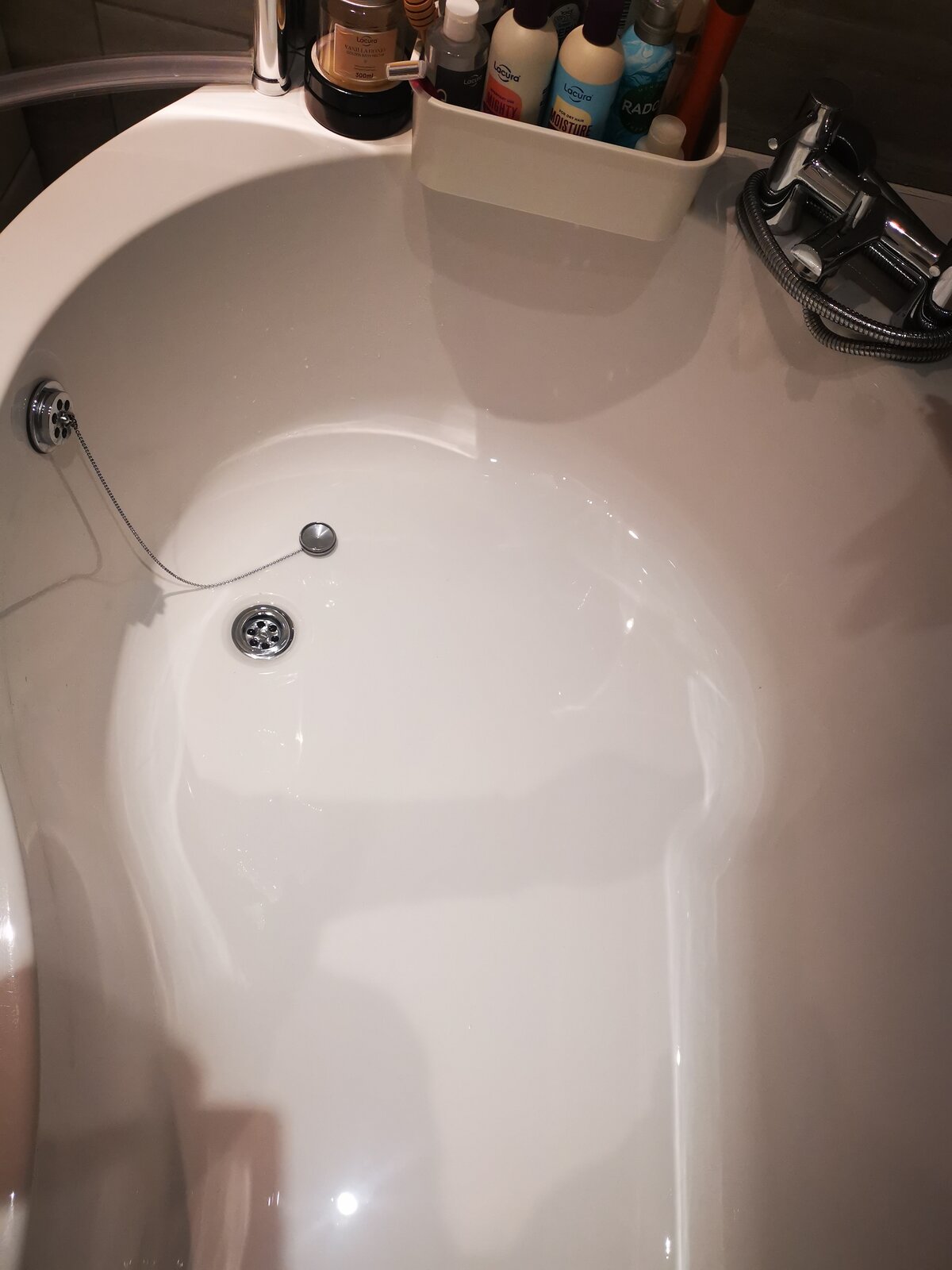

Leak under bath
Looks like you have loads of space under that bath - unless that waste pipe runs to a hopper or an open gulley then you really want a proper bath trap on that and not a shallow trap, to avoid self syphoning

There are 2 places that the leak could be coming from - The bath trap connections or the bath waste/overflow
Bath trap > 1716194351911.png Bath waste> 1716194403869.png (click to enlarge)
The shallow bath trap seal via the 2 nuts either end - the white plastic U bend with the white plastic nuts either end, - the right hand one has a round flat rubber washer into it and tightens onto the bath waste (black threaded section that runs through the bath and is the bit that the bath plug goes into inside the bath) - the left hand nut then connects the trap onto the 40mm Waste pipe - a round conical shaped rubber seal and a plastic thrust washer.
As was suggested, you need to disconnect that bath trap off from the bath waste - right hand nut - towels/container below to catch any water - and then disconnect the left side nut and take the trap off of the waste pipe. Note carefully the way the rubber seals are sitting at both ends when you take it off. Ideally you'll replace that U bend as the one you have isn't very good - replace with one of these > McAlpine Bath Trap
Next you need to check if the bath waste is sealed to the bath tightly. That would be checked by checking to see if the screw that is inside the chrome plughole, inside the bath, is tight. Then you need to check if the overflow pipe under the bath - corrugated pipe that runs down from the overflow and connects on to the black waste section. Just make sure that's pushed on tightly.

I went to the local plumb shop and in the end they recommend I just get the trap. Then come back if that wasn't enough.
I changed that over and tightened the plug as that was loose and all seems to be ok!

Hey yes it's been fine since I changed the trap and tightened up the plug. Thanks!
