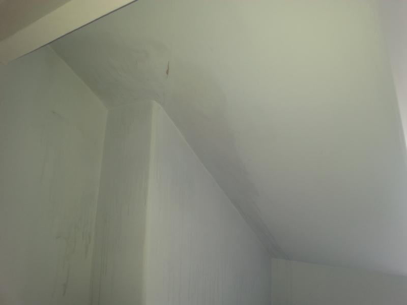

We live in an Edwardian mid terrace and have a leak in our upper front bedroom adjacent to the chimney stack we share with our neighbours.
Despite two separate roofers replacing the lead flashing around the stack, repointing the stack fully and re-doing the channel between ours and the neighbours' tiles, it's no better.
It's seeping rather than leaking and is noticeably worse after it rains and leaves a sticky, slightly dirty residue once it dries.

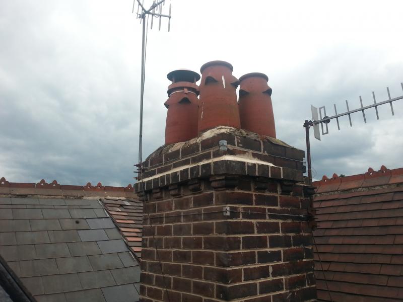

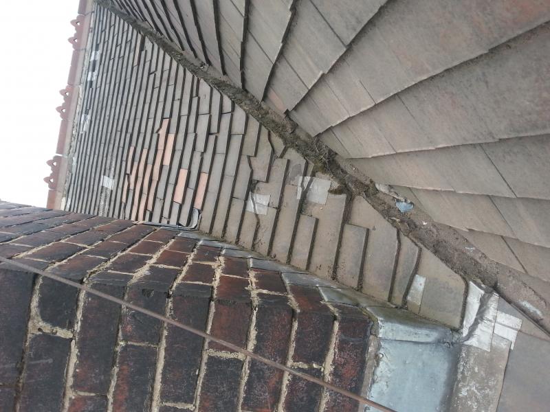

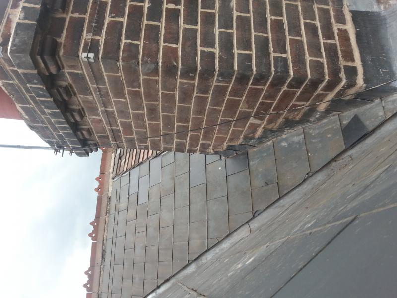

Sorry, I'm new to the forum and not well versed in roofing lexicon. I've attached photos as you can see. Mine is the slate roof and the neighbours' is the other one with ceramic tiles. It is indeed a bonding gutter between the two roofs.
Thanks for the pics.
A Bonding Gutter cannot be seen - in pics 1 & 3 the plain tile seems to merely sit on your fibre cement slate, i dont even see any sign of pointing mortar . Who said that you have a Bonding Gutter? Maybe i cant see it?
A pic from behind the stack where the "Bonding Gutter" meets the stack back gutter would help?
In pic 1:
you have a lead valley that looks very flat. The slate corners are snapped off perhaps due to careless workmen. Fibre cement slate is very fragile.
your side of the back gutter is wrongly detailed and might be discharging water below the flashings.
presumably soakers are present below the stepped flashing - a soaker(?) has detached and dropped.
In pic 2:
the neighbour'sd valley is due for re-newal and much of his plain tile roof.
flashband repairs have been made.
the backgutter on the neighbour's side can be seen to be discharging water in a more correct way.
In pic 3:
the top right corner of the stack brickwork is missing and might be allowing water into the flues?
Roofers should give before and after pics to customers. Why not show the returning roofer what i've said and ask him/her for comments?
You will have to work with your neighbour on this - its got to be a joint effort.
