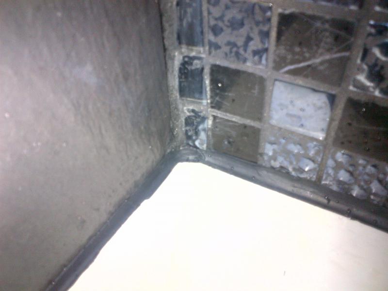

Are there any tests I can do myself to check where the leak is from, before I get a plumber round? As its in the loft, the shower (mixer) pipes go through the tiles at the back wall (with mosaic tiles per picture) and I cant get access behind there to check leaks. Maybe pour water down the drain to see if it is the waste pipe rather than water getting behind the tiles?
1 - the leak is not directly below the shower tray in the en suite - not sure if that means its more likely to be the drain rather than water getting behind the tiles?

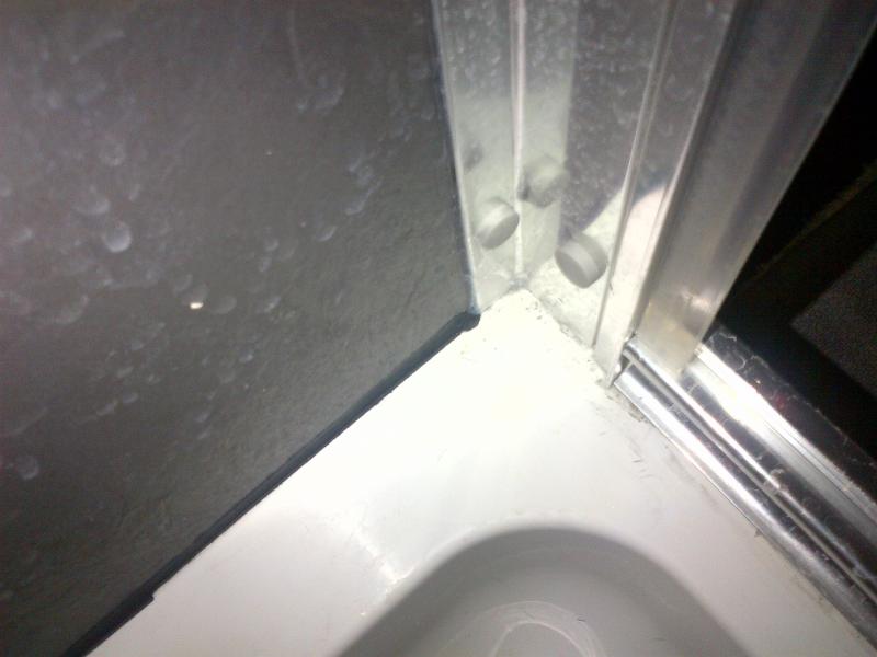

2 - I don't know if the tradesman I paid used sealant before applying mastic around the edges where the tiles join the shower tray (see pictures)
3 - the shower tray was not replaced (can't see any visible cracks

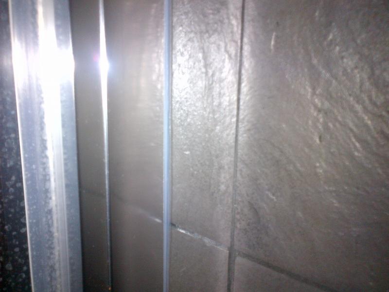

4 - Only drips through the light switch when I have a long shower, tiles are 60cm x 30cm so not many grouting lines.

Hard to tell but one common problem is not sealing the wall to tray joint before the door is fitted. This leaves an unseen gap behind the bottom of the door wall posts. Maybe let the shower run for a while, with the head in the tray, and at least rule out a leaking trap/waste?

Inspect all shower wall tiles grout to check it is sealed and covered.

I think he used mastic stripes wound round with the backplates over the top (difficult to be 100%) one of them does not sit flush to the wall but I question whether the amount of water I saw last night could have come from back-spray? Regardless will definitely need some clear sealant around both to be safe.

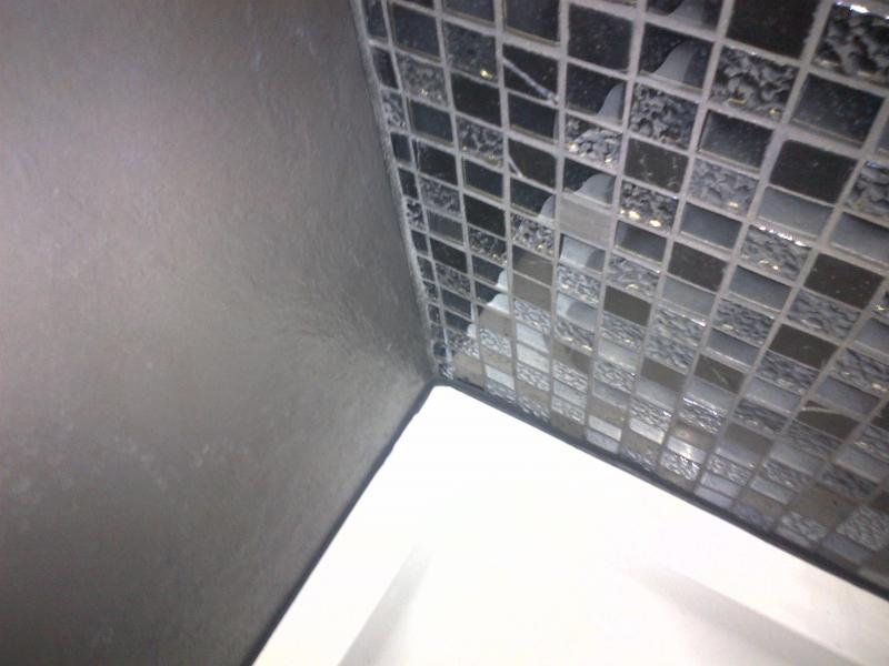

The remaining possibilities I guess are more difficult to pin down...took a few more pics , guess there's either a crack in the tray (its plastic white so difficult to see) or its sealant-related somewhere?
Point the shower at the door only and let it run for a bit.
Difficult but probably a case of working round the tray with the water - trial and error. Is that black silicone round the top of the tray?

Its mastic tape round the top of the tray - again I don't know if the installer used sealant to join the tiles to the tray before putting the mastic over the top....
I guess if I just do one of the 3 walls at a time, should be relatively easy to spot where the leak is - (from the pics) I dont like the look of the ends where the door bars meet the tray - can't feel with my finger so cant tell if he put sealant on the tray-bottom of bar....you can see the mastic stops where it meets the door bars in the corners.
You could try and pinpoint the leak but I'd be inclined to remove the 'mastic tape' and seal it properly with silicone. You can do that without to much trouble.
