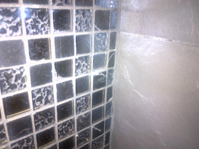

So its clear that the stupid 'mastic strips' the "professional" used are useless, after I peeled away could see the grout behind it (although neatly done) showed signs that water had been absorbed.
Got everything I need to properly seal, just a final few questions.....
1. told not to put sealant over the grout on the two vertical joins where the 2 tiled walls meet the mosaic wall - can I confirm this is correct? Seems odd as grout is not waterproof- or should I try and remove the grout and replace with sealant? (rather not unless its a must)
2. My shower door is Aqualux - I'm also told the inside horizontal (where the bottom of the frame meets the shower tray) should not be siliconed - but the person I hired has used something (again looks to be some sort of cheap clear plastic tape) - should I remove this?
3. Was told to silicon the verticals (where the shower door frame meets the tiled walls INSIDE and OUT, and the horizontal (where the bottom of the shower frame sits on the tray OUTSIDE only) - sound right?

1. I use silicone down the vertical corners as well as there can be a bit of movement there. Not essential if grouted properly.
2. Correct, remove anything on the inside.
3. Correct.

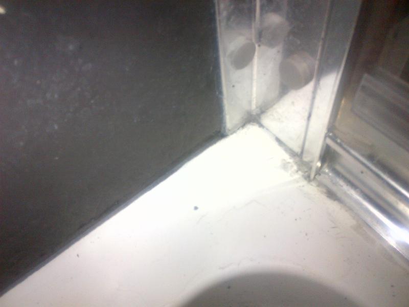

So, took an entire weekend but removed the shower door, all the mastic tape and did the following:
1 - re-grouted the entire shower (looked fine anyway, but to be 100%)
2 - freshly siliconed the tray-wall and vertical joins with Mapesi sealant
3 - scraped off all old silicone from the door bars and re-fitted the shower door
4 - per Aqualux specs sealed the outside verticals and horizontal (where the door sits on the tray)
Ran for 15minutes on the walls (both sides), directly at the door, and directly down the plughole - not a single leak
As soon as I got in the shower (thinking the saga was over) it leaked.....
Worth noting when I sealed, I weighed down the tray before sealing to cover movement.
Not sure if this means its the drain/pipework underneath the tray, or the tray itself (no visible cracks) but Ive gone as far as I can go.
Only thing stopping me calling a plumber is Im not sure they can check much with the small gap underneath the tray (see pic) and id rather they didnt rip my bathroom ceilling off for access.....
