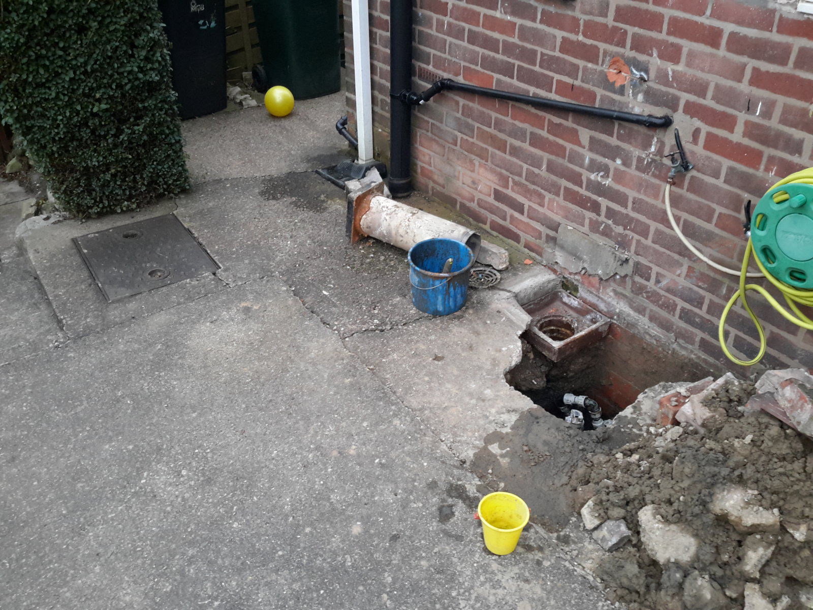

Today I've diverted all the drainage to the soil stack. Got a bit peed off when I realised none of my push fit stuff would fit onto the solvent weld pipe sticking out of the walls. Anyway another trip to the shop and I've solvent welded it all up. No more water is going down this gulley. I will be removing it.

Do you know for sure that the nearby soil stack is not also broken? Most likely at the rest bend.
If your hole fills with warm water after a bath you can get your spade out again.
I don't fancy digging the concrete out around the stack. If it isn't damaged before it will be afterwards. However the stack is only about 1.2 metres from the IC so wouldn't be a big job to replace the whole run.
I'm still of the theory that this water is in the ground. I've just been out 24h later and the water was level with the top of the meter - where it always settled before. I've emptied it out again and dug a little deeper. I've exposed the square plastic bottom on the meter chamber now.

You might have a leak on your rising main, stick some food colouring in some water and stick it down each of your internal wastes.

I've just chucked some red water down the sink and we'll see if it emerges in my hole.
For perspective here's a photo of the area. There is no other drainage nearby. The far gulley and the soil stack join together prior to the IC.

Well I never. There's red water in my hole. Well, a very faint bit of red amongst the black. I cant believe it. I'm going to have to dig out the rest bend. Thats a whole new world of pain. I'm tempted to dig out the whole patio and replace the lot. If a jobs worth doing . . . I also want to look at the other gulley to check it isnt broken, though this may become apparent when i dig out the stack as they are close by.
Could be your house has settled slightly and broken off all the rigid drain connectors. That's why nowadays it's all bedded in pea gravel and rocker joints. I'm thinking your long term plan might be the best idea too. Bad luck.
It could be leaking at the rest bend or after the manhole.
Best if you check from the manhole down with a different colour.

The water flows from the manhole away from this gulley. So that'd be going even further through the soil. And uphill. No, I'm fairly sure its the length of pipe between the soil stack and the chamber.
As you've said Steve, I'd allow for changing that other gulley too whilst you've got the hole open, chances are the old pipework is at the end of its useful life. Replace the lot back to the chamber, and give yourself peace of mind it's sorted. They're pretty close together, so chances are you'll disturb the gulley whilst digging out for the stack anyway.
