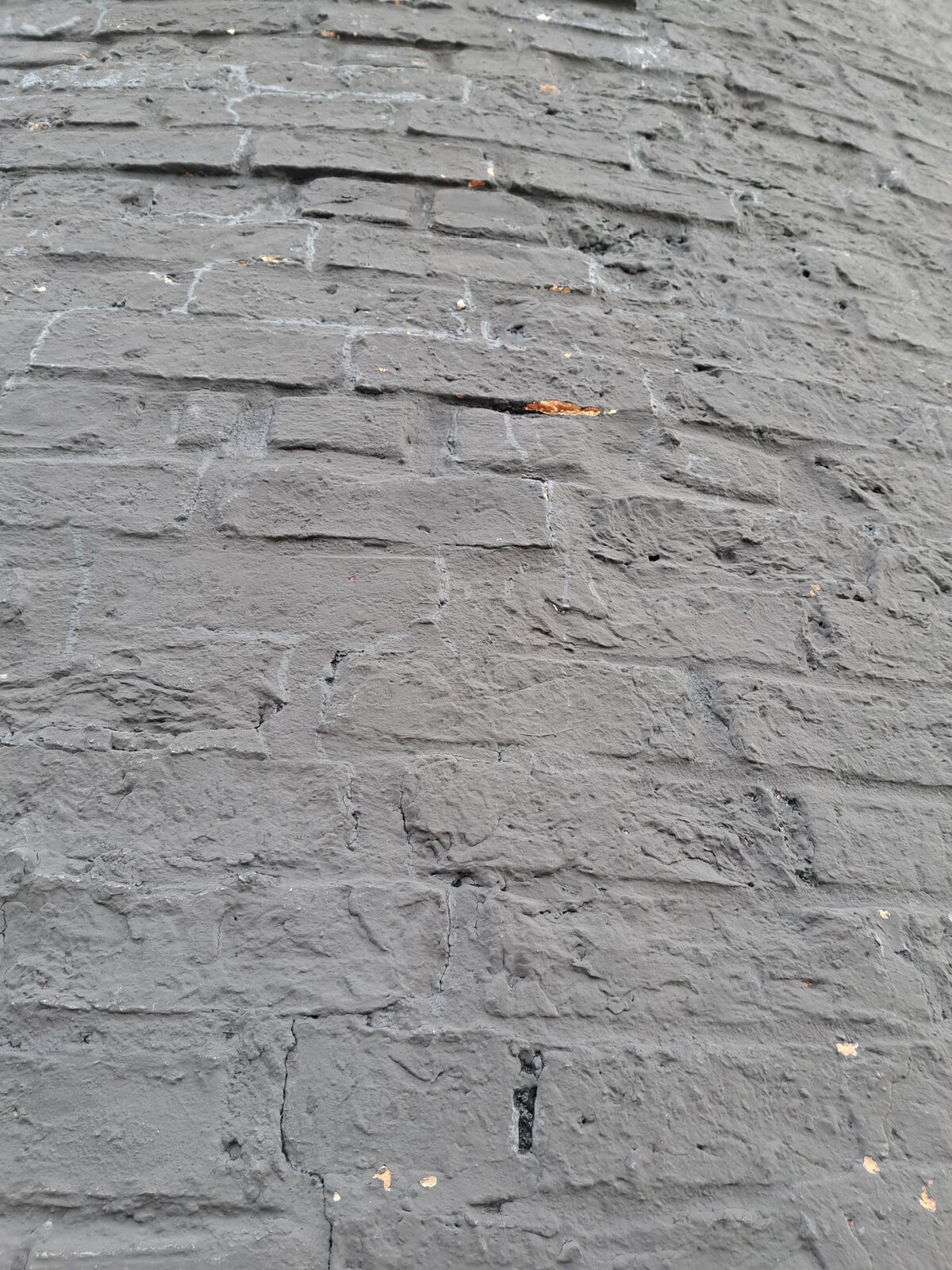

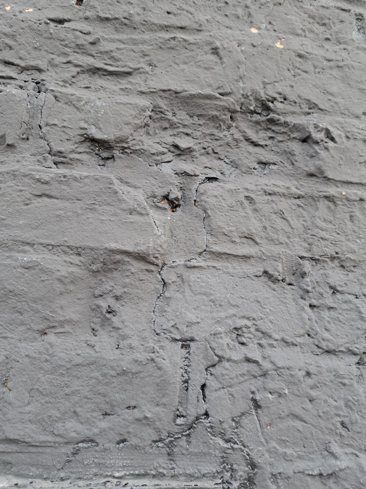

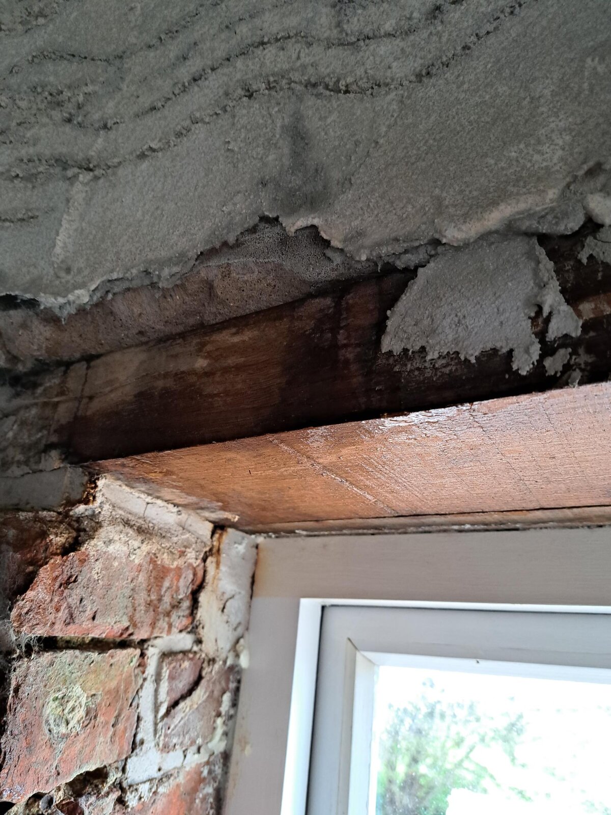

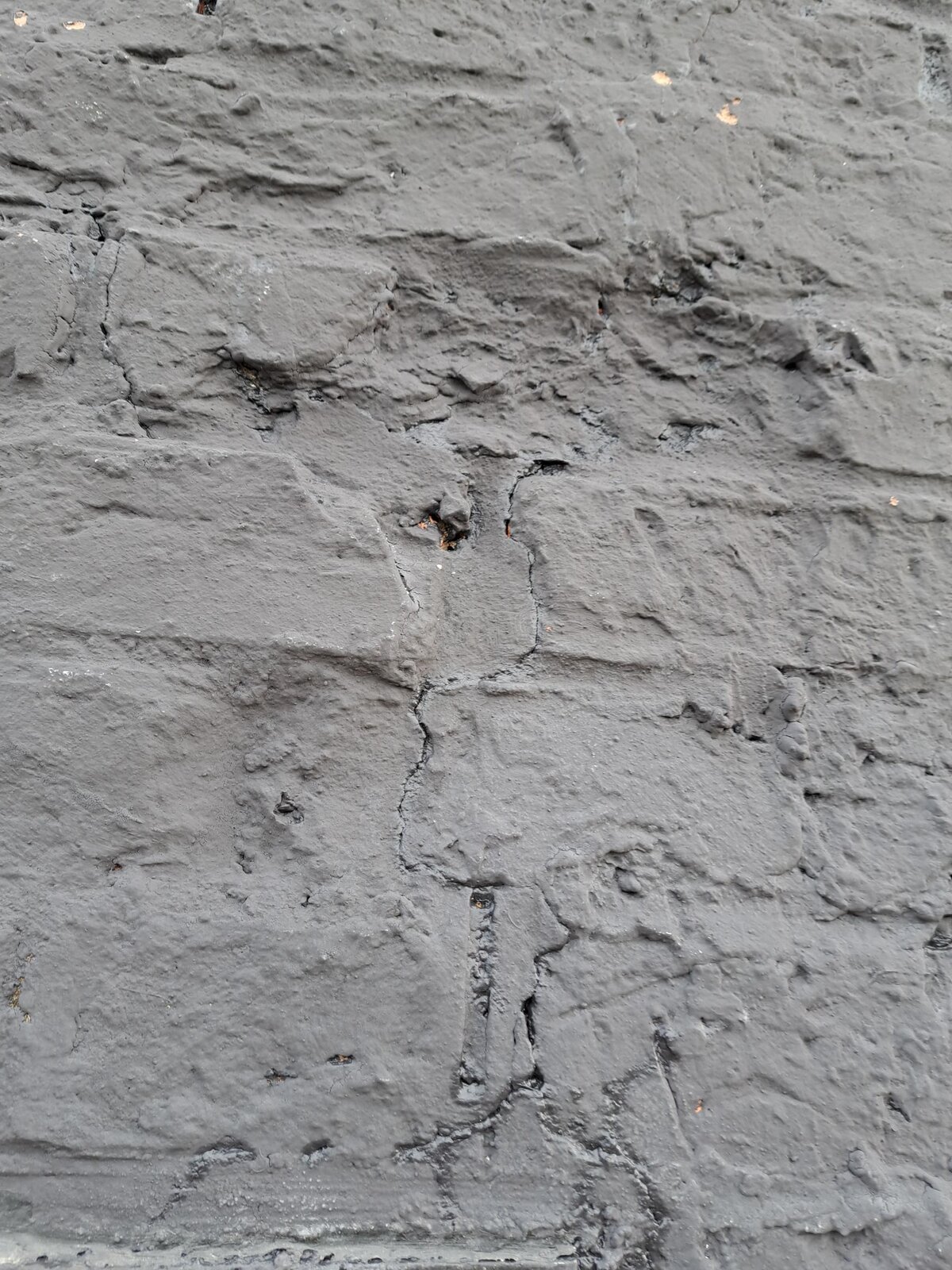

I am restoring a grade 2 listed windmill. It has had all the window openings rebuilt with new oak lintels. I have two windows that are leaking where the lintels are. The lintels are flush to the brick work and have been sealed on the outside but water is still coming in. Is it the brick work? justed spotted a hairline crack in the mortar where the bricks were replaced.
Why not post pics showing the inside and the outside of the window openings with leaks - show detail and larger context.

Thank you for posting some images.
did you have any pics of the lintel / head of window externally? - I presume the lintels are visible outside?
If they are oak lintels just set into a solid wall, with no damp arrangement, I’d be interested to know why the architect and builder thought it wouldn’t leak. You have brickwork which has no cavity and has faults because it’s an old building. Water ingress around the lintel seemed to me a highly likely outcome.

Thank you for the pics but more pics are needed showing larger context's inside and outside, and a much larger view of the outside walls.
Whatever has been smeared on the exterior brickwork is not in keeping with Grade2 or even acting as a damp barrier. You dont seal the brickwork.
No pointing seems to have been done and bricks are flaking, spelching and cracked.
