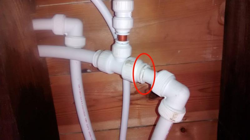

I am having an issue with a leak in the area highlighted in red on my central heating system. It was installed 18months ago (from above) and a few days after I noticed a reasonable leak from that connection, got the plumber back in and it seemed sorted. Pulled the kitchen ceiling down to renovate and noticed it has a very slow leak in it. I haven't actually seen water drip from it but it forms between the plastic and if wiped away it reappears.

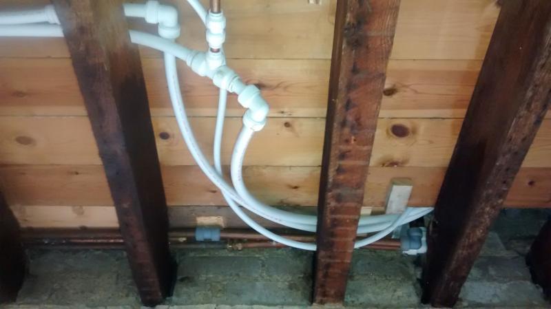

It seems to me that there is a lot of pressure on that connection due to the bend of the pipe (it also goes slightly below the joists when the ceiling isn't there), is that a correct installation?

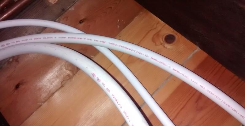

I am trying to decide if the issue is something I want to tackle or not. How do I identify what brand those fittings are?
