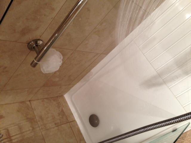

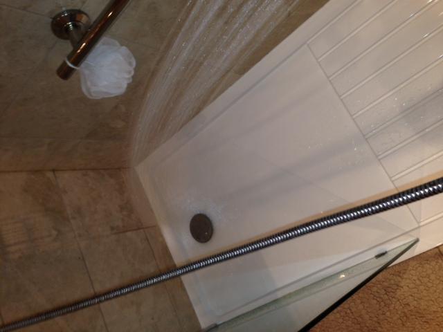

I'm still thinking there is something majorly wrong with hot water getting from the tank to the shower. Water flows fine for about 15 - 20 seconds then reduces to half and tails off slowly over the course of the shower. Cold water is strong and consistent and am happy with that and it uses exactly the same network run of 22mm and 15mm as the hot.
I'm wondering if the HW flow problems (how are you judging that?) might be down to a dodgy shower valve?
I'm judging the hot water flow by holding the hand held unit as far away at the end of the shower tray aiming towards the drainage hole (the shower tray is 1400mm long). If I continue to hold the unit the arc of the water gradually reduces in pressure and moves closer and closer to me until it almost reaches to nothing.
If I do the same test with the cold water it continuously hits the drainage hole and does not creep toward me at all.
