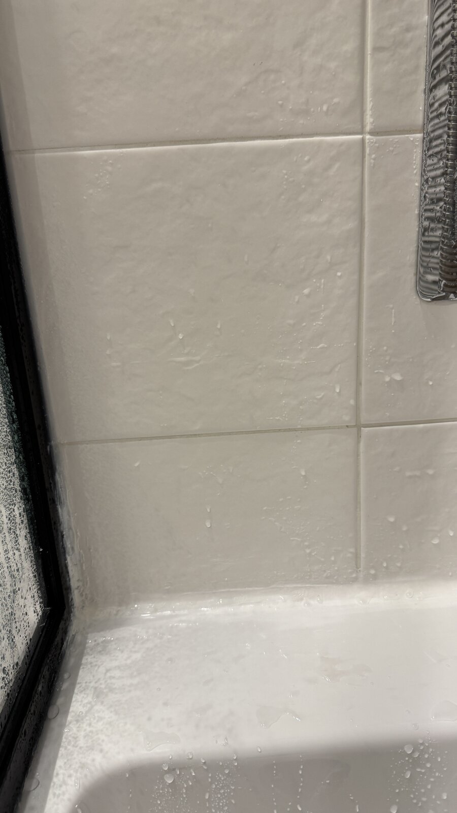

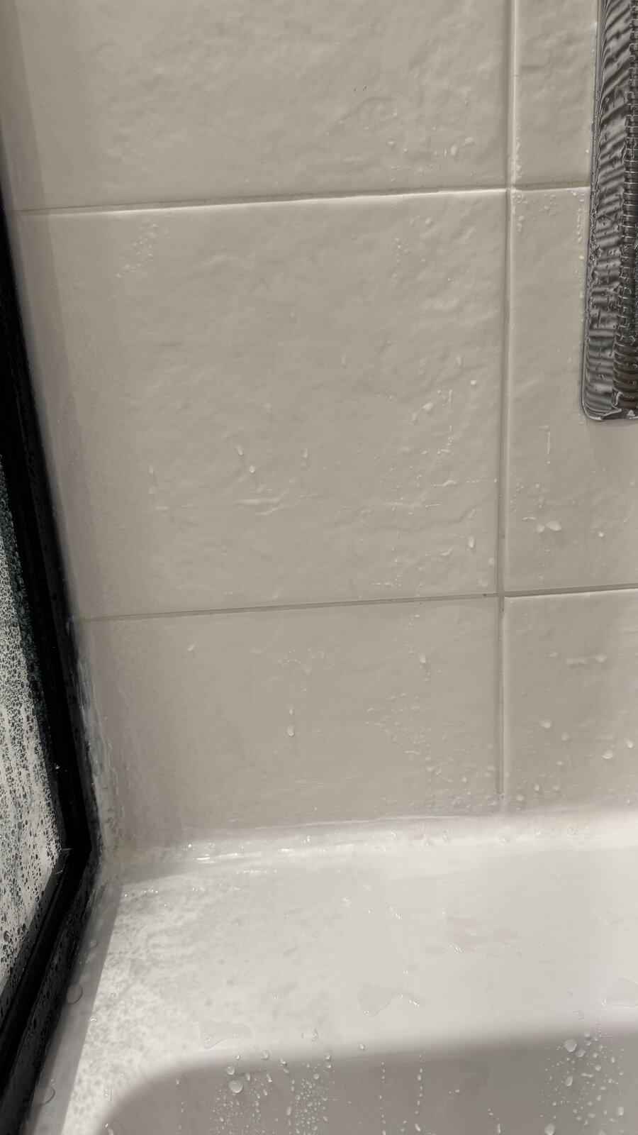

Can anyone help. Our shower is leaking I’ve removed the bath panel and it’s dripping. When the shower is turned on it does not leak it’s only when you spray it on the tiles. I got someone out who removed all the silicone and replaced it all, it’s still leaking, he came back and removed the corner section but it’s still leaking. If I spray water up to the top of the silicone it doesn’t leak but as soon as it hit the tiles it starts again. He has been out again and taken the silicone higher but it is still doing it as soon as it hits the tiles. The grouting is all fine we are totally confused. The guy says he will come back again and strip the whole lot out but I can’t see how it would help. Has anyone come across this before? Any advice would be gratefully appreciated

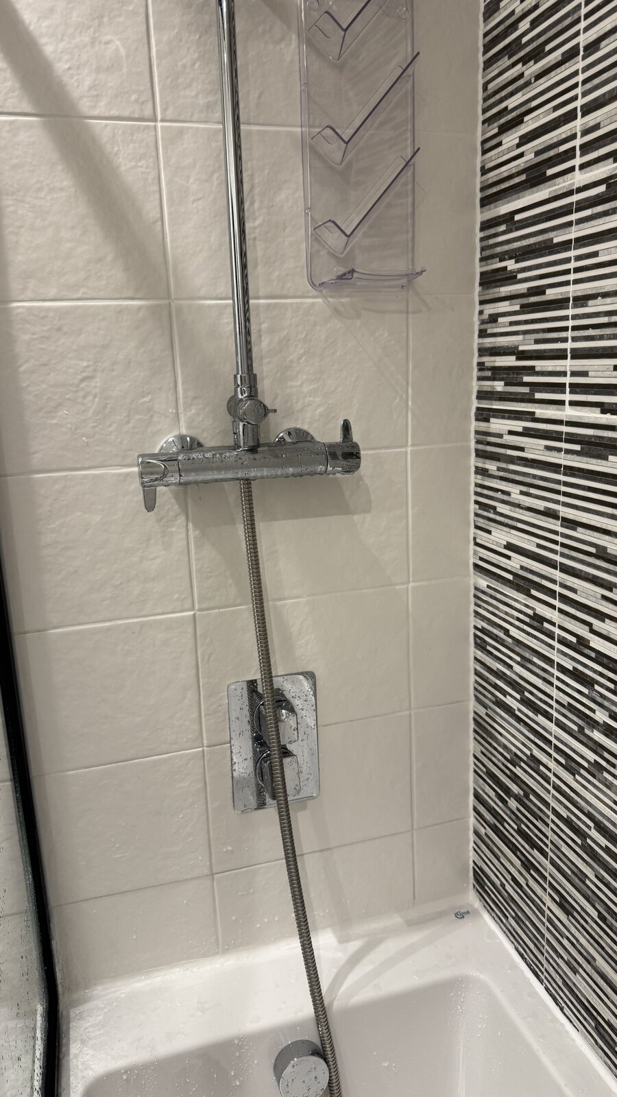

The house is a new build and didn’t have a shower over the bath we got a shower put in and now I’ve got a horrible feeling they just plonked the tiles straight onto the plasterboard

Wow that silicone is a sure sign he is not very capable, that silicone joint should only be 2-3mm or thereabouts. Where is it leaking from underneath? Are you saying it only starts leaking once you spray into the grout lines?

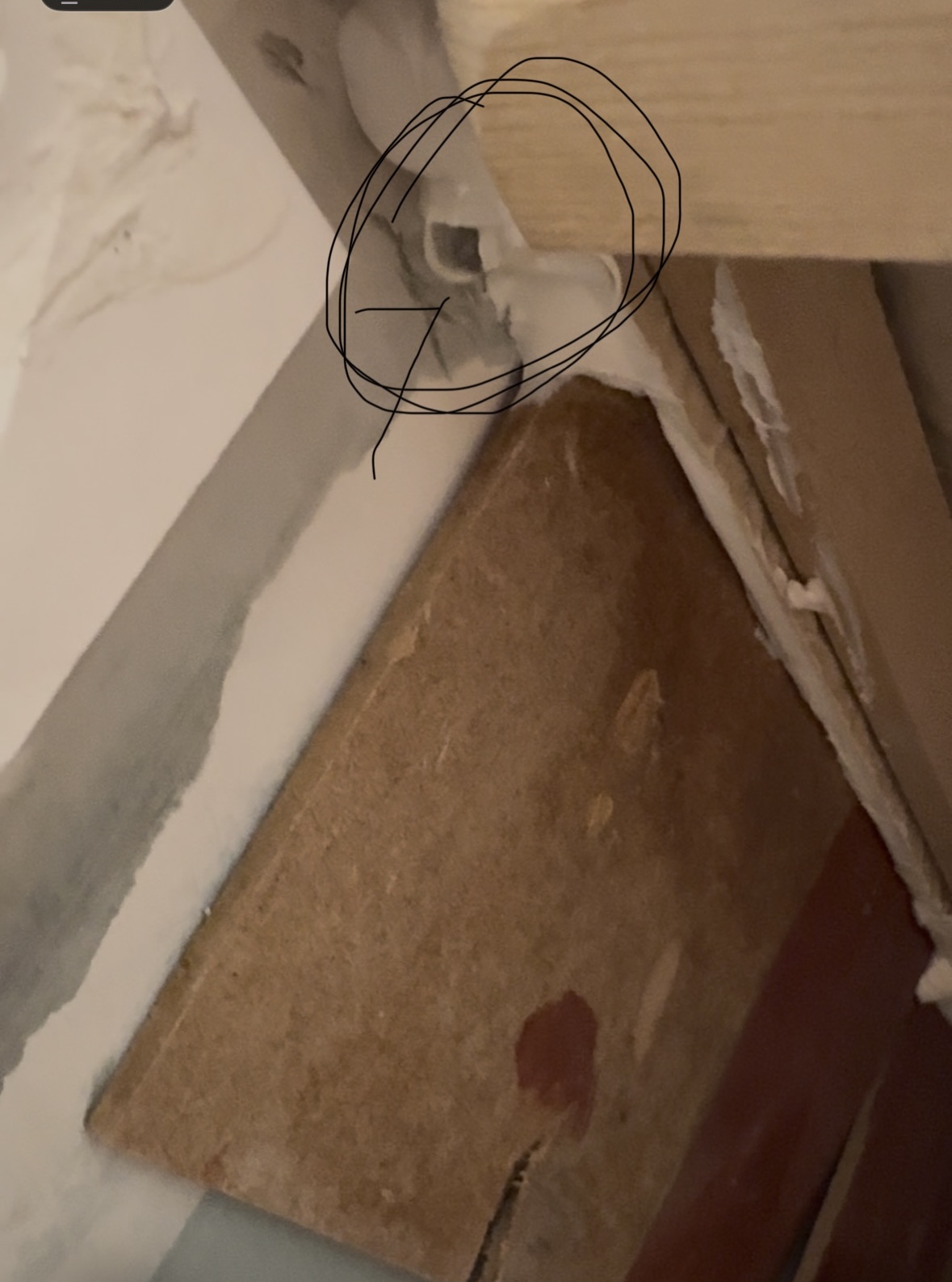

Yeah it’s leaking underneath. He did put a small amount of silicone on then took it all out and put a deeper layer.
As soon as I spray water straight onto the tile that’s when it comes through, I’ve even just sprayed it on to the tiles directly making sure I didn’t get any on the grout and it comes through immediately. Would water come through instantly as soon as it hits the tile?

Firstly, and I know I’m going to be controversial here, there is nothing wrong with tiling straight onto Plasterboard. IF the proper procedures are applied correctly, and the new Plasterboard is SBR’d, then the correct adhesive used and applied correctly, the tiles applied correctly, and the correct grout mixed and applied properly, then the resulting job will be waterproof.
Sure, the siliconing looks a bit messy, but the top leg and the bottom leg of it look stuck to the tile and bath respectively, so that’s not leaking. ( and the correct throat thickness siliconing tool to use is 8mm - forget the 2 to 3 mm nonsense)
I would say its quite obvious what the cause of the leak is here - if you look at the bottom 3 rows of tiles in the first photo, given the ‘lipping’ and the shadows it is throwing, the tiles around that lower valve are NOT STUCK to the wall.
Give all the tiles on that wall a tap with your knuckles - the bottom rows will sound hollow.
thank you for taking the time to reply I’ve knocked and you are correct the bottom 3 rows sound hollow compared to the others, pardon my ignorance, but would that mean we need it retiled?

Yes, the bottom half needs retiled. Now that we’ve established the ‘how’ is this leaking, we need to address the ‘why’ ?
It’s hard to say being remote, but my money is on that copper ( I hope ) connection for the lower valve being ‘ too proud’. The tiler is trying to help the plumber out, but the set up is all wrong. Unfortunately the bottom three rows, and the valve, have to come off.
