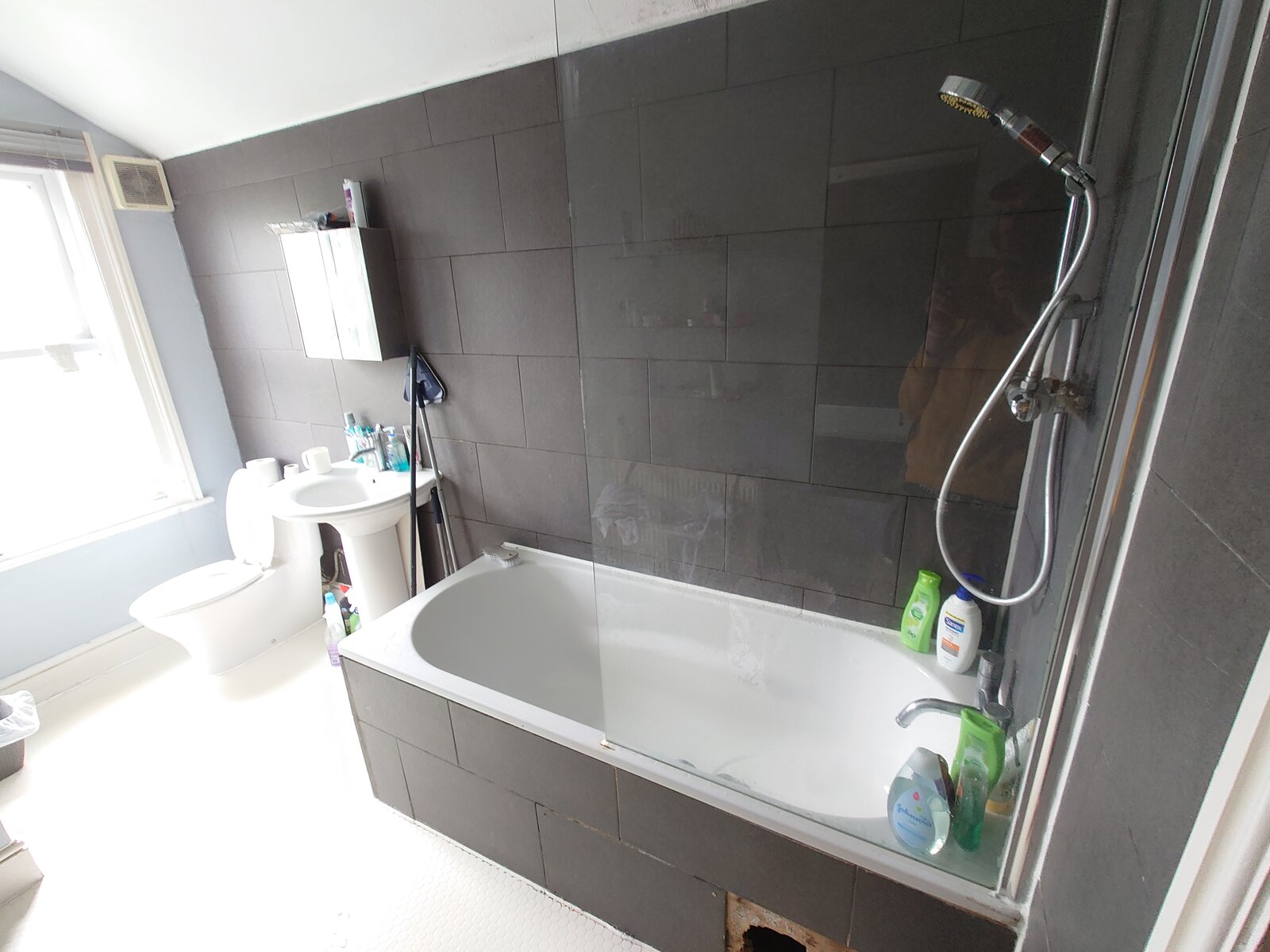

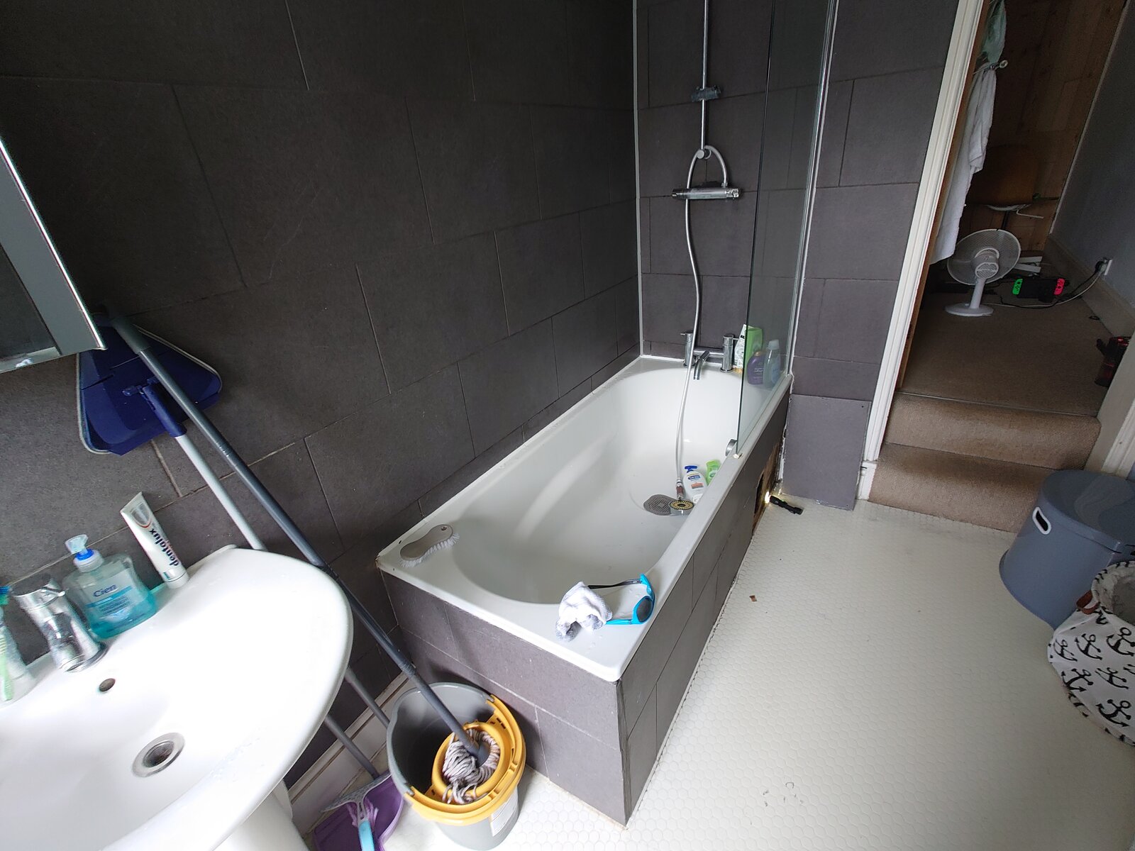

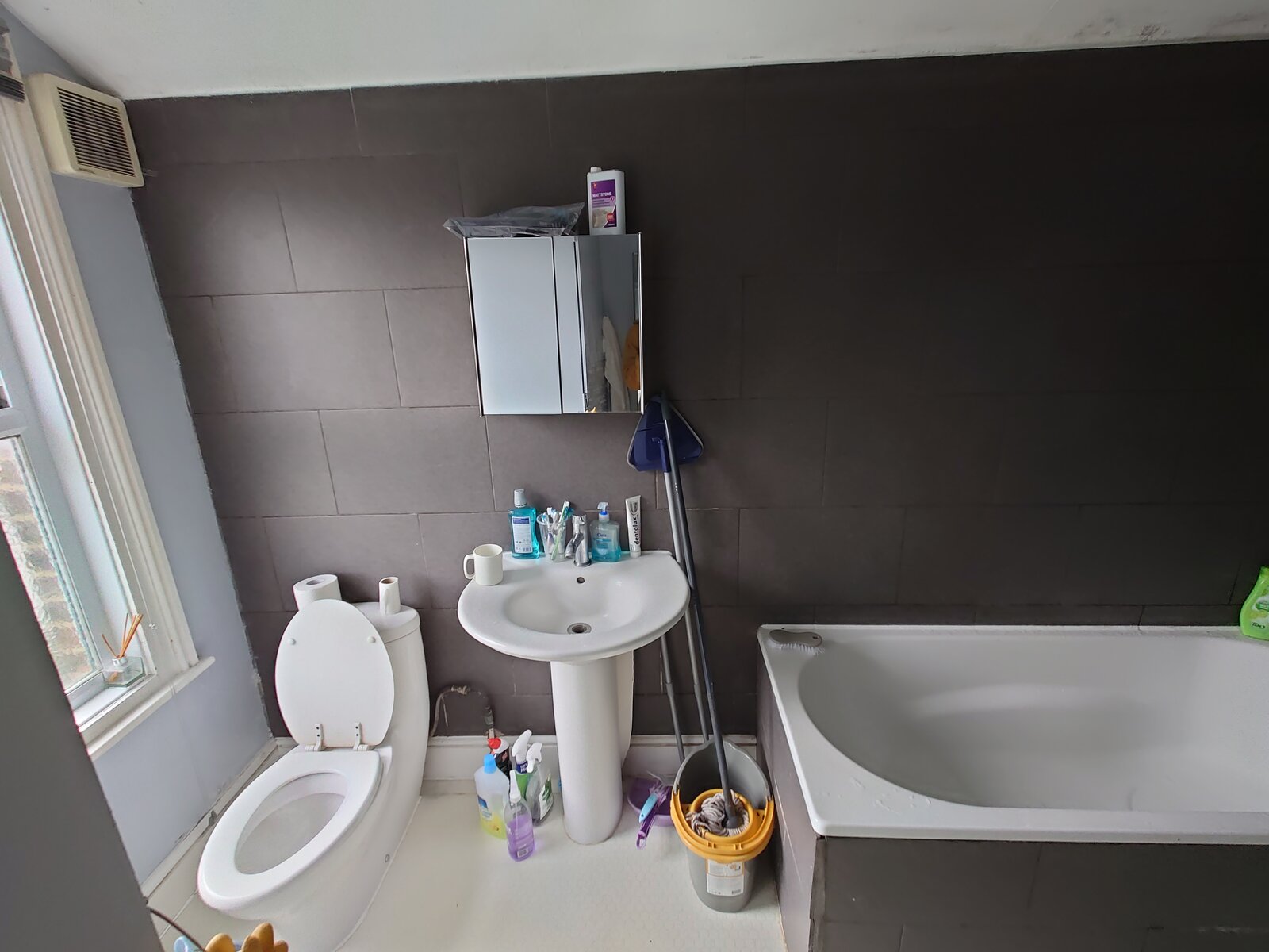

Hi again guys,
Sorry for the delay updating the thread, I have not been around until now.
So I tested the system for leaks by using a large bucket above my head and repeatedly filling it. There was no leaks at all, but on the tiles instantly...
So I am certain it is the tiles...
I have had the tiler around and he has suggested to either tile over the current tiles or use the waterproof boards suggested above again over the old tiles.
The shower is part of a large wall that is tiled over so he is trying to avoid doing the hole wall.
Due to the layout it will be more cost effective to tile not use the boards, as a lot of boards will be wasted.
Is this an ok plan to tile over the old tiles?
They have started to pop off the wall, but only slightly...
I would rather sort this properly than bodge, but if it is ok then I will proceed
