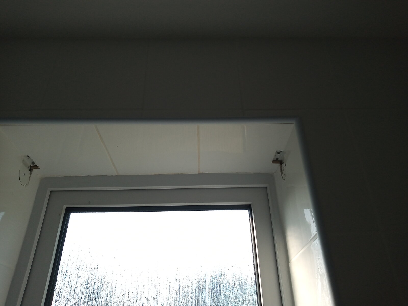

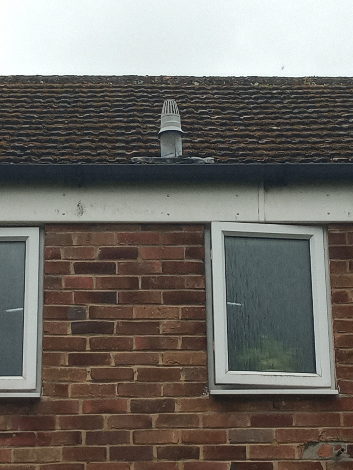

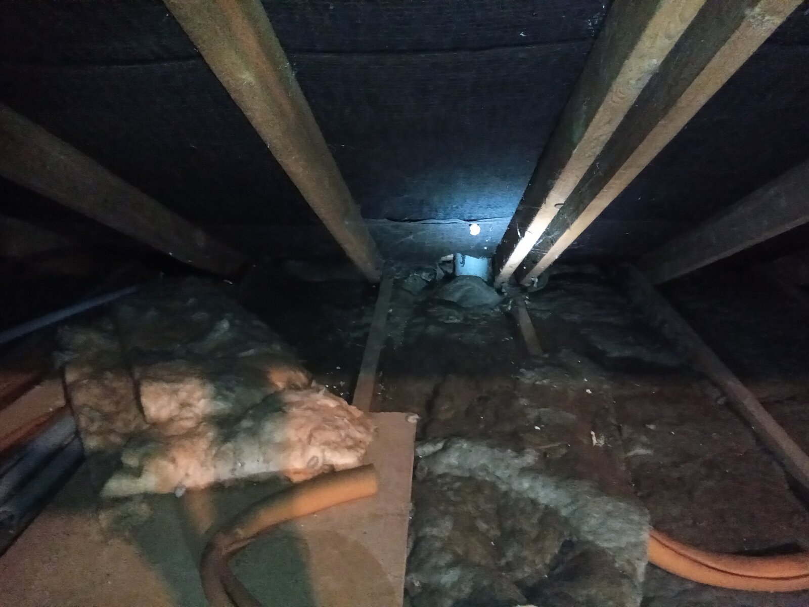

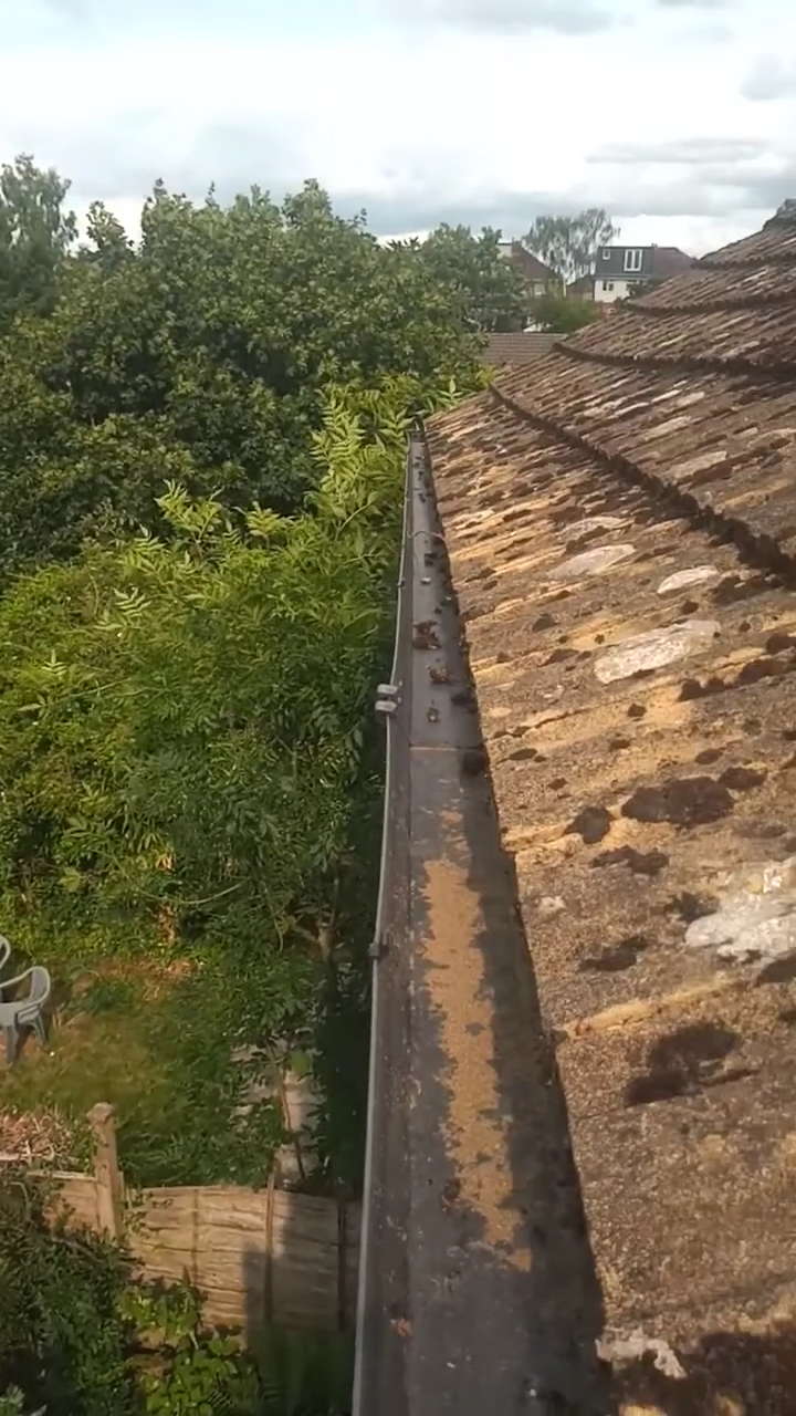

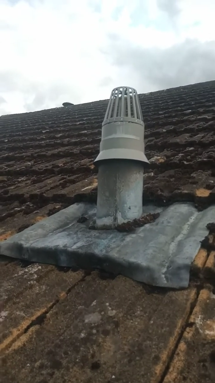

Hi, there was a downpour last week and we had a substantial leak which appeared to be coming through the grouting of the tiling at the top of the window surround in the bathroom, and similarly through the top of the window surround in the toilet, which is next to the bathroom. On the 1st floor of a two storey house, pitched roof. The attic seemed to be dry. There was some dripping from the inside of the gutter, but no overflow from the outside of it. There is a soil-pipe vent emerging from the roof, located between the bathroom and toilet windows, so I thought it might be the flashing. A roofer came round and said it would be the felt. He said there was streaking down the fascia board both front and back (not that clear to me, even in the photo). Would need scaffolding front and back and then they would remove the first three feet of the tiles, and hopefully it would be possible to replace that much felt. Otherwise they would have to replace all the felt. Said that in the last 15 years they have used something more durable (sorry I forget exactly what) for this last three feet before the eaves, and that this was a very common problem in older houses. But doing a search, I can't find much to confirm that. Another roofer is coming, so will get another opinion. From the geometry I don't think it can be coming through the window frames. Wondering if it is coming down through the cavity? Amy advice much appreciated, thanks.

Ask him how the water gets onto the felt .

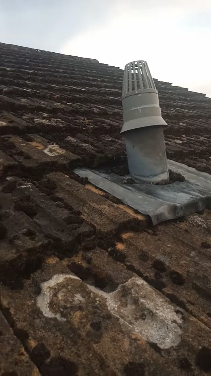

It's likely the actual point of entry is around the SVP .looks iffy but a closer picture might help .I'd ask another to look
ok to the left of the svp under the lead slate is a narrow cut tile . It is broken. this will allow water onto the felt beside the svp and run to the bottom until it finds holed felt.
there is very little tile over hang into the gutter. fitting of underlay support trays will help this.
id check the tile first....you can see it in the picture, i know its there and pretty sure its busted

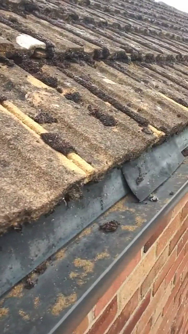

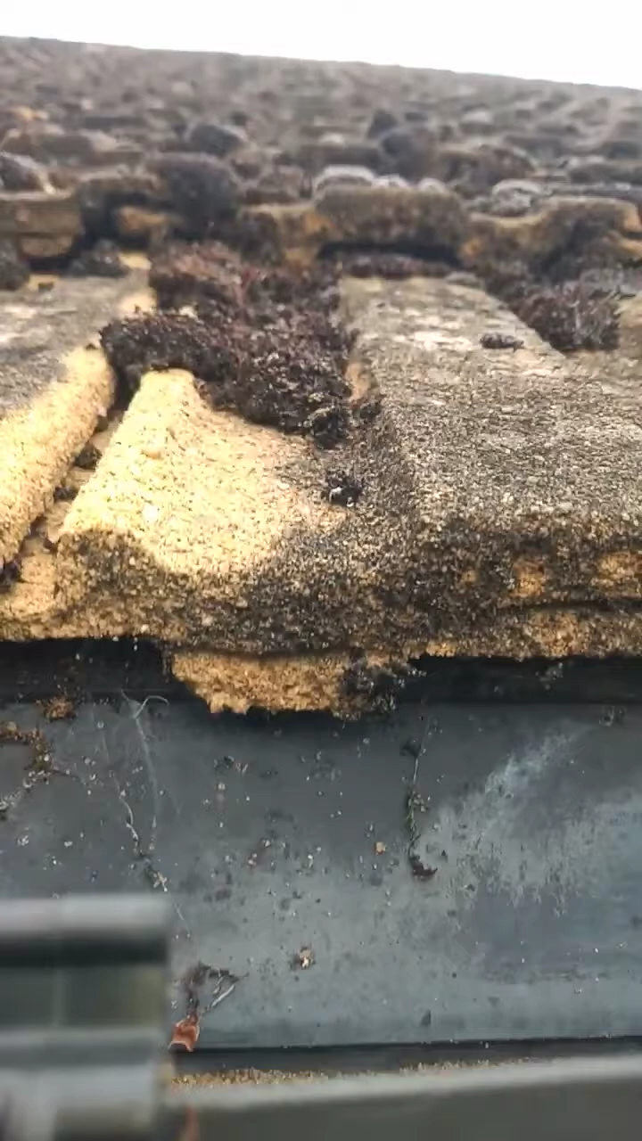

I suppose it makes a difference whether the underlay is overlapping the gutter. It looks like it is at the front:
Even in this case, I suppose if the gutter filled up then it would get behind the felt.

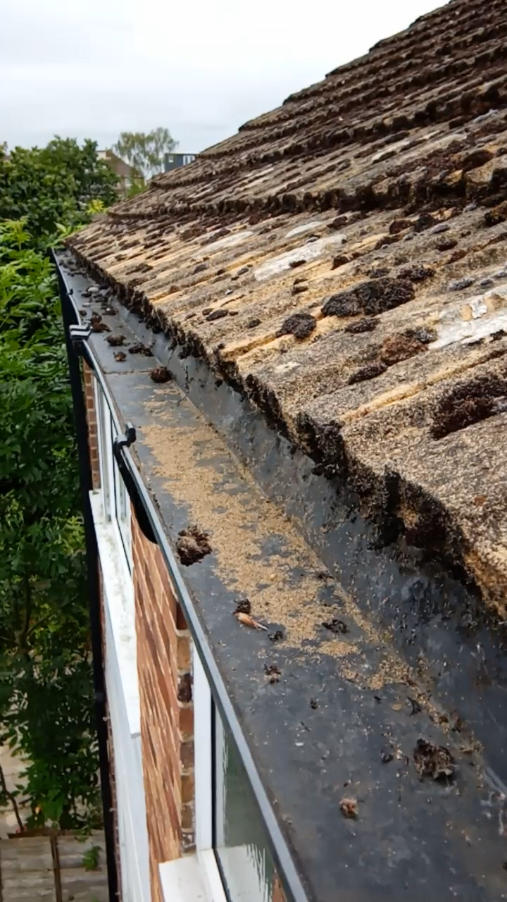

Although there are issues:
At the back, I can't see any overlap:
In places it looks like the moss is lifting the last tile up.
A roofer from an NFRC registered company had a look yesterday, ladder was just left of the svp, took several tiles up. Couldn't find anything wrong, said it was dry underneath, no sagging, good overlap into gutter, and the ridge looked fine. Gave me his number in case problem reoccurs. Odd - but I think I am happy to leave it like that, since at any rate it doesn't sound like it's in really bad condition, and I trust the guy not to create work that doesn't need doing. What should I be looking for next time it rains? Dripping down the fascia board perhaps?
