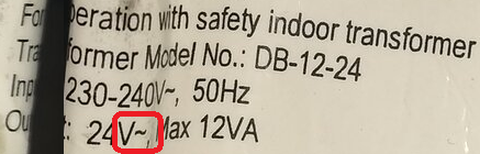

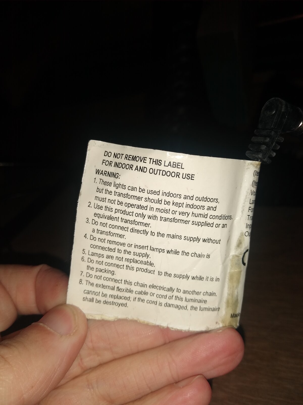

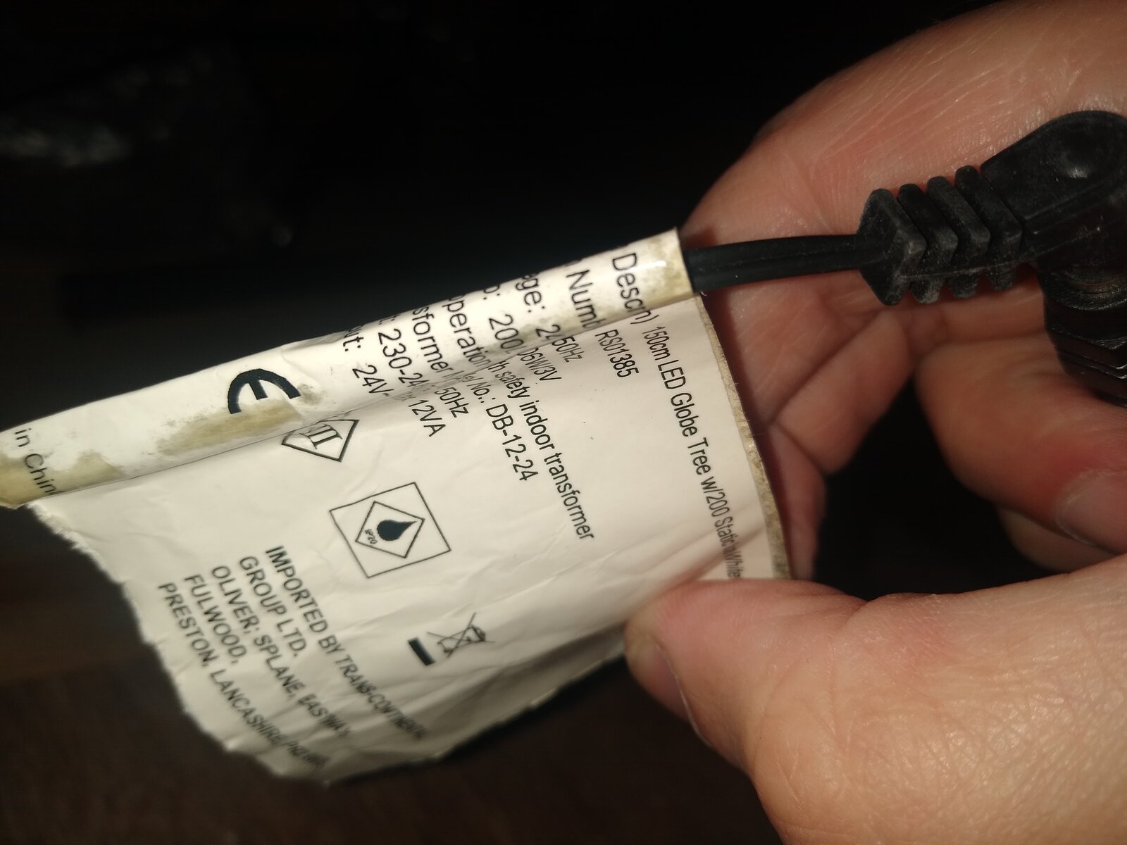

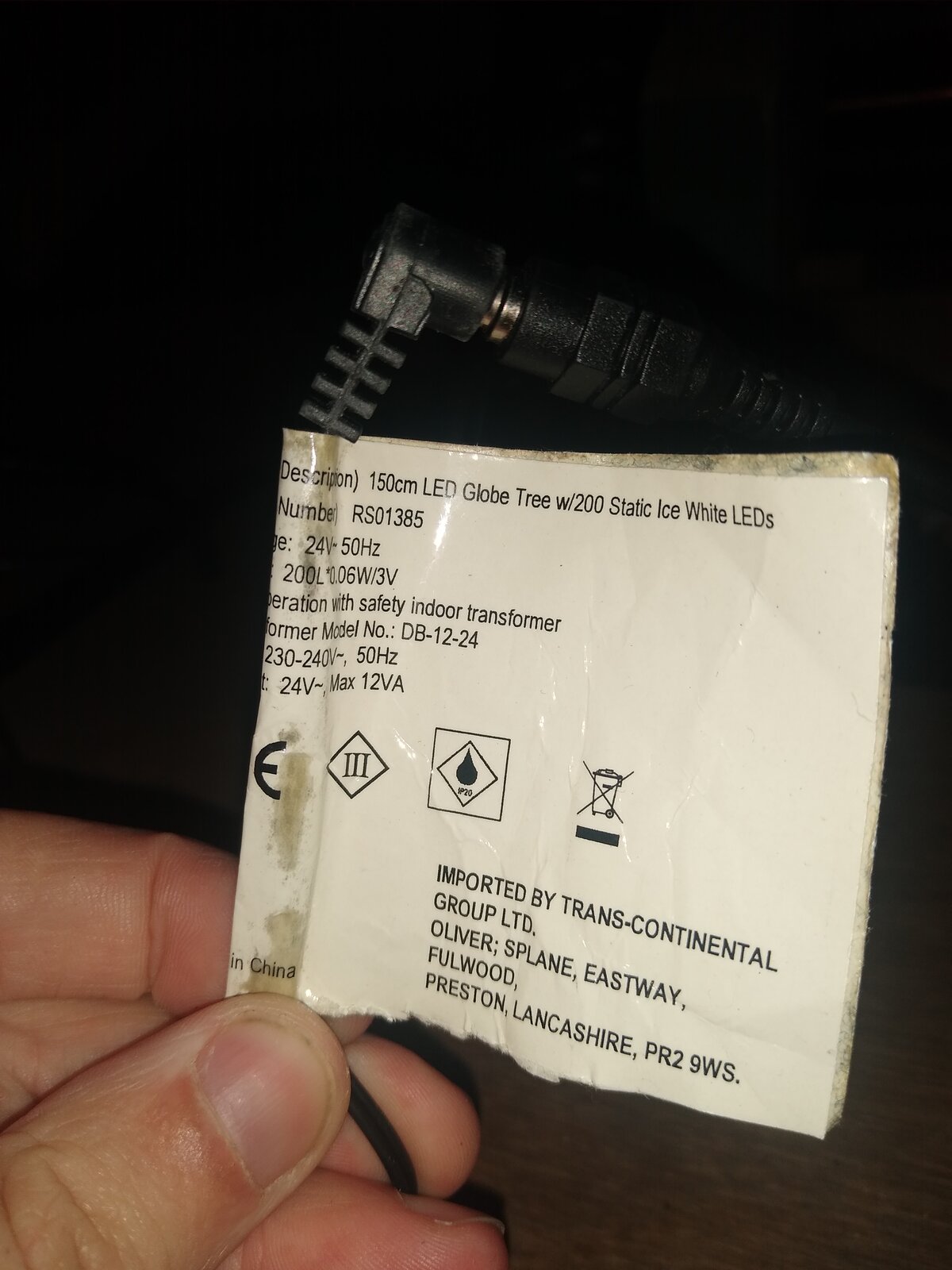

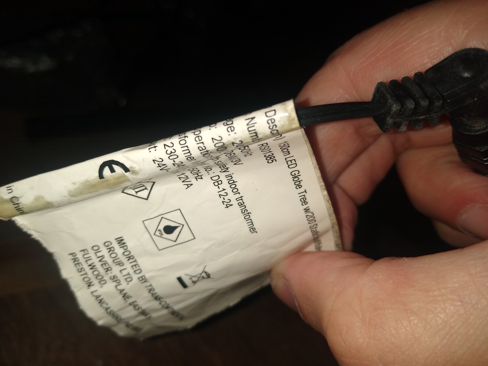

I have got a what could be described as a "150cm led globe tree w/200 static ice white leds rs01385" Christmas tree.
Unfortunately, I was given this tree, but no power adapter was with it.
From the labels it needs a DB-12-24 adaptor, these are for sale for prices around £20 or there are cheaper ones on eBay.
I am wondering how to test to test it without paying for a new adapter:
-> I can test the resistance (continuity), but will this guarantee it will work when it has power?
-> what would happen if I used a different adapter? I have adapters with 18 and 19 volt output, but none with 24v
The tree is currently in a loft, so not easy to get to.
Photos of label attached.

It requires 24v 12va which is near as matters 12watts. So a power supply of 24v 0.5amps. It is not clear whether it needs to be AC or DC, but probably DC.
Missed that, OP - it requires AC.

Chances are there are 8 3V LEDS in series per chain and LEDs may require 3V to strike so something near the full 24V will typically be required to do any sort of testing (I have a dozen or more 50m 500LED sets used for stage decoration and have employed a selection of methods to run them, they require a minimum of 29V to even think about lighting)

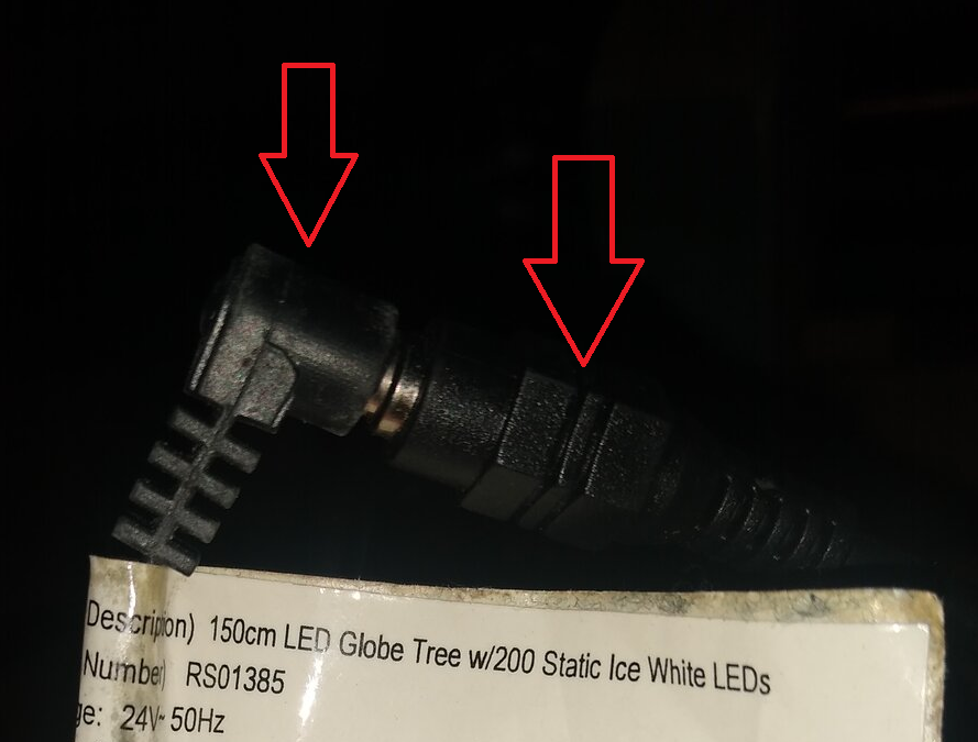

A google search comes up with several variations of a DB 12 24 power supply. 2 are straight forward transformers and one is an electronic sequencer.

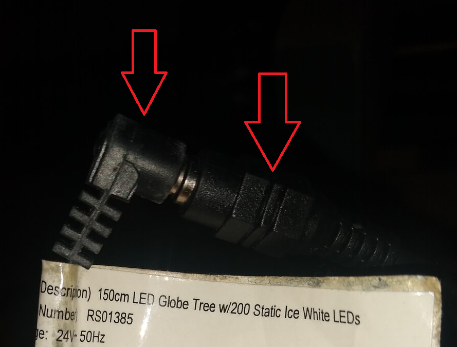

Looking at the pics again I see there is a join:
The arrows point to 2 seperate parts, can we see a wider image to identify what those are please2 you have please.
Is there any form of moving part involved, driven by a motor for example?
Ah the thot plickens...
Looking at the pics again I see there is a join: View attachment 360775
The part to the right is a extender/splitter - It was a easy way to see what size the plug is.
No moving parts.
