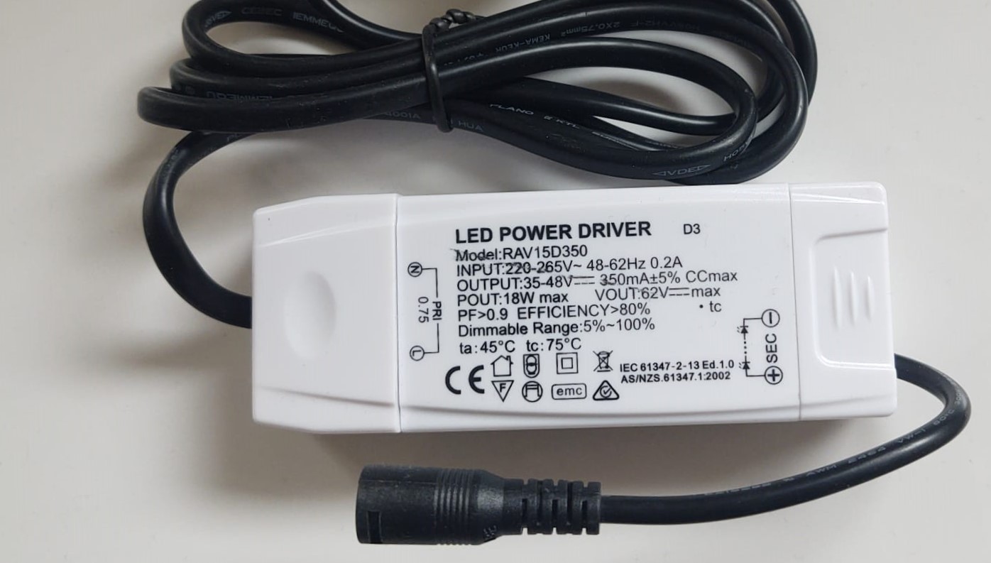

Ericmark,
Thanks for your comments. I've attached a pic of the driver (not transformer as you correctly point out). The same driver is used throughout the house (~30 units) and so far, so good, none have failed in 18-months.
I will substitute test as suggested, and post the result this evening.

Those aren't 12V transformers, they are constant current LED drivers, If you plugged the LEDS in with the power on to the drivers you will have blown the LEDs due to over voltage.

If down lighters are over 4.2 watt then even if a 12 volt lamp plugged into the driver shown it will likely be OK.

It says 35 to 48 volt, that is a long way from 12 volt.

I dont know what I was thinking when I typed the original post - sorry for the misinformation which is very unhelpful.

So, I substituted each driver with a new/unused unit and both DL's are working.
It is likely a driver can be damaged if left on with no lamp connected for an extended time.
The lamps were disconnected for several weeks - to months, and it is very possible the drivers were 'on' in this period. If you don't mind explaining; how does a driver become damaged in this scenario?
The unit should shut down with open or short circuit, but repeatedly testing to see if corrected, I have know over some time this to damage a switch mode power supply.
