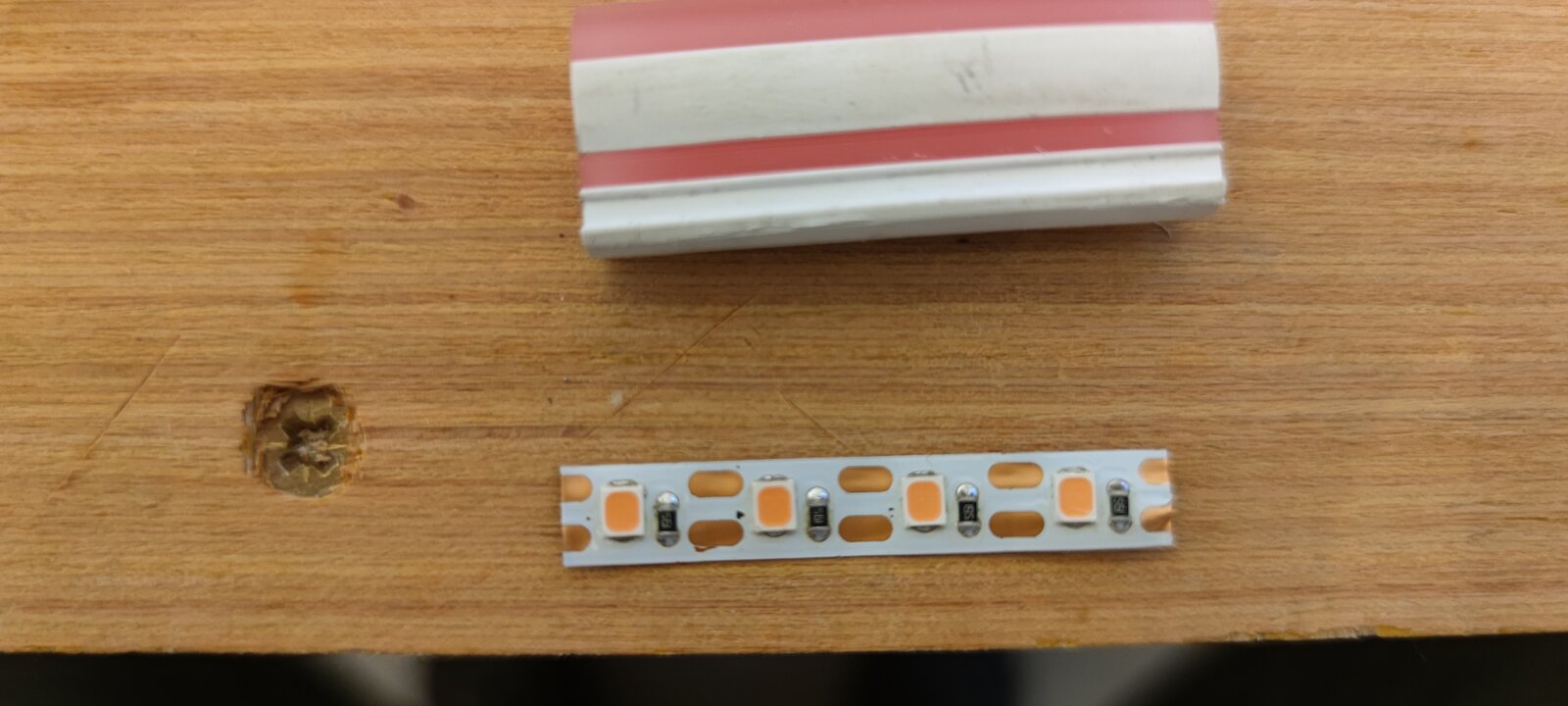

Here is the type of leds inside the neon. Here's a cheeky little one I've just made aswell.
At the moment I have some 18awg stranded wire that came with the LEDs. It's quite thin and not ideal.

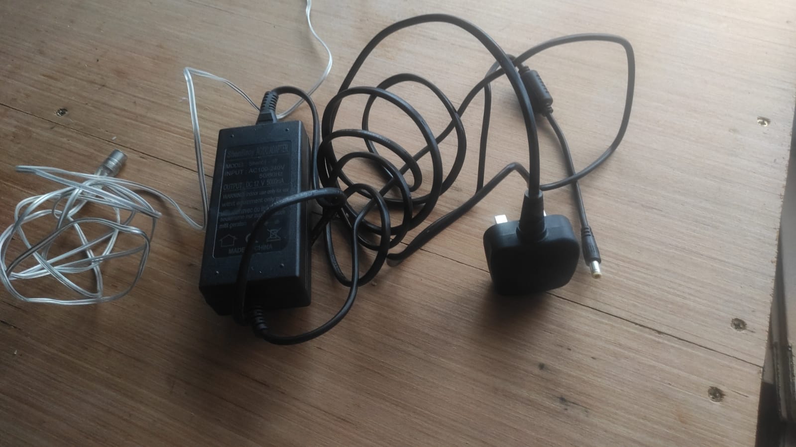

I have bought a pack of female 12 v jack leads to connect to my 12v power pack.
Moving forward i want something better. Looking for a better quality wire to purchase, suitable for when soldering these 12 v LEDs.
Then something suitable for my end piece of wiring, which will be going back to the 12v power pack.

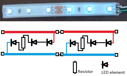

A LED is a current dependent device, some where you need to limit the current, as a pre-assembled unit they normally use resistors, but there is no single method, so much depends on the units you have.
The resistor controls the current through the three LED elements
Some of these strips are too bright for direct viewing when the supply is 12 volts. I have used 9 volts for some installations for this reason.
This is the LEDs I'm working with.

I have bought a sample size of a few different colour led neons and there is no information as such on them. This is the LEDs themselves when taken out of the silicone housing. There is approx 1cm between each set of copper pads.

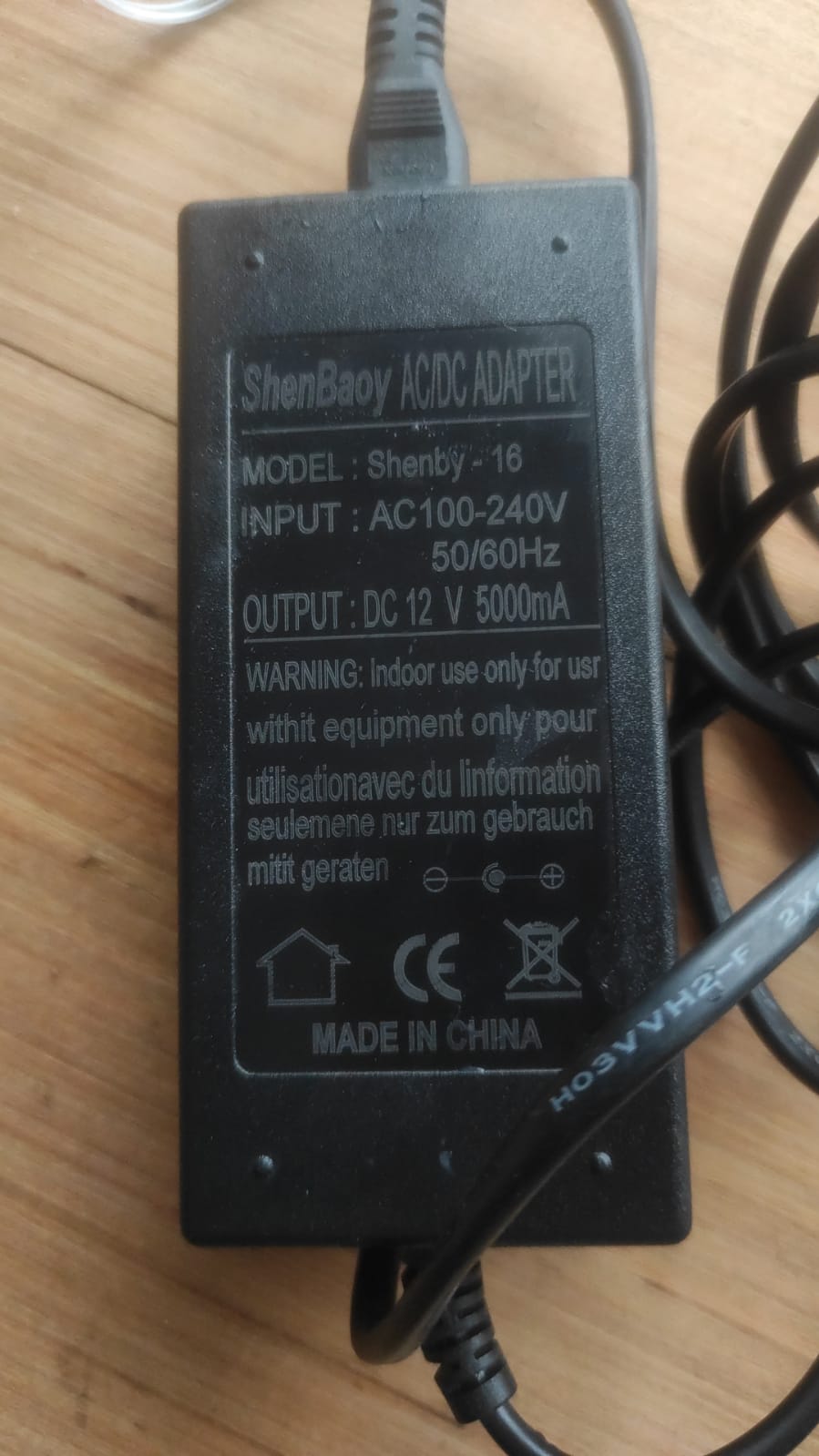

This is the 12v power supply that came with the sample I bought.

Ignoring the fact that it looks like a bit of dubious low quality driver (the language used does not inspire 100% confidence)
Output 12V, 5000mA = Output 12V, 5A, 60W
So good for up to a 5meter length of LED if it is rated at less than 12W per meter.
Note that you can happily use this on shorter lengths of LED, it is just less power efficient.
