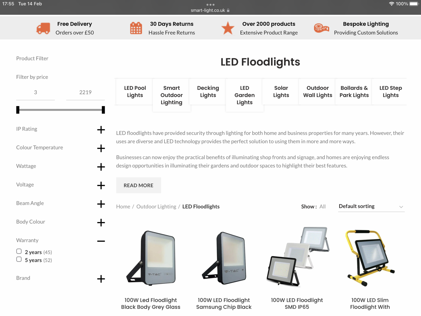

Thanks for your replies. Seems a few of us have found that LED security lights fail unexpectedly early and very few examples (in this thread as yet) of outdoor LED security lamps lasting anything like 15000 hours.
Haven't seen any LED security lights with a 5 year warranty though I'm picking up two 10W ones on Friday that have three year warranties and only coast £9 each.
