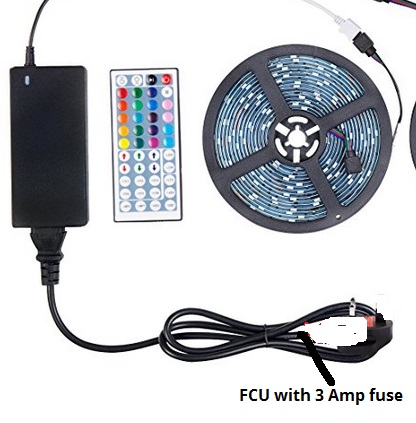

I'll be replacing the existing light fitting with this kit, so, all I do just connect the driver to the existing lighting circuit/lead for this room, and then wire up the strip to the driver?
Thanks for guidance (y)
quoting from the advert
ALL IN ONE KIT(POWER SUPPLY WITH BS CERTIFICATION): Package inluded 2 reels of 16.4ft led lights, AC adaptor, 44key IR remote and receiver box. No other accessories are required.We do not recommend to connected more than 32.8ft as the power adapter will exceed limited, and please unroll them for heat dissipation when testing more than 2 minutes.
and the picture shows a 13 amp plug is included.
She's said she doesn't want it connected via a plug :(
I've had a look up in the loft and there arn't any mains wires showing amongst the joists which is a tad shame as I would have popped a spur off
IF the plug is just a plug and does not contain any electronics then wire it to an Fused Connection Unit

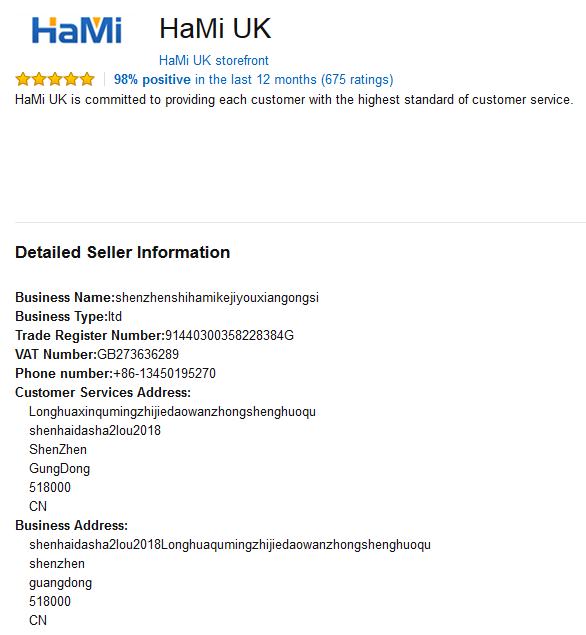

I would seriously advise against that product:
The problem is that Chinese manufacturers, and Chinese sellers, are outside the jurisdiction of the UK/EU, and far too many of them are making and selling dangerous and illegal products, lying about standards compliance, and so on.
Buying from a UK seller, who is importing from China, and who is bound by UK laws, or buying products from companies who have them made in China, but are bound by UK/EU laws, etc, is one thing, but going direct carries too many risks.

Well if you are wiring it into the lighting circuit you won't need a FCU.
Exactly, just connect it to the cable that supplied the switched supply to the old light. (If the plug does contain electronics then put a socket on the cable that used to feed the light.)
