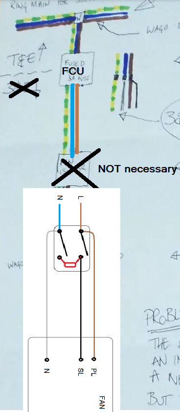

LED switch on extractor fan
Again replying to sureitsoff. The fan clicks on & off itself due to humidity levels (our house is brick & lime built in 1896. It has lime plaster walls too, so it gets quite high humidity levels). It keeps going until it decides to stop, then the timer kicks in & keeps it on for another 15 minutes. This is functioning fine & just as it should. The switch is there in case me or my Mrs wants to put it on for whatever reason. When we switch it off, again the timer will kick in & it will continue to run for a further 15 minutes.
Ah, OK, so the little blue wire on the back of the switch connected to the empty neutral terminals just needs to be linked with the wago connector with the neutral wires. Is that correct, or should I join the neutral wires in the back of the switch rather than in that wago connector? I'd guess both methods would be the same & I'll have to open it up again to see if the LED wire is removeable. When you confirm which is best, or if either of these methods will work I'll give it a go & see if it works. Thank you for your advice.

No Wagos or other connectors needed. Use the switch terminals.

OK guys, I've had a look & it appears the LED wires in the rear of the switch can not be removed from the switch without disasembling the whole switch & I don't wish to break it.
So just tried putting both wago connected neutrals into N1 neutral terminal in the back of the switch & the LED does not illuminate but it operates normally.
Putting neutrals into N1 & N2 on rear of switch, the LED works, but fan only operates on/off (because the neutral for the permanent live has now been hijacked by the switched live).
Tried using a 5 block wago, 1 empty, the 2 neutral cables, 1 in to the box 1 out of the box to the fan & additional 2 neutral cables connected to N1 & N2 on the back of the switch & the circuit tripped.
So I've restored the wiring back where I started.
It appears to me that the neutral is shared by both live wires. There's a permanent live which therefore needs a permanent neutral, so if this neutral is instead routed through the switch, it will only allow the flow of electricity when the switch is in the 'on' position. Hence why it only operates as on/off fan when wired in this configuration.
I'm starting to think that getting this LED to illuminate will be impossible.
i would expect the led to be on the load side terminals ie only lights when the switch is on. if it was connected to the supply side then it would be always on
edit found a pic on the screwfix site and the led looks like it is across L2 and N2 but I cant post it here as its the wrong format

I just looked on the screwfix website. It was the N2 terminal I had used, not N1. I hadn't read the printed text on the back & assumed the terminal on the top was N1, not N2. So, both neutrals were placed into N2 (not N1 as I previously stated) as this is where the small wires were. I have not tried N1 at the bottom as the small wires don't appear to be connected there.

Update. Sorry if this isn't a timely response, but I've been somewhat busy today. So yesterday having tried the various methods listed above, they didn't work in this instance, so I've decided to go with the wiring diagram that EFLIpudence forwarded yesterday. However, I'm not going to do this myself as it'll mean more messing about with it, so I'll ask my electrician to tackle it when I have to call him around next time. I'm not going to call him out just to look at this, but ask him when he's here next time for something or other. I'm shur he'll be able to sort it. No doubt if I show him the diagram he'll know what to do.
