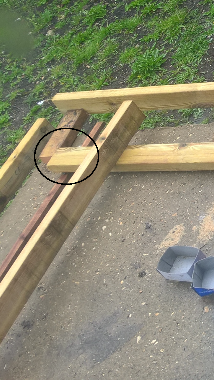

Up until now, I assumed that I can only level using objects that are packed underneath the joist (packers, timber, etc). My current attempt can be seen in this picture:
I think you are suggesting that I screw wooden legs to the joists and adjust the height with this method. Presumably these legs would be screwed to my joist but what would hold them to the ground? A picture would be very helpful if you have one please.
Can I construct these with the current 4x2 timber and presumably they will be required on both side of the joist as I am laying the joists flat i.e. the 4 inch side will be where the decking boards will be screwed.

The 4inch dimension should be the height or the structure will be very weak, you could use post plates to secure to the ground though a large deck will have sufficient weight to not make that essential. Space at 400mm centres to avoid sag of decking board.

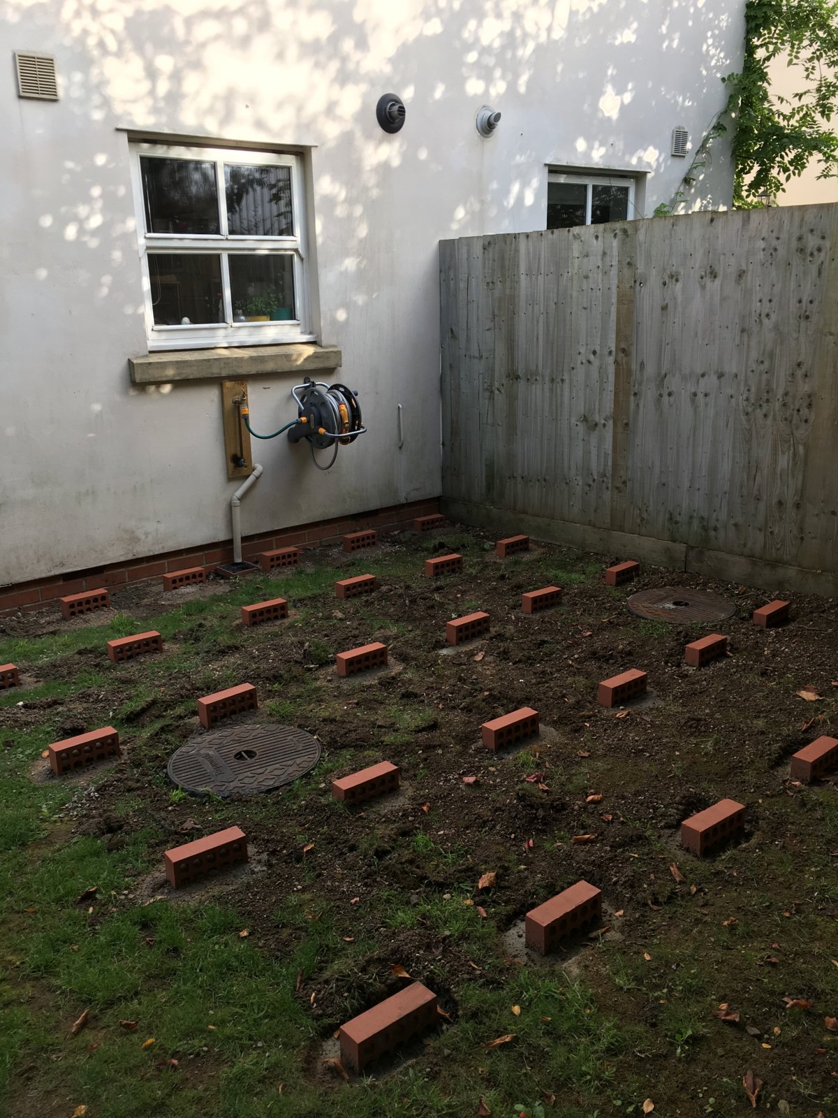

The last deck I built I set engineering bricks into Postcrete beds (with the correct run-off angle) to act as the supports, then laid the deck joist on these (see pics). Probably over-kill but it should last a while!
As you already have a concrete base it might not be possible/practical.
To protect against damp from the ground penetrating the deck I always place a piece of DPC membrane between the leg and the deck joist, it's not fool-proof but it helps.

That looks very nice @Seb101. A brick would take me to high up. That's partly the reason why I am using 3x2's and not 4x2's for the joists. I could double up on the legs if you think that would help?
